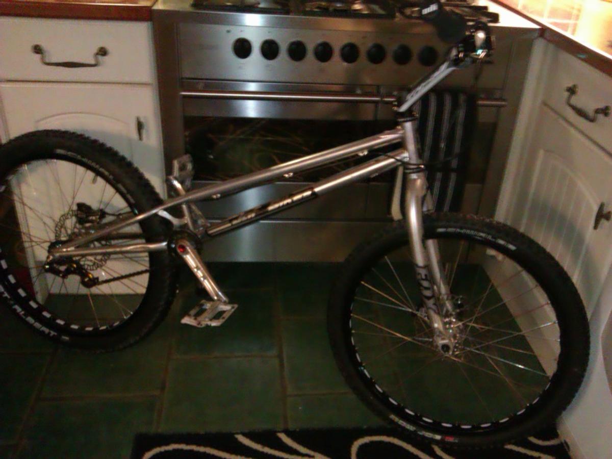

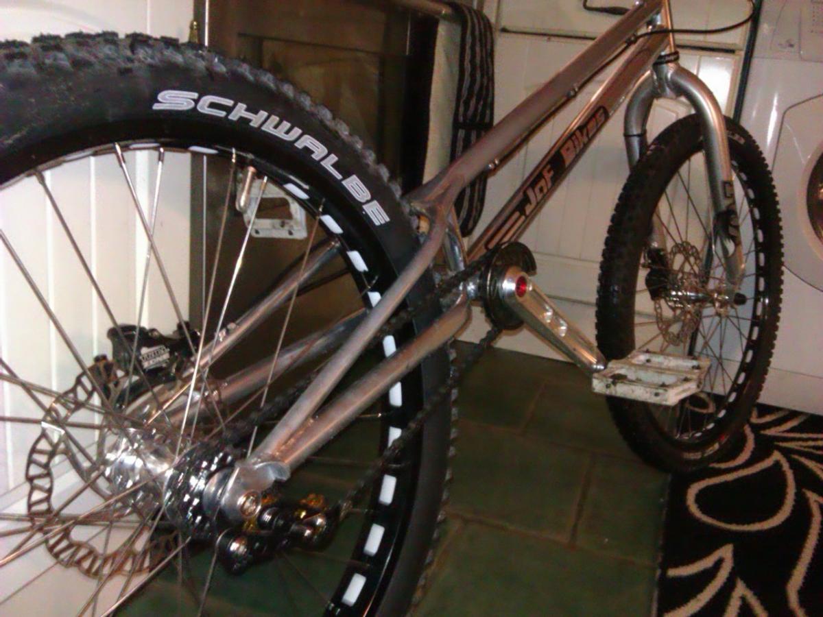

Jake. Posted January 8, 2013 Report Share Posted January 8, 2013 Doesn't seem too bad to ride, you pleased with it? Quote Link to comment Share on other sites More sharing options...
dezmtber Posted January 8, 2013 Author Report Share Posted January 8, 2013 very cant wait to ride it at a comp Quote Link to comment Share on other sites More sharing options...

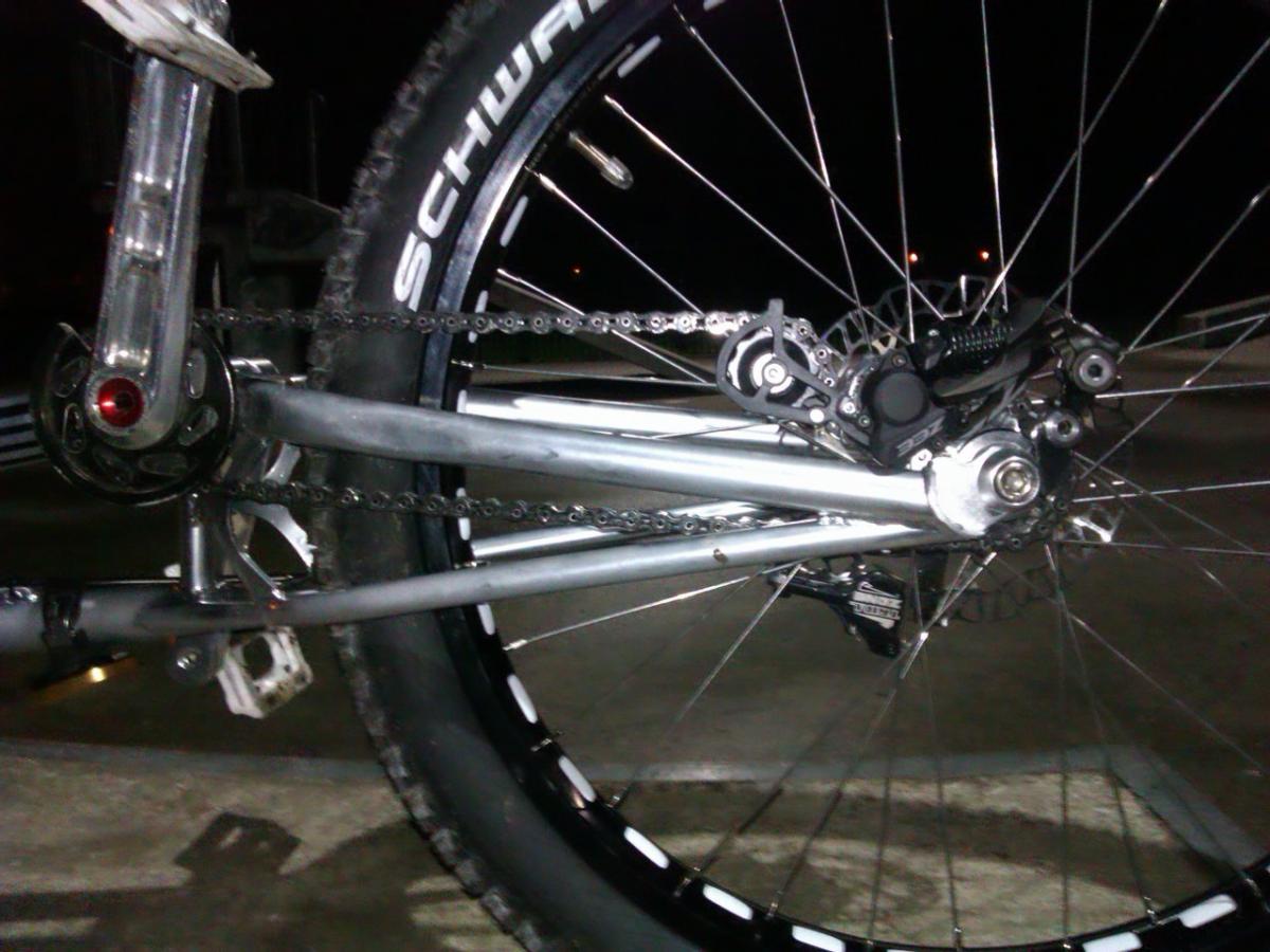

monkeyseemonkeydo Posted January 8, 2013 Report Share Posted January 8, 2013 Interesting crank setup you've ended up with... Quote Link to comment Share on other sites More sharing options...
BradJohnson Posted January 8, 2013 Report Share Posted January 8, 2013 If you don't mind me asking, what did the frame cost you. Quote Link to comment Share on other sites More sharing options...
dezmtber Posted January 8, 2013 Author Report Share Posted January 8, 2013 The frame set me back £340 its cheap really. The paint and metal bending looks a bit medevil but it does the job and looks fine so long as your not an engineer you won't find fault in it. The geo is right everthing fits no problem. I would expect to pay much more around £500-£600 to get the same quality finish i expect. But for £340 I am more than impressed with what i got. I have fitted some echo tr cranks and trial tech 18t cog n bash. And some higher bars with the try all 2013 stem and now it rides better than my rockman 1 Quote Link to comment Share on other sites More sharing options...

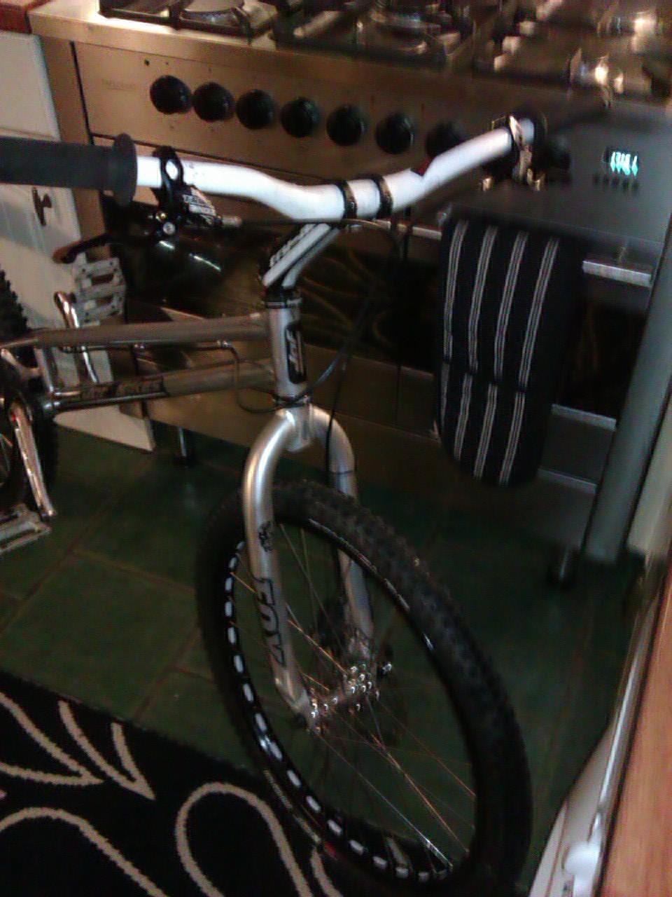

Jake. Posted January 8, 2013 Report Share Posted January 8, 2013 Pictures of the new setup? Quote Link to comment Share on other sites More sharing options...
dezmtber Posted January 8, 2013 Author Report Share Posted January 8, 2013 New cranks and bar n stem Quote Link to comment Share on other sites More sharing options...

dngr2self Posted January 8, 2013 Report Share Posted January 8, 2013 That bb height's a bit like ladyboy sex, at first I thought I thought NO WAY! but the more I look at it the more I think it could be interesting to try. 6 Quote Link to comment Share on other sites More sharing options...
dezmtber Posted January 8, 2013 Author Report Share Posted January 8, 2013 My mate rides a echo 2013 24 and a onza zoot he said it feels more like his zoot than the echo. But having riden my rockman he said its closest to riding the 20" rockman. I know confusing Quote Link to comment Share on other sites More sharing options...

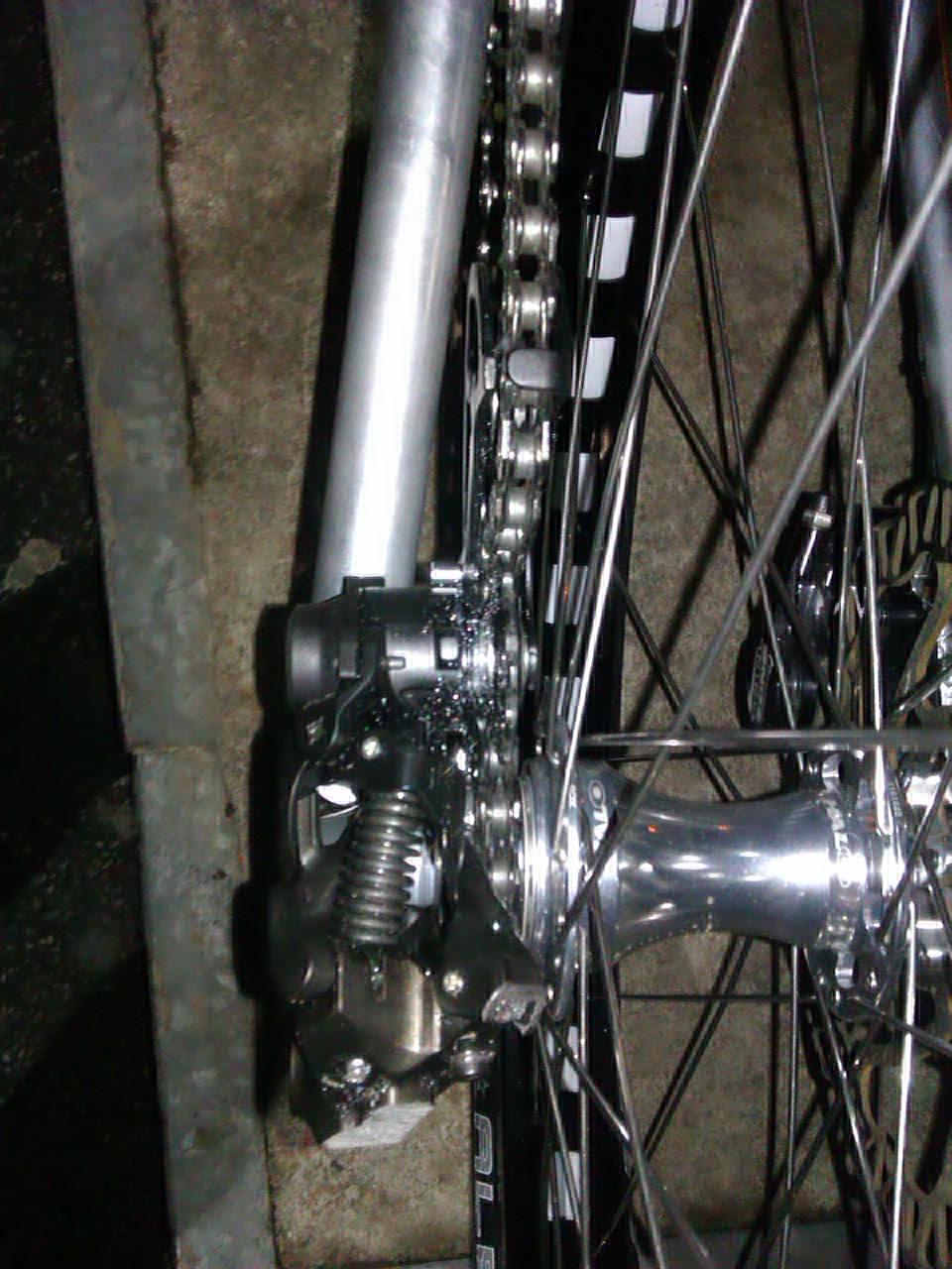

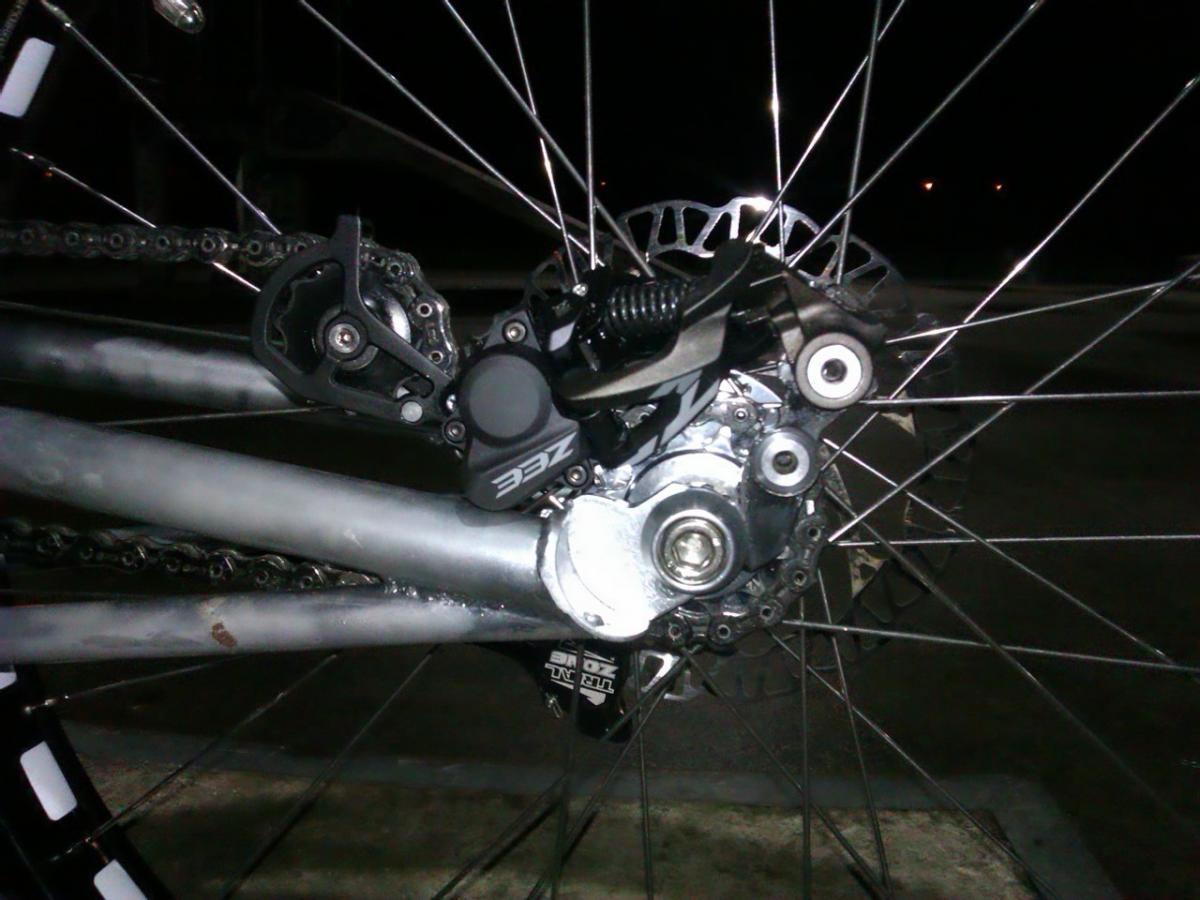

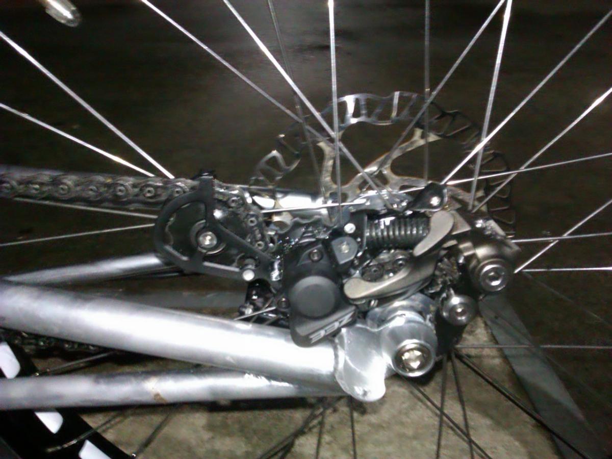

dezmtber Posted January 9, 2013 Author Report Share Posted January 9, 2013 I didnt like the tensile tensioner much it was a faf changing between cogs. So I fitted a zee mech with some changes to it works ace and has a shimano clutch helps keep the tension Quote Link to comment Share on other sites More sharing options...
Jake. Posted January 9, 2013 Report Share Posted January 9, 2013 I still don't understand why you just didn't get a ffw. Quote Link to comment Share on other sites More sharing options...
SamKidney Posted January 9, 2013 Report Share Posted January 9, 2013 Makes no difference now, he has to run a sprung/fixed tensioner either way. And its his preference. Not 100% my cup of tea, but I'd like to see how it rides. So long as your happy with it 1 Quote Link to comment Share on other sites More sharing options...
ghostrider88 Posted January 9, 2013 Report Share Posted January 9, 2013 I still don't understand why you just didn't get a ffw. With those cranks, neither do I. Quote Link to comment Share on other sites More sharing options...
dezmtber Posted January 9, 2013 Author Report Share Posted January 9, 2013 Honestly I wish I had now. It's cool to have the two gear options I can use 18x 14 for street stuff and 18 x 15 for comp style stuff and can change it at any time. But I now remember how much of a ball ache tensioners are there just sooo gay. And annoying. If jaf is reading out of intrest could the dropouts be changed if i can't put up with them? Quote Link to comment Share on other sites More sharing options...
BradJohnson Posted January 9, 2013 Report Share Posted January 9, 2013 Those drop out do look a bit of a let down like. Could have horizontals, get rid of the tensioner Go ffw and you'd shave loads of weight, but I guess if you cared about weight you wouldn't of got a steel frame. Tryed to word that without sounding a dick, sorry if I do sound like a bell end. Quote Link to comment Share on other sites More sharing options...
aener Posted January 10, 2013 Report Share Posted January 10, 2013 I still don't understand why you just didn't get a ffw. Fixed rear hubs with space for more than one sprocket are pretty damned rare these days. Quote Link to comment Share on other sites More sharing options...
Rob Leech Posted January 10, 2013 Report Share Posted January 10, 2013 Honestly I wish I had now. It's cool to have the two gear options I can use 18x 14 for street stuff and 18 x 15 for comp style stuff and can change it at any time. But I now remember how much of a ball ache tensioners are there just sooo gay. And annoying. If jaf is reading out of intrest could the dropouts be changed if i can't put up with them? Yes Just pop me an e-mail if it gets to that stage buddy . Cheers, Josh. Quote Link to comment Share on other sites More sharing options...
