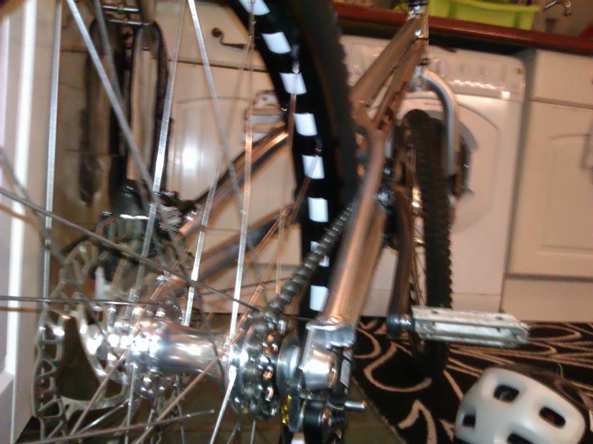

dezmtber Posted January 5, 2013 Author Report Share Posted January 5, 2013 It simmilar to the djd hub but with 6 pawls rather than 3 huge ones Quote Link to comment Share on other sites More sharing options...

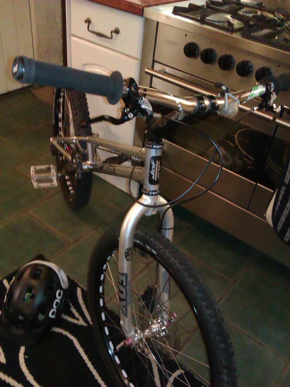

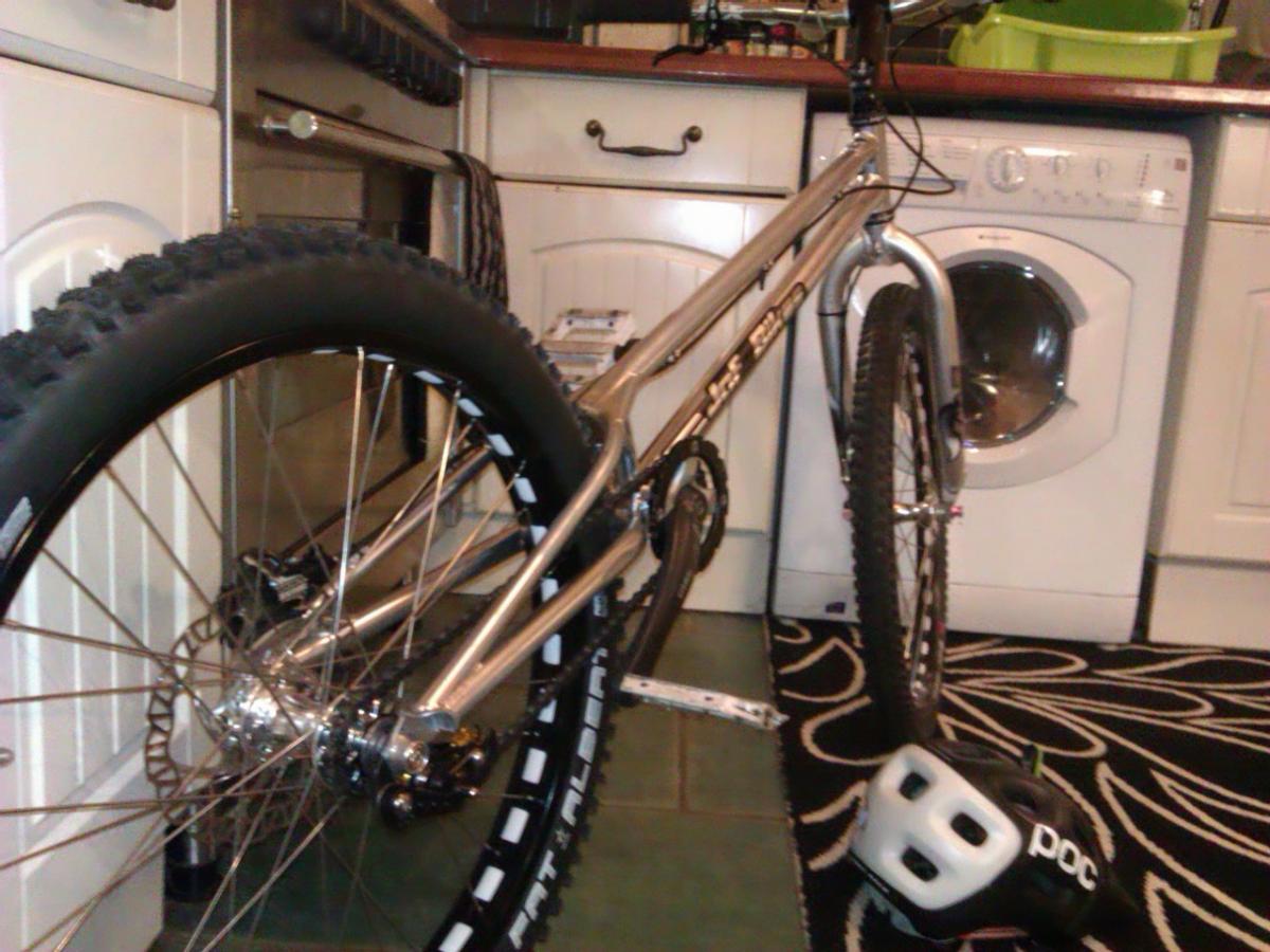

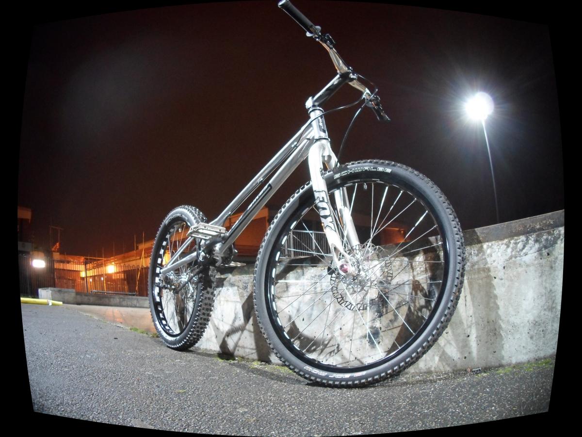

dezmtber Posted January 7, 2013 Author Report Share Posted January 7, 2013 It is here rides kind of strange but i like the way it rides. I have had to fit some foul cranks to it for this week as it requires the widest crank known to man. I am currently running octalink 121x73 with spacers to get the width and it still needs at least I think a 127 x 68 with something like truvative husselfelt cranks. Any one know of some other super wide options. 1 Quote Link to comment Share on other sites More sharing options...
Rob Leech Posted January 7, 2013 Report Share Posted January 7, 2013 Looks pretty tasty buddy! You'll be fine with a 128mm bb . I think the graphics change was a good plan btw, fits in well with your set up . Hope you enjoy it chap, Josh. Quote Link to comment Share on other sites More sharing options...
Danny00135 Posted January 7, 2013 Report Share Posted January 7, 2013 (edited) I was very looking forward to seeing this built up.. don't like the flappy bits on the grips though :/ EDIT: "Very looking forward" I can't even speak proper England.... Edited January 7, 2013 by Danny00135 Quote Link to comment Share on other sites More sharing options...
dannytrialskid Posted January 7, 2013 Report Share Posted January 7, 2013 Looks sweet. I like those graphics! Quote Link to comment Share on other sites More sharing options...
p_ruskin Posted January 7, 2013 Report Share Posted January 7, 2013 please change your grips, or at least cut them down the bike looks sweet, but a little strange because of the bb height. nice work josh! Quote Link to comment Share on other sites More sharing options...
craigjames Posted January 7, 2013 Report Share Posted January 7, 2013 Are the cranks hitting your slaves? Mtb cranks aren't known for having a large offset. Get some proper trials cranks a 128/127mm bb and you should be ok. Quote Link to comment Share on other sites More sharing options...
Danny00135 Posted January 7, 2013 Report Share Posted January 7, 2013 Are the cranks hitting your slaves? Take another look at the pictures... Quote Link to comment Share on other sites More sharing options...
LEON Posted January 7, 2013 Report Share Posted January 7, 2013 Are the cranks hitting your slaves? Mtb cranks aren't known for having a large offset. Get some proper trials cranks a 128/127mm bb and you should be ok. Quote Link to comment Share on other sites More sharing options...
Danny00135 Posted January 7, 2013 Report Share Posted January 7, 2013 I like your oven.... 1 Quote Link to comment Share on other sites More sharing options...
CalopS Posted January 7, 2013 Report Share Posted January 7, 2013 Get some better pictures when you sort out your bb problems. Quote Link to comment Share on other sites More sharing options...
Danny00135 Posted January 7, 2013 Report Share Posted January 7, 2013 Get some better pictures when you sort out your bb problems. The height of it cant be changed i'm afraid 2 Quote Link to comment Share on other sites More sharing options...

dezmtber Posted January 7, 2013 Author Report Share Posted January 7, 2013 I have tryed my onza comp cranks with try all 122.5 bb they wouldn't go past the chainstays just pushed onto the splines. I am going to try a set of zoot cranks tmz. Riding leek tmz around 2pm till 4pm Quote Link to comment Share on other sites More sharing options...
aener Posted January 7, 2013 Report Share Posted January 7, 2013 (edited) I have tryed my onza comp cranks with try all 122.5 bb they wouldn't go past the chainstays just pushed onto the splines. I am going to try a set of zoot cranks tmz. Riding leek tmz around 2pm till 4pm You might still have problems. Do yourself a favour and get a 127/127.5/128mm BB Edit: Forgot to say - build looks swish! Would be nice if you could get some better quality photo's when you've got the crank issues sorted. Chrome hub looks sweet - I hope it works well and you don't have to change it. Edited January 7, 2013 by aener Quote Link to comment Share on other sites More sharing options...
dezmtber Posted January 7, 2013 Author Report Share Posted January 7, 2013 So far its worked fine. But I haven't put any real harsh pedaling through it because when the frame flexes the crank catches the stays. I will try the 128 bb with the cranks tmz Quote Link to comment Share on other sites More sharing options...

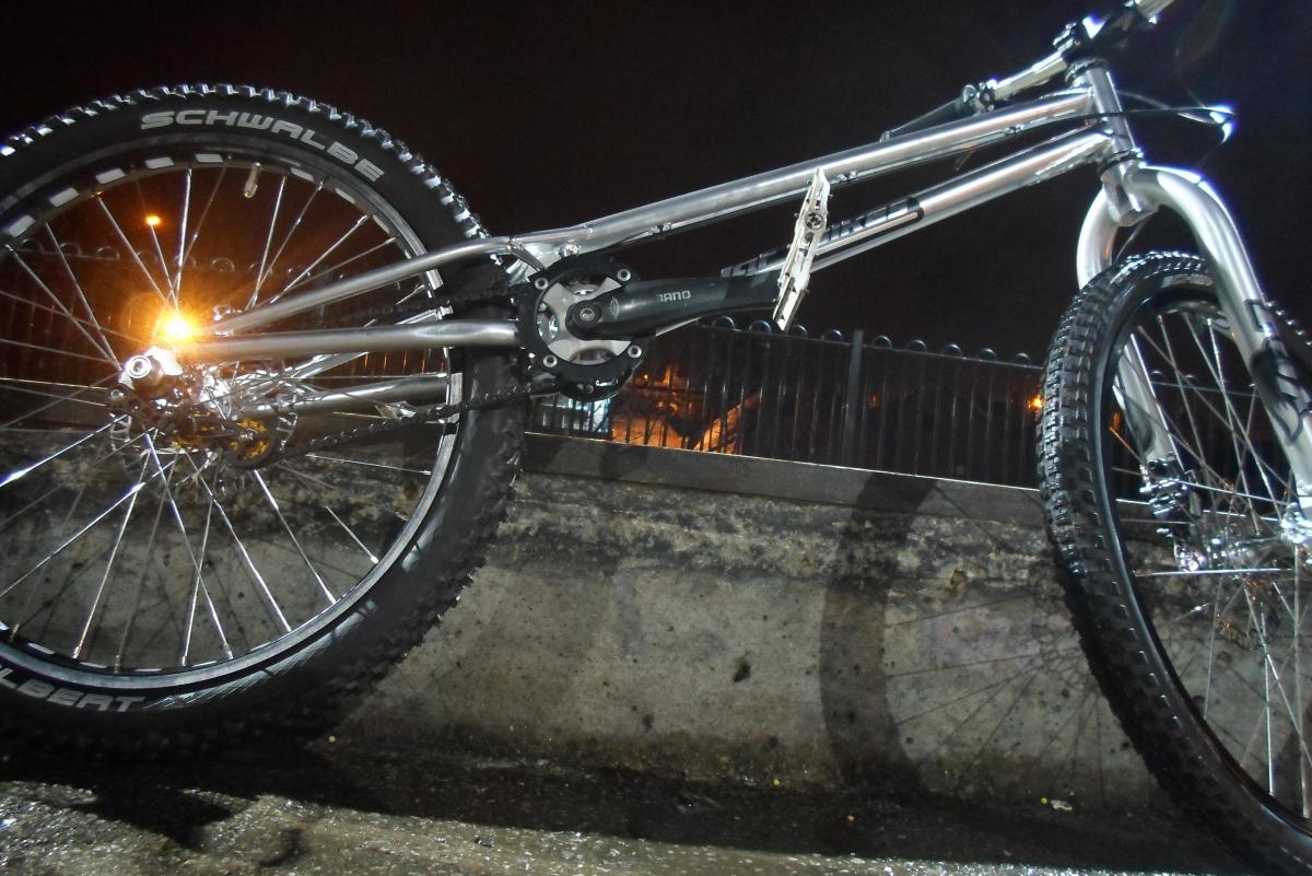

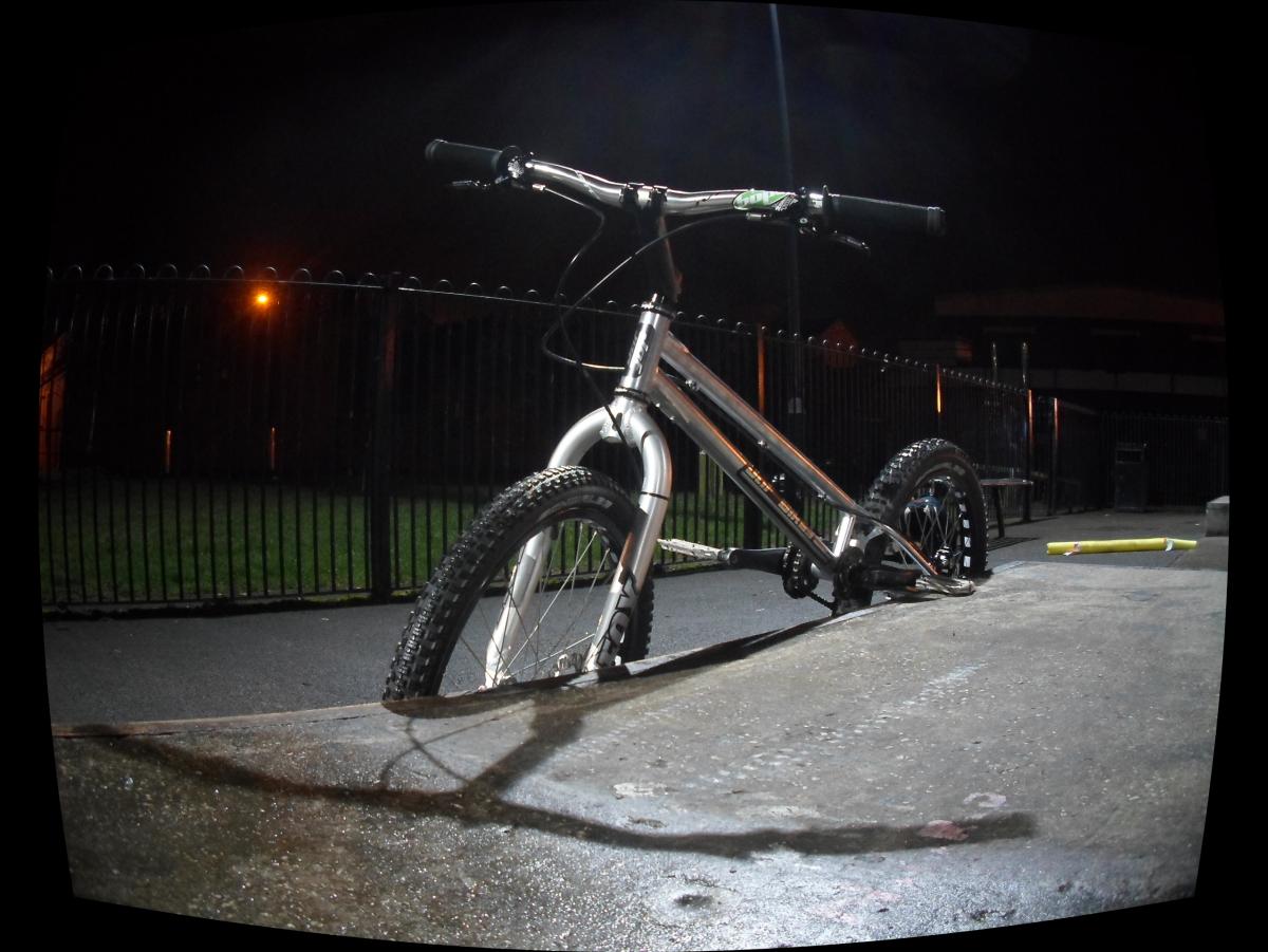

dezmtber Posted January 8, 2013 Author Report Share Posted January 8, 2013 few pics from last night Quote Link to comment Share on other sites More sharing options...
Jake. Posted January 8, 2013 Report Share Posted January 8, 2013 Why do your pictures have like the old tv bubble effect? Also, get a video of you riding! Even if it's 10 seconds long, I'm curious to see what it's like on the back wheel. Quote Link to comment Share on other sites More sharing options...
dezmtber Posted January 8, 2013 Author Report Share Posted January 8, 2013 its my cameras crap fisheye effect i forgot to switch it off. 1 Quote Link to comment Share on other sites More sharing options...
