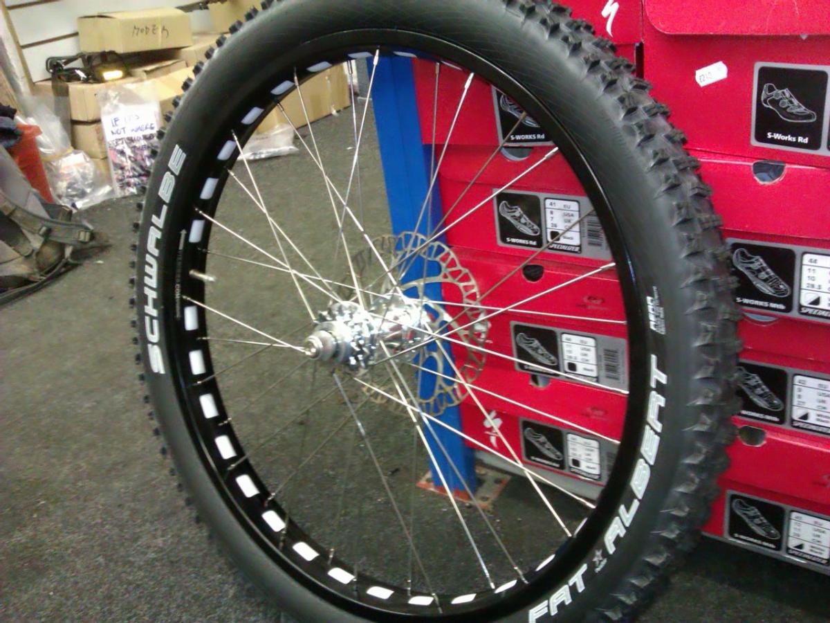

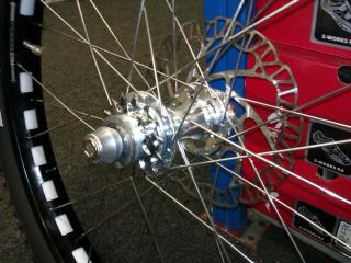

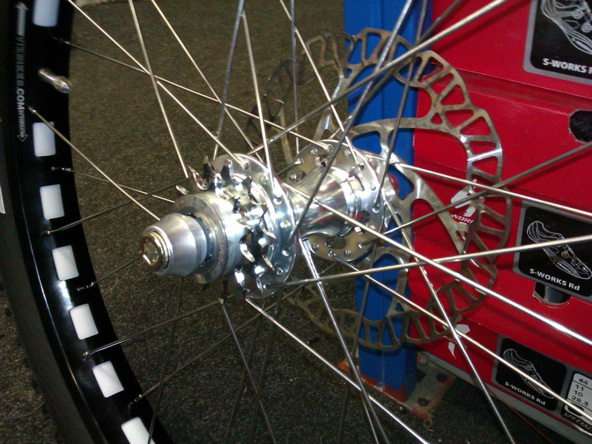

I probbaly put the wrong hub. It's the halo singlespeed hub same as the hope trial hub. Just different pawl setup. Taking a but of a risk trying it out for trials I just like the 6 pawl system it looks much like the insides of my tensile freewheel.
I already had the shimano cranks I will probably get something stronger when they break.

Thank god those aren't maggie mounts, or you'd have a tough time tightening the rear bolts.
Not to mention running a chain ;)
I thought the same as everyone else even though I saw it in the flesh just the other day, and it didn't have them on :P Thought it might've been an afterthough until I thought about just how impossible to run they would be. Haha. Freaky photo angle is freaky!

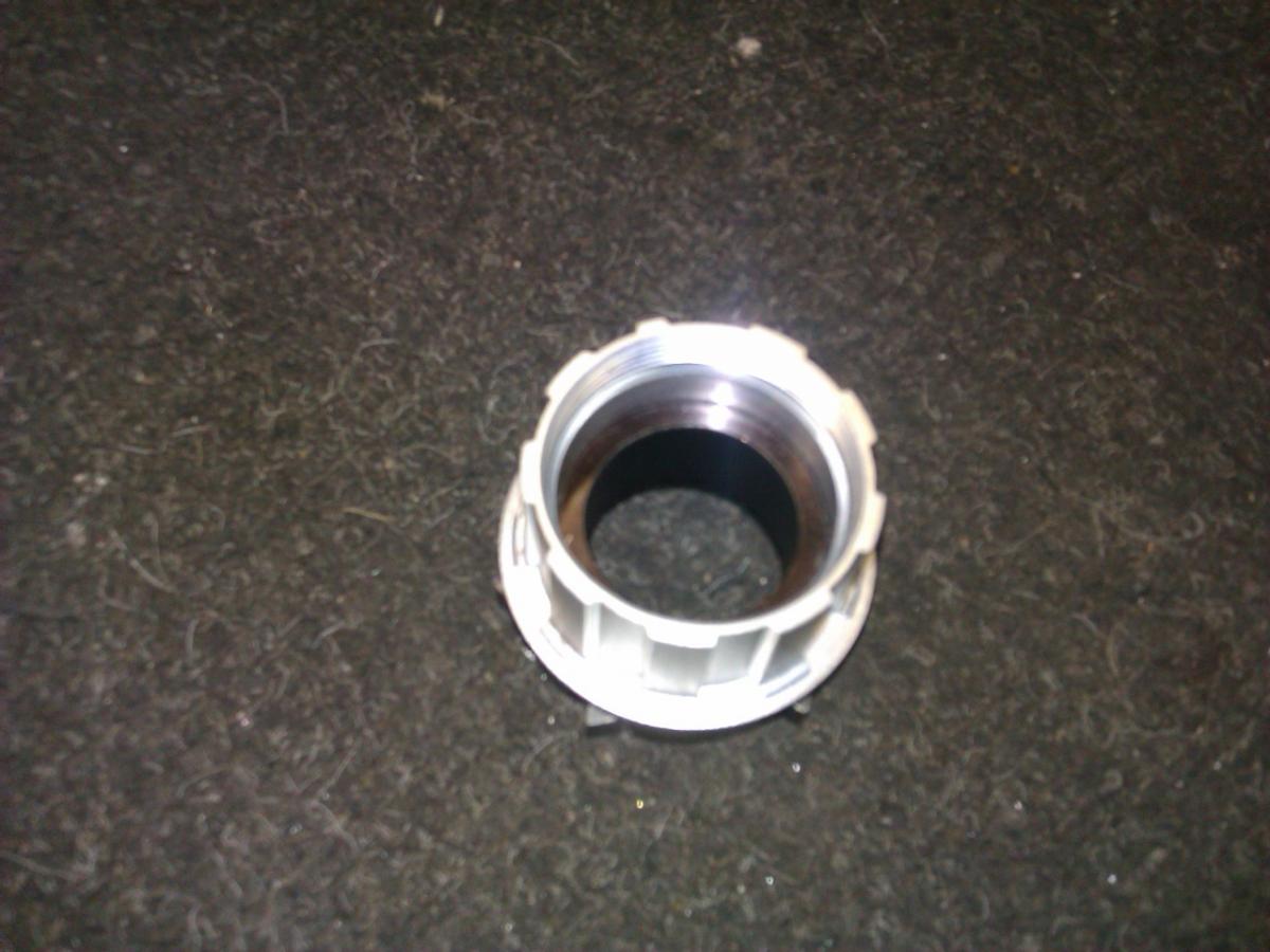

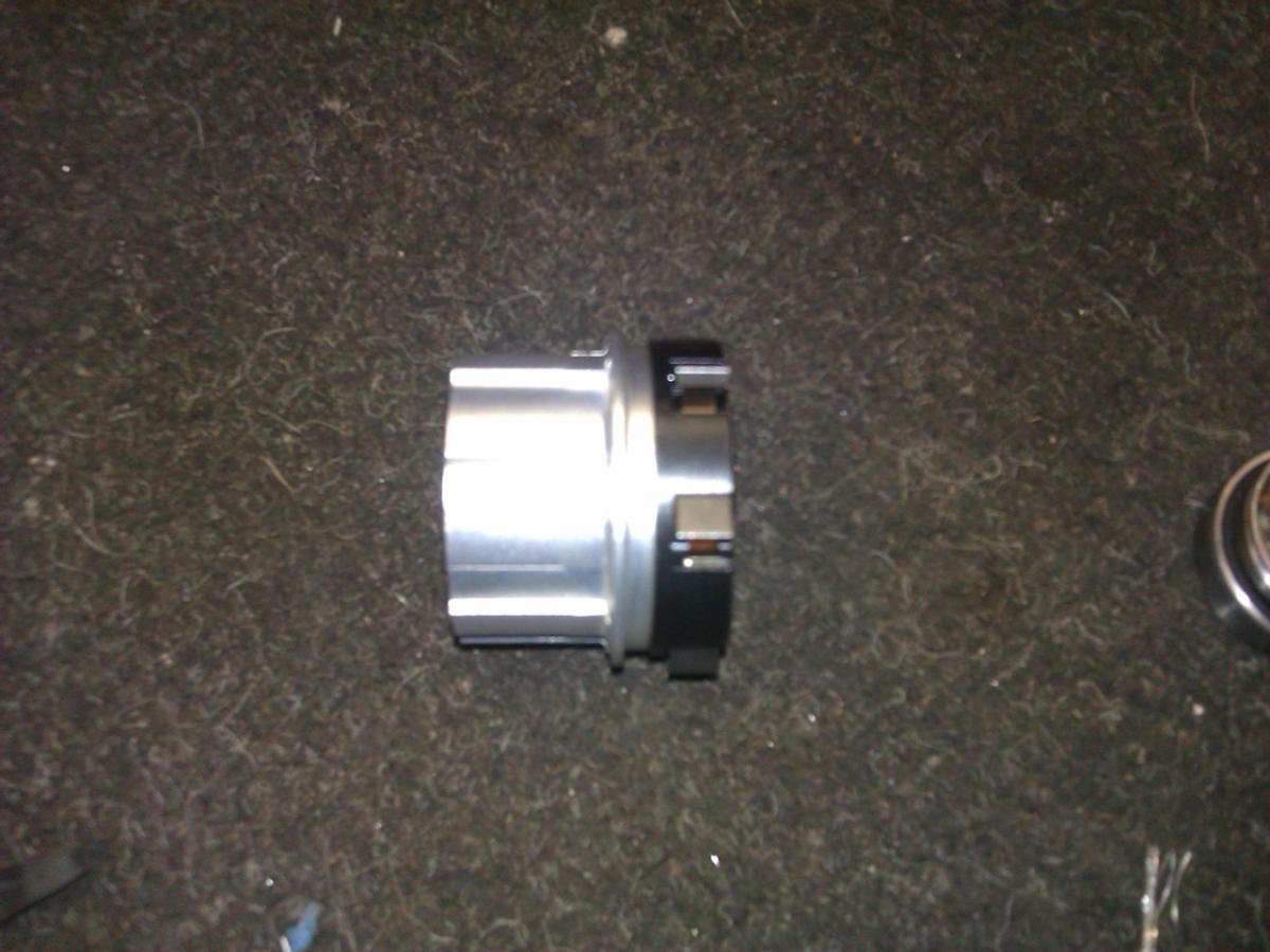

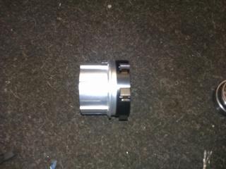

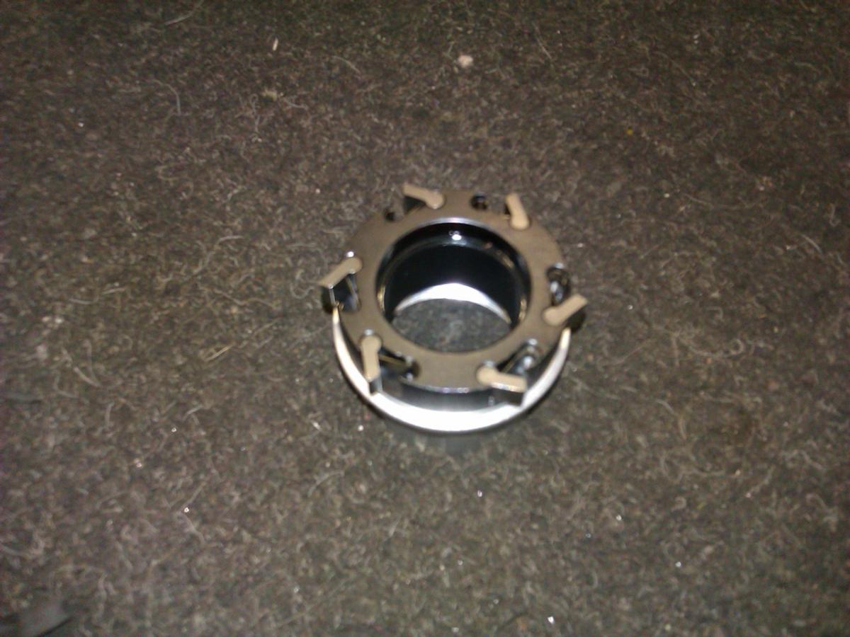

After a good look into this freehub.
The pawls sit in a steel holder which is threaded to the alloy cog carrier.
I am not keen on the fact its threaded alloy to steel. So long as I don't wreck those threads it will be ok.
But I tryed the hope freehub body on the halo and it fits so I will bodge one of those on if the halo fails. And if that then fails hope all the way.

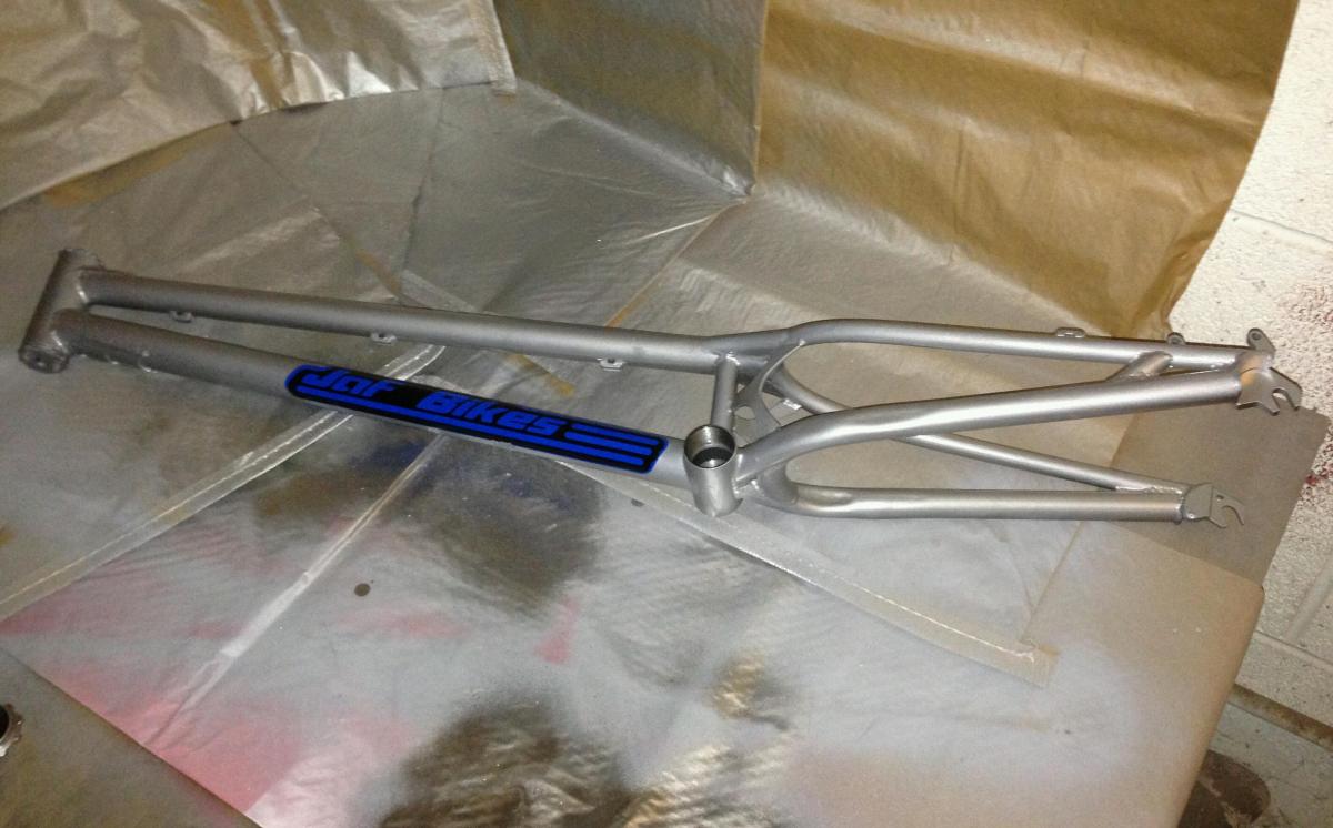

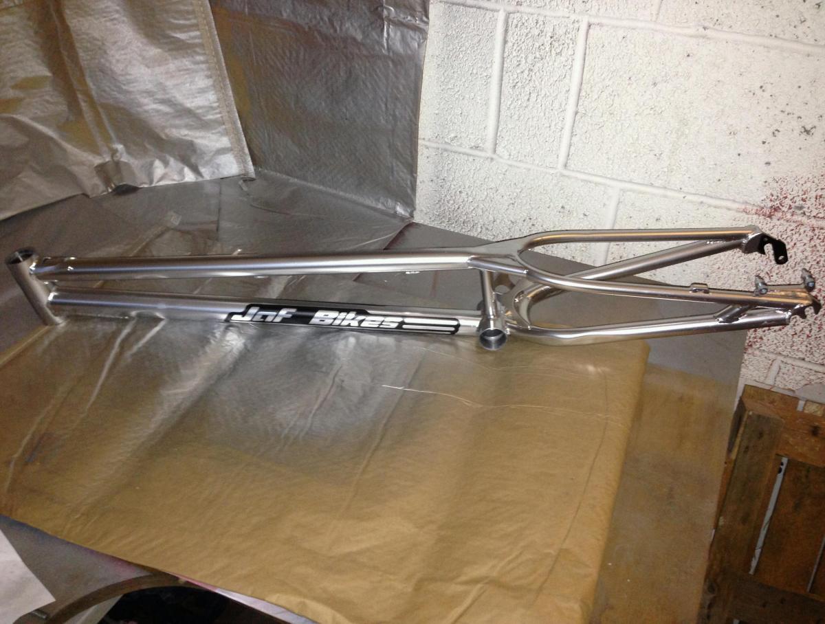

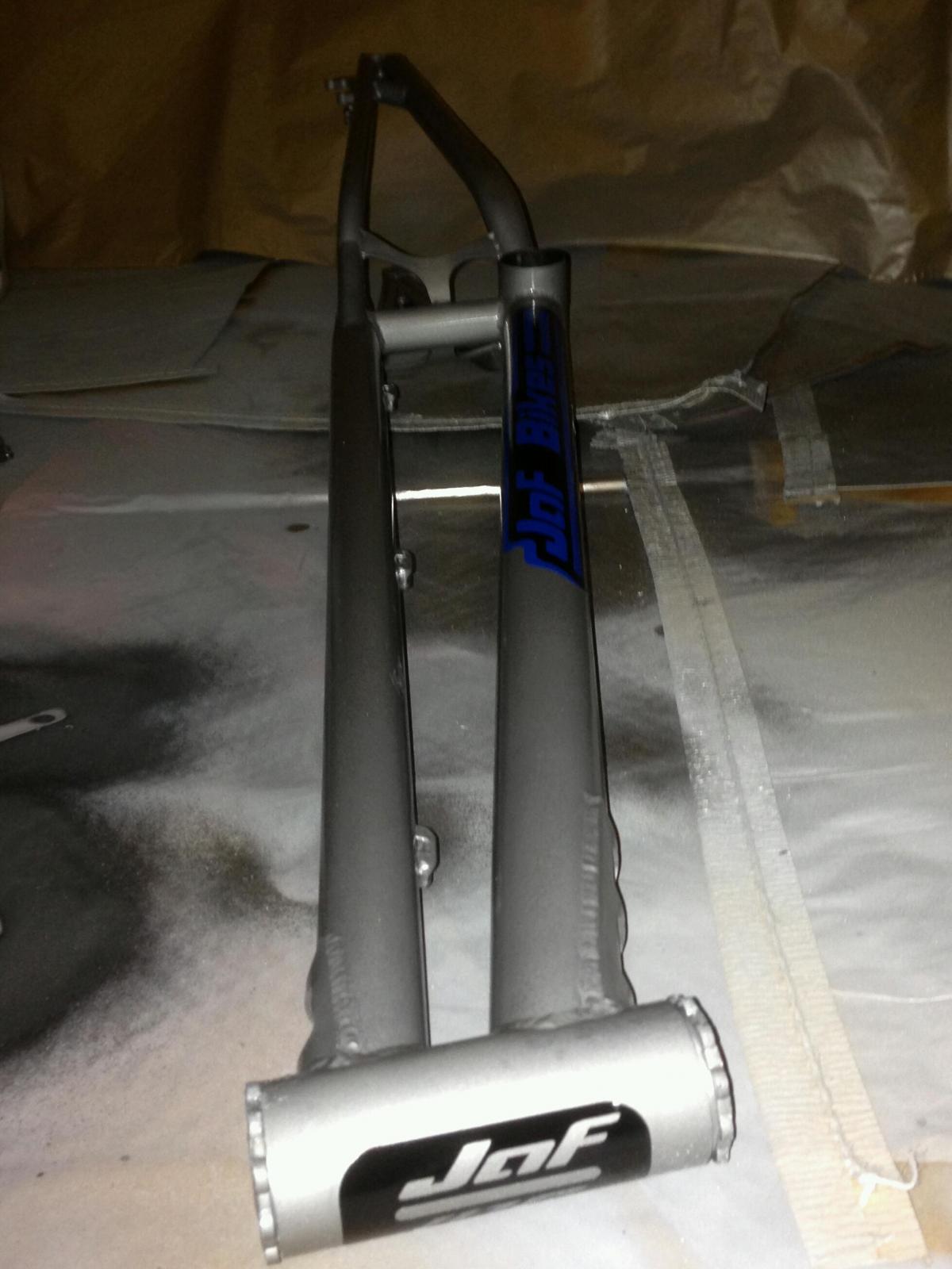

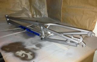

Jafs finished the frame its in the post.
post-4951-0-99632100-1357329723_thumb.jp
post-4951-0-78309400-1357329737_thumb.jp
post-4951-0-04629300-1357329751_thumb.jp
post-4951-0-66332400-1357329766_thumb.jp
You'd be miles better off with a Hope xc.
Seems a waste to have a nice new frame & stuff, then top it off with a piece of shit carrying every pedal stroke.
I looked at them once, then I looked away.
Are the JAF graphics created in house Josh, or are they made at a specialist? Frame looks great good job!
Yep, all in house. It's just easier that way with people wanting different things :).
whens it gonna be built?
It will be with him sometime tomorrow, so keep an eye out, I'm sure he is ;).
