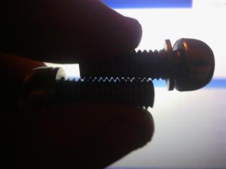

trials hoe Posted December 25, 2012 Report Share Posted December 25, 2012 (edited) you can check to see if the pitch is the same (not mega accurate) by holding one of each of the bolts like in the attached pic, if the threads are different they wont sit together like the one below. hold them in front of light to make it easier to see the outlines of the threads. Edited December 25, 2012 by trials hoe 1 Quote Link to comment Share on other sites More sharing options...
Trials-Mikey Posted December 26, 2012 Author Report Share Posted December 26, 2012 (edited) <blockquote class='ipsBlockquote'data-author="trials hoe" data-cid="2475043" data-time="1356473054"><p><br /> you can check to see if the pitch is the same (not mega accurate) by holding one of each of the bolts like in the attached pic, if the threads are different they wont sit together like the one below. hold them in front of light to make it easier to see the outlines of the threads.<br /><br /> <br /><br /> <a href='<a href='http://www.trials-forum.co.uk/index.php?app=core&module=attach§ion=attach&attach_rel_module=post&attach_id=58387'>http://www.trials-forum.co.uk/index.php?app=core&module=attach§ion=attach&attach_rel_module=post&attach_id=58387</a>'>IMG_20121225_215643.jpg</a></p></blockquote> Thanks' this worked the pitch is the same they fit into each other Edited December 26, 2012 by Trials-Mikey Quote Link to comment Share on other sites More sharing options...
