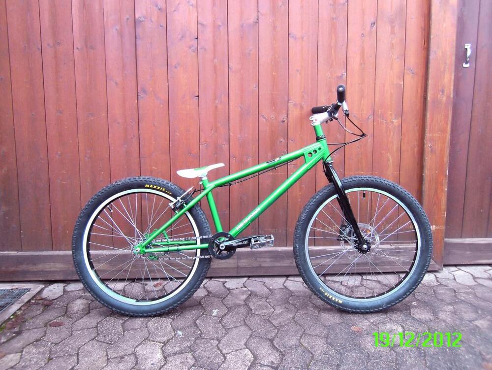

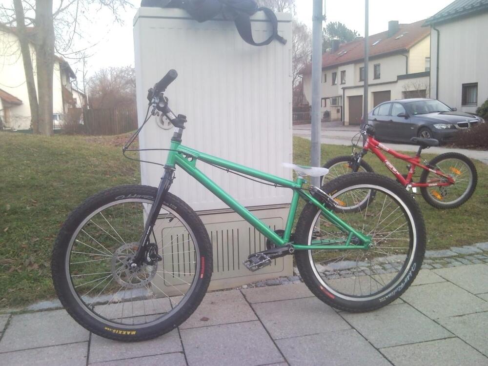

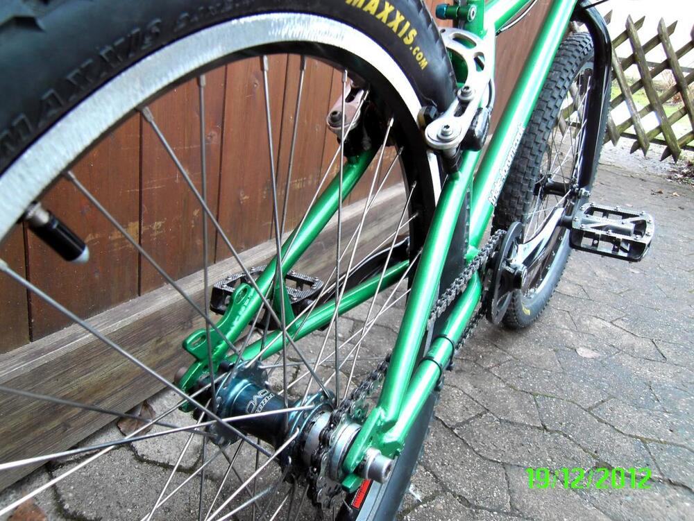

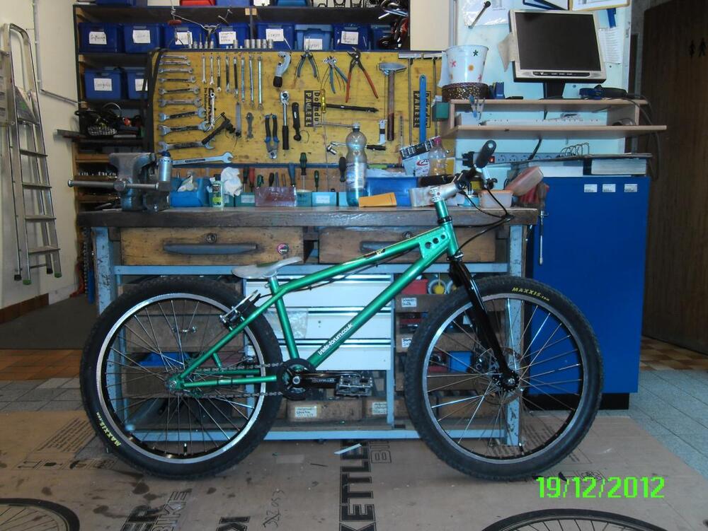

sooo,i am pretty happy with this,therefore i decided to make a new thread about it.
as you can see clearly i rawed and painted my marino street rig.
after failing hard with applying a "crystal fx" structure on the whole frame because of the tubes shapes(that liquid was dripping to the floor without noticeable effect,except on the floor itself :wink: )
i decided to go over the green base coat with some of the pearl blue i wanted to do the crystal effect with,before applying a 2k laquer.
that had it come out as some kind of flipflop effect,wich is cool in its own way.
the first pic shows the bike nearly in another colour as the second,in real live it changes colour as you walk around the bike.
comments welcome!

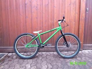

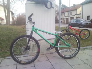

i didnt say its going from green to purple or something,its more like a blueish effect mixing in depending on the angle the light is hitting it with.
the pics dont tell it reallypost-30389-0-97035900-1355923094_thumb.j
heres a pic i shot in my workshop 2 minutes before the other,the flash got it coming out a bit.

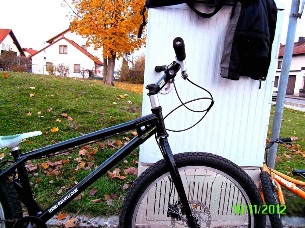

its my old one,just refreshed it beeing bored of waiting for the new one,just saying.
bars are great,upsweep is adjustable that way,good for me as my wrists are damaged.
had a tryall 105x35° on it,probably changing back to it as i have problems getting used to that setup(wich i had before,too)
the main prob is the 100mm headtube,i have!!! to run that stacker...
snail cams?should i?nah!
Edited by FamilyBiker
bb is around +15,headtube at 100 mm,forks 400mm.
for an inspired skye(similar geo except ht and cs)with 120 ht,410(?)forks and so on i´m loosing around 30mm in height.
the syntace bars are at 46mm rise WITH CLAMPS,and highrisers a´la inspired 80mm,another 30mm lost...
skye in stock config has 20mm stackers...
just wanted to compensate that a bit.
maybe will go for this setup:
tryall 105x35°,30mm spacers,adaptor to vro(selfmade),like in the last pic but -20 spacers
stemchart says its like 90x10,20mm spacers,highrisers.
thoughts over thoughts... :wink:
