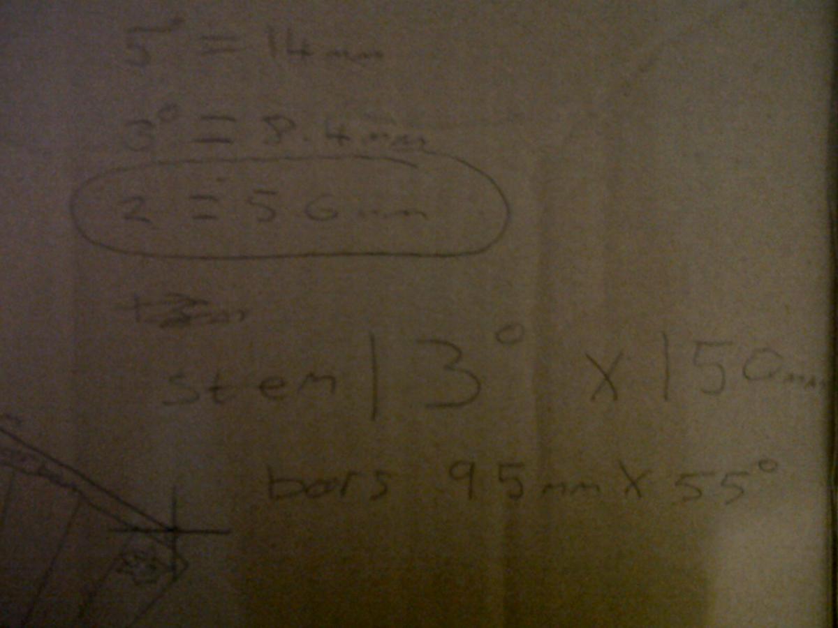

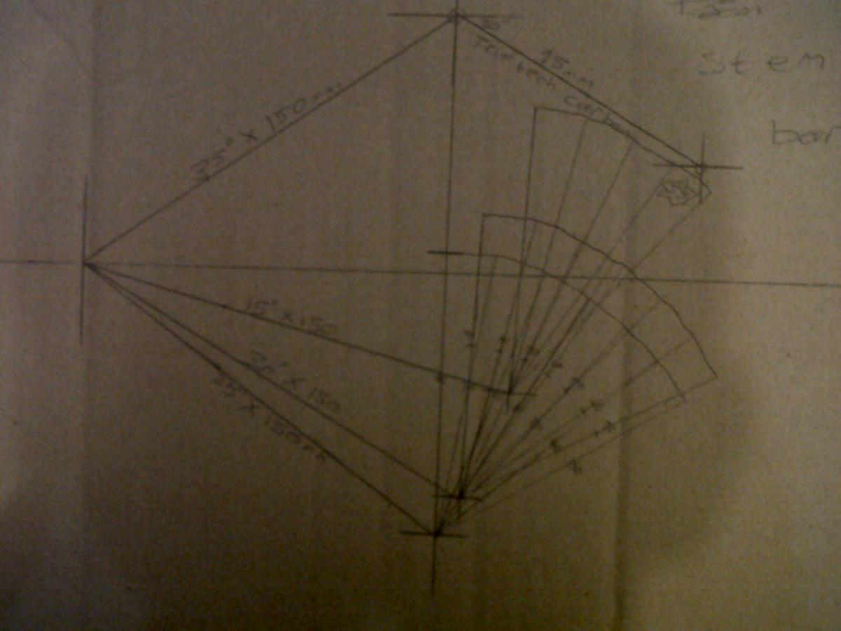

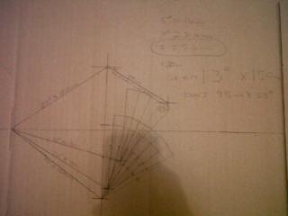

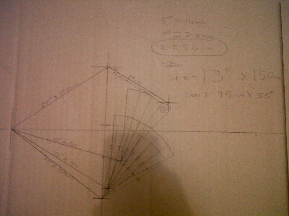

I guess i'm just sort of putting this out there as such.. or finding if one or something close to this geometry is made.
After trying the proper carthy bar angle last night and almost breaking my wrists because of the geometry of the bars i went to find out what geo stem you would need to have your bars at a normal angle but in the same place..
So after doing the this (picture below) i found (if running the trial tech carbon bars like me) you'd need to run a 150mmX13deg stem but upside down.
Is there anything like that out there at the moment? if you could run your bars normal again would it have benefits?
Yes my workings out arn't neat.
post-22746-0-05789400-1354033550_thumb.j
post-22746-0-77404400-1354033563_thumb.j
post-22746-0-84774800-1354033604_thumb.j

Did you take into account the head tube angle? I think it also affects this although I'm not sure what you're essentially trying to prove.
No i haven't. It shouldn't make too much difference though, all the angles and positions etc are still the same when tilted back/forward if you see what i mean.

His bars would be at a "normal" angle, with a comfortable amount of upsweep and backsweep. The stem in question puts the bars at a level relative to what they would be with a conventional stem and the carthy style angle, so in theory, you could have the handling characteristics of the carthy angle, without a silly bar angle and have comfortable wrists.
The stem would look majorly wrong however.
