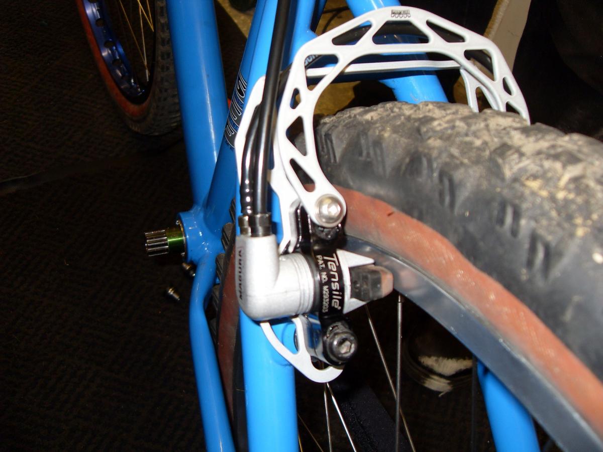

isitafox Posted November 24, 2012 Report Share Posted November 24, 2012 I managed it using an evo 2 kit and some offset mounts with a bit of machining but it aint worth the hassle. Just get a mavic 521 rim on there and your worry is gone. Quote Link to comment Share on other sites More sharing options...

isitafox Posted November 24, 2012 Report Share Posted November 24, 2012 Here is what I ran, it did work great considering but I'd still use a narrow rim or disc brake Quote Link to comment Share on other sites More sharing options...
