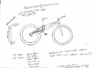

dezmtber Posted November 23, 2012 Report Share Posted November 23, 2012 ok the idea i have is for a 24" that will feel like i am on my mod but with extra weight and larger wheels great for training. i have a seat post design in there to make it versitile enough to ride the short ride to and from work, as most my training is done during my commute. any thoughts ? Quote Link to comment Share on other sites More sharing options...
dezmtber Posted November 23, 2012 Author Report Share Posted November 23, 2012 ok the idea i have is for a 24" that will feel like i am on my mod but with extra weight and larger wheels great for training. i have a seat post design in there to make it versitile enough to ride the short ride to and from work, as most my training is done during my commute. any thoughts ? Quote Link to comment Share on other sites More sharing options...

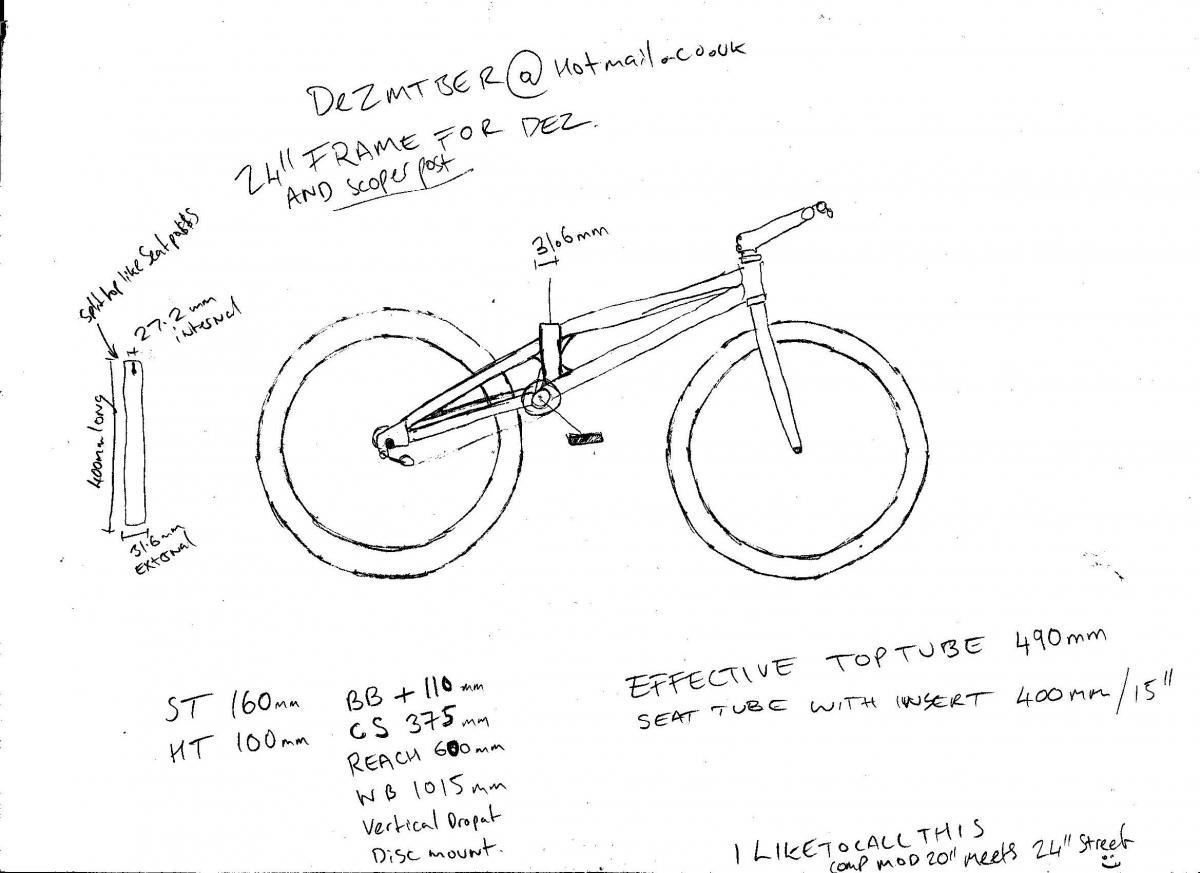

Luke Rainbird Posted November 23, 2012 Report Share Posted November 23, 2012 What are you "training" for? In other news; That looks f**king disgusting. Where on earth have you pulled those numbers from?! Phenomenally high BB and short wheelbase is going to feel rancid, even with that long stem on there. Lengthen the WB a little, drop the BB a LOT and you'll be getting back into the right sort of ballpark again. How long is the commute that you'll be using this for? Gearing will be a battle if it's more than a couple of miles. I'm not sure if you've tried to combine mod/24" geo by just pinching random numbers from each, but whatever it is you've done you're doing it oh so very wrong! Edit. Since the image appears to be gone again: Wb: 1015mm Cs: 375mm BB: +110mm Head tube: 100mm Seat tube: 160mm Crudely salvaged from a thumbnail 2 Quote Link to comment Share on other sites More sharing options...
Revolver Posted November 23, 2012 Report Share Posted November 23, 2012 That seat tube is so small, it won't be useful. Quote Link to comment Share on other sites More sharing options...
isitafox Posted November 23, 2012 Report Share Posted November 23, 2012 No, +110 with a 100mm headtube? Stem will have to be massive even for a short lad like yourself Quote Link to comment Share on other sites More sharing options...

dezmtber Posted November 23, 2012 Author Report Share Posted November 23, 2012 The pic doesn't seem to show on mobile for some reason. Custom ain't custom if its not mental. The post will be a alloy extention of the frame and will have a post fitted ontop of it. Quote Link to comment Share on other sites More sharing options...
N.Wood Posted November 23, 2012 Report Share Posted November 23, 2012 That sounds kinda similar to Pete Wrights frame Fresh Products did for him geo wise, i.e huge bb and tiny stays. Anyways apart from the fact it unbolted its self after the first ride, when it was still in one piece it rode like a bag of dogshit. 1 Quote Link to comment Share on other sites More sharing options...
Jake. Posted November 23, 2012 Report Share Posted November 23, 2012 Here's a better pic guys: Personally I think it's a f**king stupid geo... Quote Link to comment Share on other sites More sharing options...
Luke Rainbird Posted November 23, 2012 Report Share Posted November 23, 2012 Custom ain't custom if its not mental. Er, yes, it is. I get what you're doing with the extension. Weird and unnecessary but whatever. It's more the ridiculous WB/BB combo and so on. Tweak it to 1025, +35 or so and you will be much better off. 1 Quote Link to comment Share on other sites More sharing options...
LEON Posted November 23, 2012 Report Share Posted November 23, 2012 That looks disgusting, even the numbers look disgusting. Why not just spend £50 on a cheap mountain bike for the commute and ride outside work hours? Quote Link to comment Share on other sites More sharing options...
Mark W Posted November 23, 2012 Report Share Posted November 23, 2012 Having a really steep seat tube set quite far forward with an overly high BB = You need to film yourself sitting down pedalling on that. EDIT: +110mm BB, 600mm reach and a 1015mm WB suggests a fruity head angle? 2 Quote Link to comment Share on other sites More sharing options...
Ali C Posted November 23, 2012 Report Share Posted November 23, 2012 worst.geo.ever. Like not even good for anything. Sorry to sound harsh, but if you're really considering that as a feasable idea then I'm lost for words, I still kinda hoping this is a joke and I'm waiting patiently for the punchline. 1 Quote Link to comment Share on other sites More sharing options...

dezmtber Posted November 23, 2012 Author Report Share Posted November 23, 2012 should i buy a protractor, i think i am missing a vital part in this does any one know what head angle this would make, or would that be tellin Quote Link to comment Share on other sites More sharing options...
Jo Prattley Posted November 23, 2012 Report Share Posted November 23, 2012 why not just buy a mtb bike for £1 from a police auction .. this way you can have a mod bike AND a bike for your commute .. i dont think compromise is a word that should be associated with trials riding at all ! Quote Link to comment Share on other sites More sharing options...
Ali C Posted November 23, 2012 Report Share Posted November 23, 2012 steep Quote Link to comment Share on other sites More sharing options...
Luke Rainbird Posted November 23, 2012 Report Share Posted November 23, 2012 Head angle's the least of your worries at this stage. 1 Quote Link to comment Share on other sites More sharing options...
