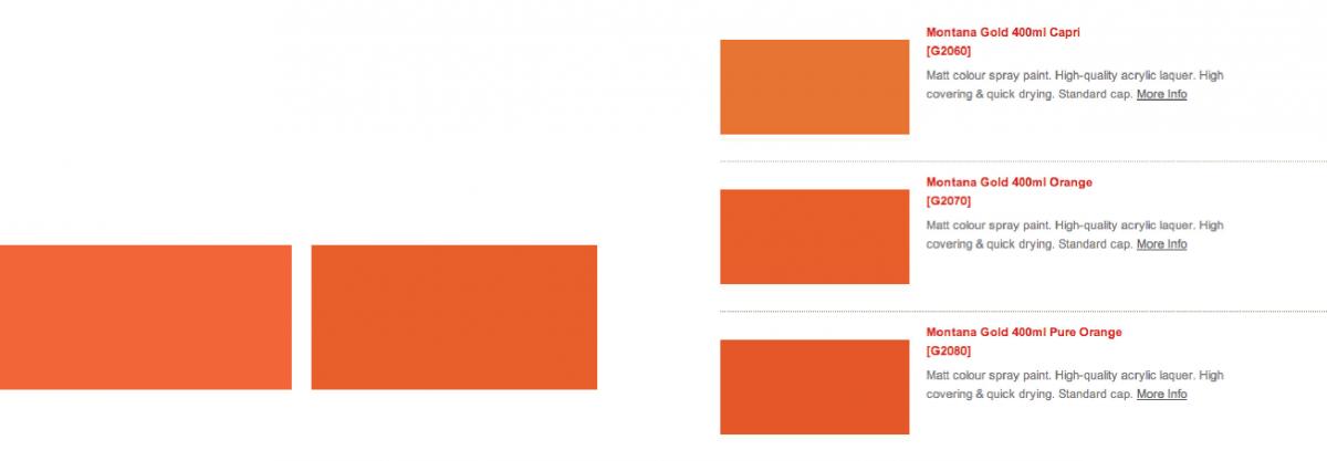

JD™ Posted November 16, 2012 Author Report Share Posted November 16, 2012 Umm what? Car colours are very popular when it comes to getting spray paints, and there's a HUGE range of colours. There was a lad on this forum ages ago who sprayed his frame Volkswagen green I think? Looked so nice! #FF6633 C: 0 M: 75 Y: 85 K: 0 Off you go then, which car had a matt of that shade? If I wasn't looking for a specific shade of a specific colour (which isn't used much in cars) then I wouldn't be asking... I'm not a complete retard. 1 Quote Link to comment Share on other sites More sharing options...

Matthew62 Posted November 16, 2012 Report Share Posted November 16, 2012 (edited) Try this buddy: http://www.montana-c...lorfinder-gold/ They're flat orange from my quick test in Illustrator is very close (see screen grab attached - your colour is furthest left). Link to buy the orange paint: http://www.londongra...ld-400ml-Orange and there Capri colour which is close: http://www.londongraphics.co.uk/products/Art-Supplies/Spray-Paint/Montana-GOLD-Spray-Paint/G2060_Montana-Gold-400ml-Capri The Montana gold is the stuff I used to spray my old Inspired when it was that Miami Vice Green. P.S. Remember the final colour of the finished bike depends on the purity of a white primer layer. Edited November 16, 2012 by Matthew62 1 Quote Link to comment Share on other sites More sharing options...
JD™ Posted November 16, 2012 Author Report Share Posted November 16, 2012 Try this buddy: http://www.montana-c...lorfinder-gold/ They're flat orange from my quick test in Illustrator is very close (see screen grab attached - your colour is furthest left). Link to buy the orange paint: http://www.londongra...ld-400ml-Orange and there Capri colour which is close:http://www.londongraphics.co.uk/products/Art-Supplies/Spray-Paint/Montana-GOLD-Spray-Paint/G2060_Montana-Gold-400ml-Capri The Montana gold is the stuff I used to spray my old Inspired when it was that Miami Vice Green. P.S. Remember the final colour of the finished bike depends on the purity of a white primer layer. You are an absolute legend, cheers mate I bought some pretty decent white primer the other day so I'm hoping it'll come out OK... Quote Link to comment Share on other sites More sharing options...

Matthew62 Posted November 16, 2012 Report Share Posted November 16, 2012 No problem, and should have mentioned the paints are a Matte finish as standard. To double check before buying if you're in the City head to the dials behind Covent Garden and London Graphic is down there and they have a pretty well stocked selection upstairs. If you're doing it properly you can always follow the procedure I did when buying mine which is to go to the pub on the edge of the dials having gone to London Graphic to pick up the Montana Gold colour chart, have a couple of beers whilst agonising over which shade to go for, then head back to London Graphic and spent the best part of an hour trying decide between two almost indistinguishable shades. I found with that paint it's definitely best to hang your frame as it can go down quite heavily and it really does need lots of very very light layers built up to achieve a good finish. It's not quite so fool-proof as Halfords paint so a bit of extra care I found was necessary. Quote Link to comment Share on other sites More sharing options...
JD™ Posted November 16, 2012 Author Report Share Posted November 16, 2012 Yea I was after matte, but I'll probably end up lacquering anyway. Started 'building' my new spray booth in the garage last night so everything that's being sprayed will get hung for sure, cheers for the help mate! Quote Link to comment Share on other sites More sharing options...
Matthew62 Posted November 16, 2012 Report Share Posted November 16, 2012 Cool - yeah I still lacquered mine but it had a more Matte finish in comparison to those Halford's car paints (you remember my old Inspired Italia paint job) - the Montana Gold version was much more matte despite them both having the same amount of lacquer. Also you have the joy of saying your bike is painted using "Montana Gold" (which you should say in an American accent). Also a bonus that it's actually cheaper than Halford's stuff too. Looking forward to seeing the new bike! Need to get mine sprayed soon - but not sure I'm going to do a home-done job this time. Quote Link to comment Share on other sites More sharing options...
