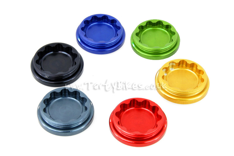

dann2707 Posted November 6, 2012 Author Report Share Posted November 6, 2012 Well I've changed the bleed nipple, all the seals in the caliper and lever (although the bore cap seal from tarty is the larger version so Hope sent me one free of charge). I removed the caliper piston seals again to make sure they were completely clean underneath however there was quite a bit of dirt so I cleaned that to an immaculate condition! Also on the bore cap side piston edges (the edge that is sealed by the seal) I noticed like, what can only be described as like oxidation? So I sanded that off as carefully as I could and fit it back into the caliper, it slid in much easier whereas removing it took so much pressure! Refit everything and rebled it by fitting old pads and fitting a block of metal inbetween them so there was no caliper movement what so ever (before I placed some pliers in the caliper but it wasn't that great of a fit) and It feels absolutely amazing now, barely have to pull the brake and it locks on. So glad it's sorted! Can now ride! My rear brake feels so much better than the front and my front is incredible. Just thought i'd update incase it helps anyone in the future reading this.Oh and another thing to note, when I changed the seals in the lever, I realised I hadn't fit the copper washer and circlip for the piston properly, it was holding but wasn't properly located so the washer was moving around a bit. Not sure if that effected how it was bled though. 1 Quote Link to comment Share on other sites More sharing options...

AdamR28 Posted November 6, 2012 Report Share Posted November 6, 2012 Cheers dude. That is really odd. Hope don't make a larger bore cap seal than the one needed for that brake Silly question, but you were trying to put it here, yeah? Quote Link to comment Share on other sites More sharing options...
dann2707 Posted November 6, 2012 Author Report Share Posted November 6, 2012 Very strange indeed haha! Well when I rang up hope asking about the weird bleed nipple thing I told them about the seal and they sent me two bore cap seals, one that fits my brake now and another slightly larger one (the same size that came in the Hope caliper and lever kit) if that makes sense.And sorry, yes, fitting it as per the pic. Basically hope sent me two different sized bore seals. Quote Link to comment Share on other sites More sharing options...
AdamR28 Posted November 6, 2012 Report Share Posted November 6, 2012 I think I see what's happened - you've got a Mono Trial seal and a Trial Zone seal from Hope. The TZ one is a slightly different size as it goes in the caliper rather than the bore cap (http://www.tartybike...zoneborecap.jpg). It's entirely possible Hope have mixed them up when we got our last lot of complete seal kits, meaning you got the wrong one from us - sorry about that. I'll get a partial refund sorted out for you! 1 Quote Link to comment Share on other sites More sharing options...
