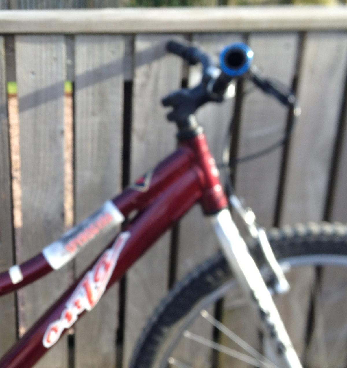

morriente Posted October 24, 2012 Report Share Posted October 24, 2012 Hi everyone, Ive just acquired a 26" Onza SpyroGyro as my first Trials bike but i'm having a wee bit trouble. The bike does not have standard bars or headset and they appear to be from a DH mountain-bike, Im 6'1' and it feels like the geometry or something is off. The bars feel too close to me and it feels like the crank is not that much lower than the bars. I had a wee play on a 20" Onza in a shop and it felt like there was much more room on it and it felt easier to get on to the back wheel and hop. Would the bars and headset make that much difference? Im an ex MX rider and have had a motorcycle trials bike for years and I'm also a reasonable mountain-biker. Also are there any Fife riders out there? Thanks Quote Link to comment Share on other sites More sharing options...

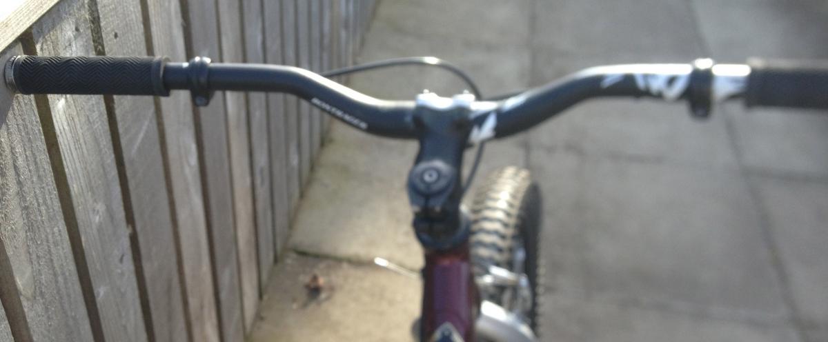

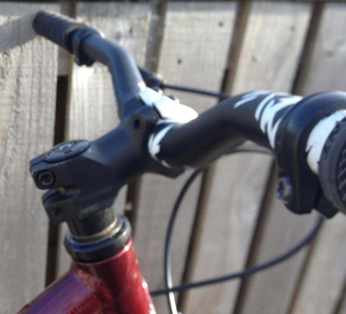

morriente Posted October 26, 2012 Author Report Share Posted October 26, 2012 Finally managed to get some pics attached. Im thinking that the stems too short and not enough angle and the bars are too flat! Quote Link to comment Share on other sites More sharing options...
bing Posted October 26, 2012 Report Share Posted October 26, 2012 bars look ok ish, but stem is deffo too short and flat. 125 x 30 at the least is needed Quote Link to comment Share on other sites More sharing options...
Pete.M Posted October 26, 2012 Report Share Posted October 26, 2012 bars look ok ish, but stem is deffo too short and flat. 125 x 30 at the least is needed 30 seems a bit high for a low bb stock? I'd suggest 115 x 20 ish... Quote Link to comment Share on other sites More sharing options...
Ali C Posted October 26, 2012 Report Share Posted October 26, 2012 a trialtech 20X17 sport stem will transform that bike Quote Link to comment Share on other sites More sharing options...
isitafox Posted October 27, 2012 Report Share Posted October 27, 2012 Missed a 1 off there Ali, he means 120x17° which can be found here http://www.tartybike.../c41p10429.html 1 Quote Link to comment Share on other sites More sharing options...
morriente Posted October 27, 2012 Author Report Share Posted October 27, 2012 Thanks guys, i'll give that one a go. I'd already tried a 130x10° which i found in the shed but it felt terrible. It sounds like the120x17° will bring the bars up and in a bit. I'll post how i get on. Quote Link to comment Share on other sites More sharing options...
