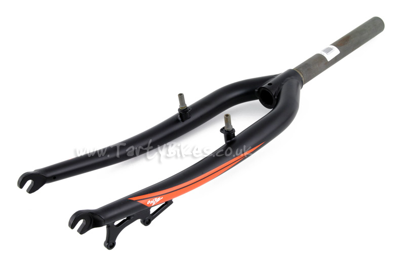

I'm needing some new forks for my 24( tgs) I'm after the strongest , longest lasting pair I can find but without being stupidly heavy , I'd like to run hs33 but if I can't then I'll just use trialttech 26"s with an avid.
Heard some bad things about urbans and I don't have a great amount of experience with the other available makes so help would be great.

Not overly heavy, are very strong, have a long steerer, steerer can fit a hollow star nut, have disc & 24" vee mounts, are less than £50.
I run them and rate them highly (Y)
standard zoot forks? they weigh 1600 grams!!! never have them ever again
  • Like 4
I'd normally buy urbans without thinking but I've seen a lot of people on here saying their forks have snapped after 3 months of riding , had no problems running disk on my mod with them but just a bit apprehensive
Theres a few people who installed the bottom race when you're not meant to, and the built in race only works with certain sealed bearing angles.
My Urbans bent within a month of me having them (older ones with no integrated crown race). Was sent out a set of 2013 urbans as a replacement and Im pleased to say theyre much better. Feel stiffer, and my front brake seems to perform better on them (vee). Pretty sweet. Although the Bonz Pro Light 24" forks are meant to be pretty sweet too.
