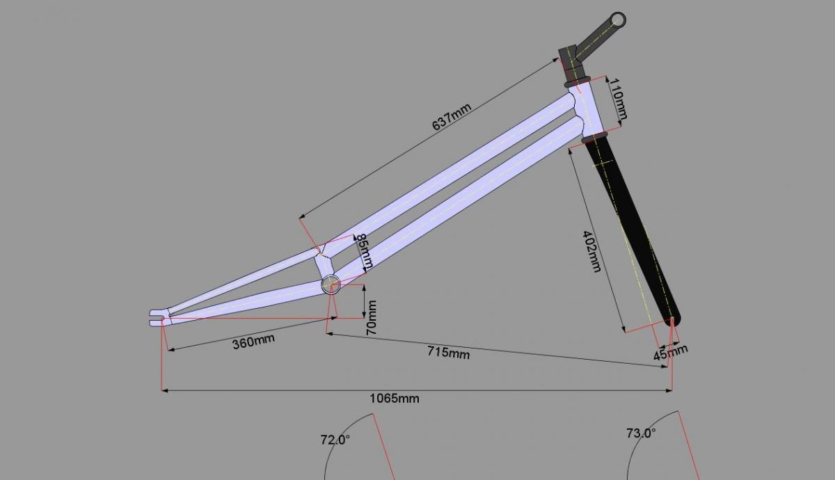

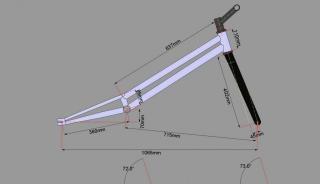

isitafox Posted October 17, 2012 Author Report Share Posted October 17, 2012 Right, I've got a design made up which to me looks about right. Works out with the reach being 665 which is the same as a 26" pure which is what I was after, and I'm pretty certain that the tweak of the headtube means with a Trialtech high rise stock stem the centre of the stem clamp with about 20mm of stackers will be almost identical to that of a standard Echo 24 running a Trialtech 150 x 35 mod stem and no stackers which from what I've seen seems to be the standard setup used. Does this sound like a manageable setup/geo or am I dreaming?! Also the geo I'm working from is based on what is listed on Tartybikes assuming they mean the 2009 version of the Urban forks which were 402 A-C and 45mm offset 1 Quote Link to comment Share on other sites More sharing options...
eskimo Posted October 19, 2012 Report Share Posted October 19, 2012 Almost doesn't cut it. Unless you know what you're doing, don't go changing stuff. Even if you were to say keep the rear end the same, it'll still change despite being the same. Quote Link to comment Share on other sites More sharing options...
