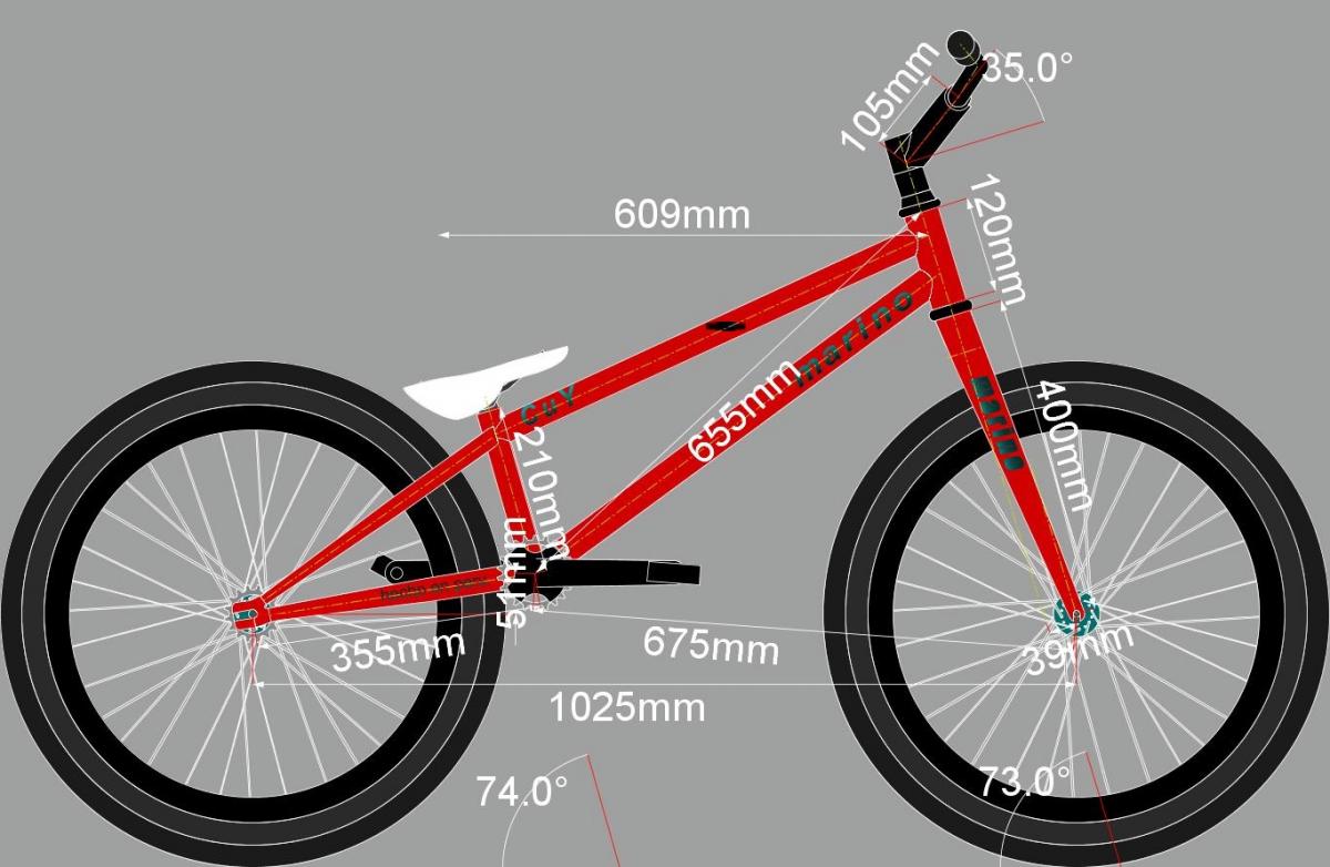

FamilyBiker Posted December 29, 2012 Report Share Posted December 29, 2012 (edited) massively depends on how you told him to do,if you send a spec list that tells you have a clue there are not many things to confirm. i sent a wordpad doc and a bikecadfile and havent received any questions yet. i have a clue... Edited December 29, 2012 by FamilyBiker Quote Link to comment Share on other sites More sharing options...

isitafox Posted December 29, 2012 Report Share Posted December 29, 2012 Did you do that in bikecad? I couldn't for the life of me find an option to show/input the reach, I know you need the pro version to show the wheelbase. Quote Link to comment Share on other sites More sharing options...
LEON Posted December 29, 2012 Author Report Share Posted December 29, 2012 (edited) sent that plus a word doc with special details,received just an "ok" I'd love to see your tyre clearance when it's built lol. Is that a 51mm bb rise too?? Edited December 29, 2012 by LEON Quote Link to comment Share on other sites More sharing options...
FamilyBiker Posted December 29, 2012 Report Share Posted December 29, 2012 (edited) on my actual frame its 364mm,final position will be at 359 on the new one. my chainstays are pretty flat at the yoke area,but hey,its steel! ´ll let you know if it works lol as for bb rise:you´ll be wanting that geo in the future..... ....i hope. i´m experimenting,thats what custom is supposed to,right? Edited December 29, 2012 by FamilyBiker Quote Link to comment Share on other sites More sharing options...

FamilyBiker Posted December 29, 2012 Report Share Posted December 29, 2012 (edited) pretty High, I thought mine might be too high at +25 ha i´m doing too much backwheel stuff for having a streety geo anymore,i´m trying to evolve my geo to the style i´m riding and my body measurements,based on my experience with my actual frame and a friends because street.both were too low on bb for me,mine still is... maybe its gonna be a trials bike in street look,but who cares? i´m sick of the cramped feel Edited December 29, 2012 by FamilyBiker Quote Link to comment Share on other sites More sharing options...
FamilyBiker Posted December 29, 2012 Report Share Posted December 29, 2012 Did you do that in bikecad? I couldn't for the life of me find an option to show/input the reach, I know you need the pro version to show the wheelbase. become a bicycle mechanic,experience stuff Quote Link to comment Share on other sites More sharing options...

Paperclip Posted December 29, 2012 Report Share Posted December 29, 2012 You don't want your frame to be cramped........ 359 chain stay? Right Quote Link to comment Share on other sites More sharing options...
LEON Posted December 29, 2012 Author Report Share Posted December 29, 2012 The back end has nothing to do with your reach/ being cramped. Because his stays are so short, he can have a more spacious front end for the same given wheelbase. 1 Quote Link to comment Share on other sites More sharing options...
