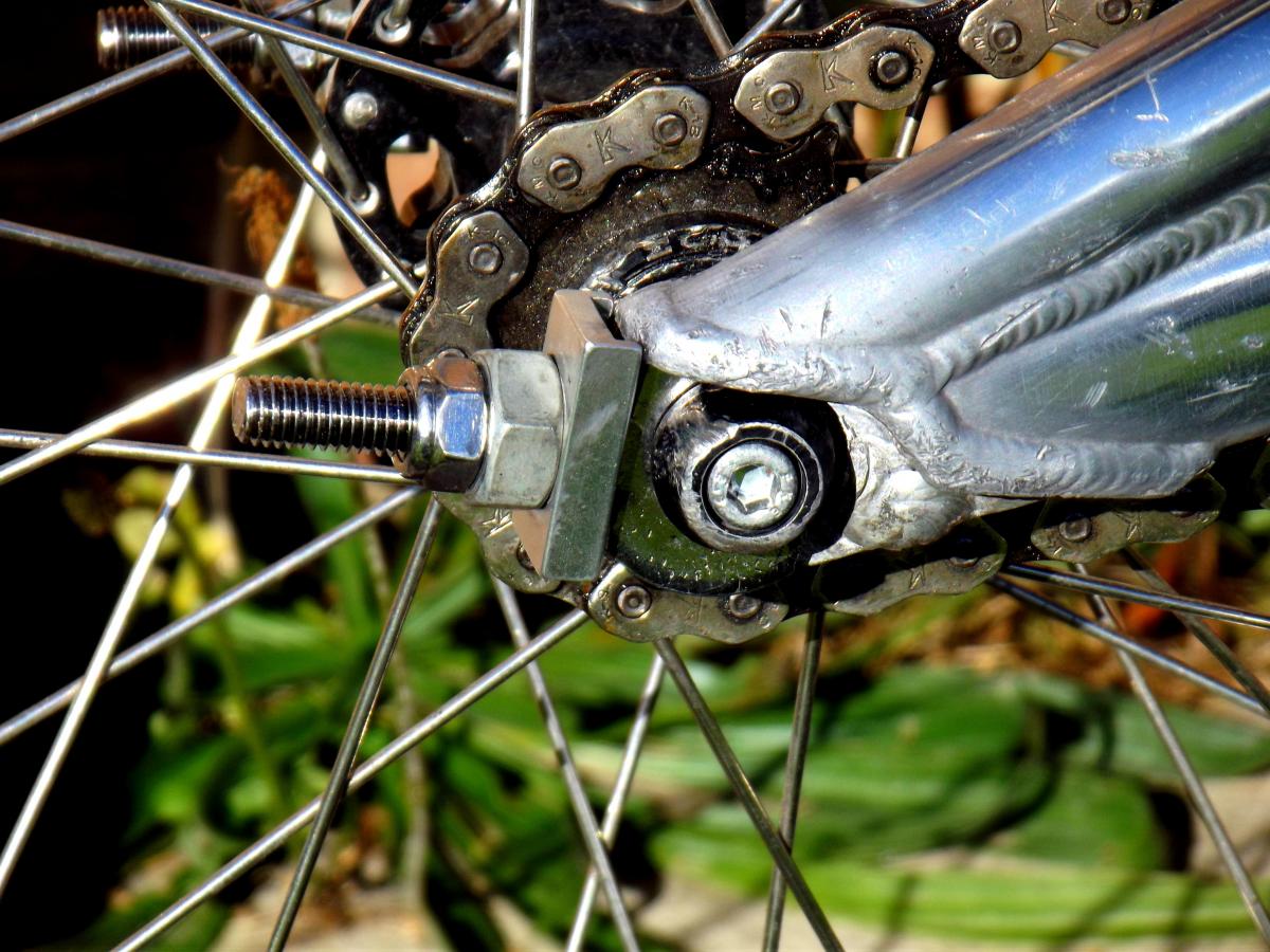

Julius Czar Posted October 15, 2012 Report Share Posted October 15, 2012 Hey guys! Been out of the loop for a while with my job and no one else to ride with, recently got back into it with my mate (BigAl) as he has just bought a new steed. Problem is that the built in tensioners on the ice are really temperamental, I've lost one from the non-drive dropout but it didn't really make a difference so I'm currently running one. I'm finding it difficult to get good chain tension with a good brake as well. I thought the other day if i drilled a hole through the dropout and tapped a thread into it would it hold up for the use of cams? Any help would be great! Kieran Quote Link to comment Share on other sites More sharing options...

p_ruskin Posted October 15, 2012 Report Share Posted October 15, 2012 You can drill in bolts and use cams as long as you hub is the correct width, or buy some new tensioners and run the onza ones, i use them and have never really had problems Quote Link to comment Share on other sites More sharing options...

Blake Posted October 15, 2012 Report Share Posted October 15, 2012 Afraid cams wont work with the ice due to its spacing. Quote Link to comment Share on other sites More sharing options...
BradJohnson Posted October 15, 2012 Report Share Posted October 15, 2012 Bodge some chain tugs. I did on my echo 24" Quote Link to comment Share on other sites More sharing options...
CalRobbo341 Posted October 15, 2012 Report Share Posted October 15, 2012 M6 bolt through does the job nicely, unless you have stripped the thread that is? Quote Link to comment Share on other sites More sharing options...
dezmtber Posted October 15, 2012 Report Share Posted October 15, 2012 use the gusset chain tugs the guy used on his echo. there the ten quid ones in all steel bombproof Quote Link to comment Share on other sites More sharing options...
