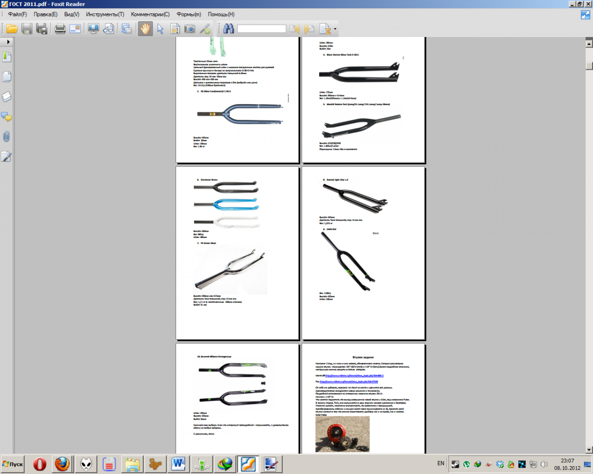

clerictgm Posted October 8, 2012 Author Report Share Posted October 8, 2012 NS Bikes Analog Forks 2012 1.1kg $149.31 http://www.chainreactioncycles.com/Models.aspx?ModelID=69768 Axle to Crown length: 410mm Axle to Crown length of Inspired Team: 410mm Black Market Tech 9 1.13kg (395mm) 1.16kg (414mm) And maybe there are some more forks. Quote Link to comment Share on other sites More sharing options...
clerictgm Posted October 8, 2012 Author Report Share Posted October 8, 2012 It seems that there are only 2 suitable MTB forks.. I'l try it if my Inspired tired one day. Quote Link to comment Share on other sites More sharing options...
