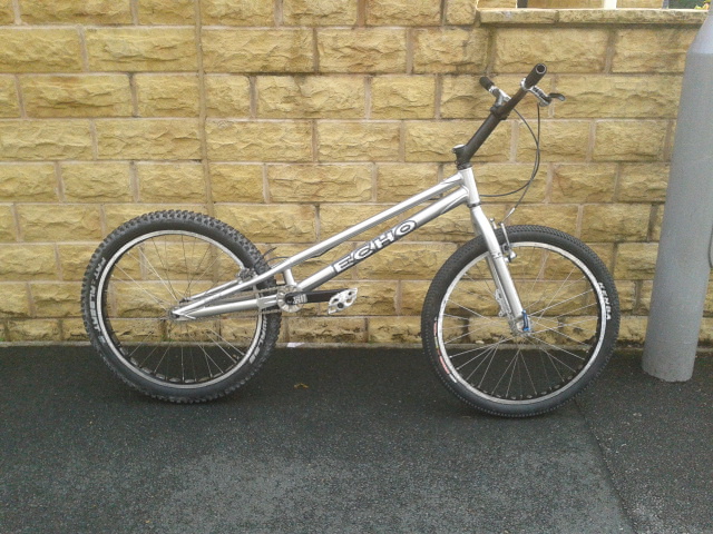

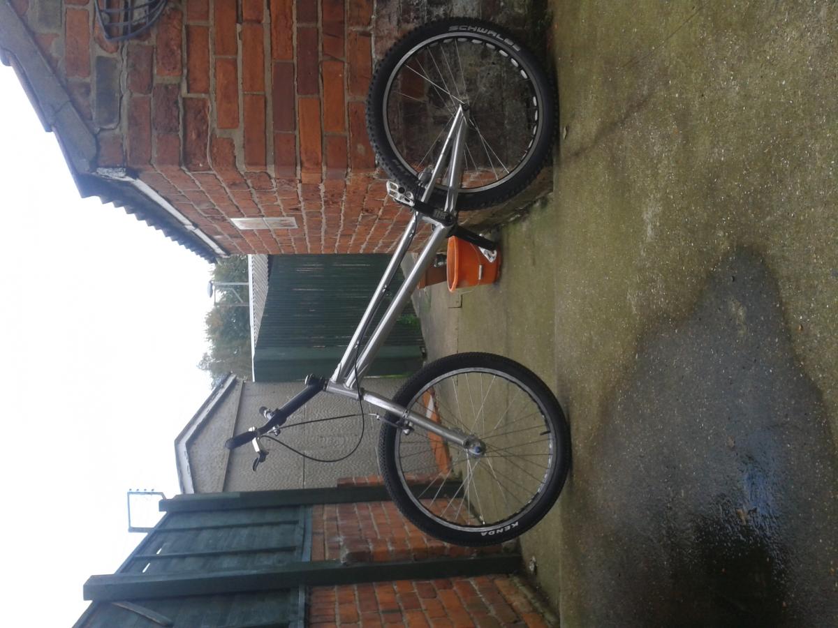

SamKidney Posted October 6, 2012 Report Share Posted October 6, 2012 (edited) After a ride today my mate noticed that my forks looked like they have more rake than normal.. Is it common for aluminium to bend a little before they snap? I thought alu snapped without warning. I looked afterwards and it definately seems like they are, or is it my eyes tricking me? Will get two photos up soon. When new: Today: Edited October 6, 2012 by Echo Lite 09 Quote Link to comment Share on other sites More sharing options...
clerictgm Posted October 6, 2012 Report Share Posted October 6, 2012 (edited) Time for new fork I think. Need to watch photos anyway. Edited October 6, 2012 by clerictgm Quote Link to comment Share on other sites More sharing options...
Blake Posted October 6, 2012 Report Share Posted October 6, 2012 They look dead bent. could you change the orientation of the bottom picture please Quote Link to comment Share on other sites More sharing options...
trials hoe Posted October 6, 2012 Report Share Posted October 6, 2012 measured your wb or looked for stress marks? the tapemeasure never lies..... Quote Link to comment Share on other sites More sharing options...
SamKidney Posted October 6, 2012 Author Report Share Posted October 6, 2012 Took the forks out and did a rough dropout to center of steerer ofset. Its meant to be 45mm, I got 55mm... But it was a rough measurement Quote Link to comment Share on other sites More sharing options...

SamKidney Posted October 6, 2012 Author Report Share Posted October 6, 2012 (edited) Wheelbase with Urban forks is stated to be 1065mm... Mines 1077 hahahaha. Ive bent something somewhere :L And my rear wheels just forward of the center of the dropout Edited October 6, 2012 by Echo Lite 09 Quote Link to comment Share on other sites More sharing options...

Sam Nichols Posted October 6, 2012 Report Share Posted October 6, 2012 It was pretty difficult to calculate because of the different perspective and range from which each picture was taken, but using some simple trig overlayed onto a protractor accompanied by an inflatable slide style translucent graph with a carefully calculated inritus irritus scale I was able to work out the following for you.. I won't insult your intelligence by explaining the findings, it's all pretty self explanatory after all. 2 Quote Link to comment Share on other sites More sharing options...
SamKidney Posted October 6, 2012 Author Report Share Posted October 6, 2012 It was pretty difficult to calculate because of the different perspective and range from which each picture was taken, but using some simple trig overlayed onto a protractor accompanied by an inflatable slide style translucent graph with a carefully calculated inritus irritus scale I was able to work out the following for you.. I won't insult your intelligence by explaining the findings, it's all pretty self explanatory after all. Very helpful! I wouldnt have thought to do that myself. Cheers Quote Link to comment Share on other sites More sharing options...
FamilyBiker Posted October 6, 2012 Report Share Posted October 6, 2012 (edited) i would´ve had something really straight held against the steerer(tends to bend where the bearing sits),but ohhhh-kayyyy,thats good too. Edited October 6, 2012 by FamilyBiker Quote Link to comment Share on other sites More sharing options...
SamKidney Posted October 6, 2012 Author Report Share Posted October 6, 2012 i woul´ve had something really straight held against the steerer,but ohhhh-kayyyy,thats good too. I removed the forks and did this. Its not that thats bent. The above method is very clever! I came to the conclusion they were after measuring my wheelbase. Its a very useful image though that will help my warranty claim, even though they are obviously bent. Quote Link to comment Share on other sites More sharing options...
Andeee Posted October 6, 2012 Report Share Posted October 6, 2012 I hate the idea i had to tilt my head to compare lol. Bad luck there man! Are urbans still made of cheese? Quote Link to comment Share on other sites More sharing options...
SamKidney Posted October 6, 2012 Author Report Share Posted October 6, 2012 Haha, no idea why it came out sideways. It would seem so! Bit miffed off about it but hey, shit happens haha Quote Link to comment Share on other sites More sharing options...
