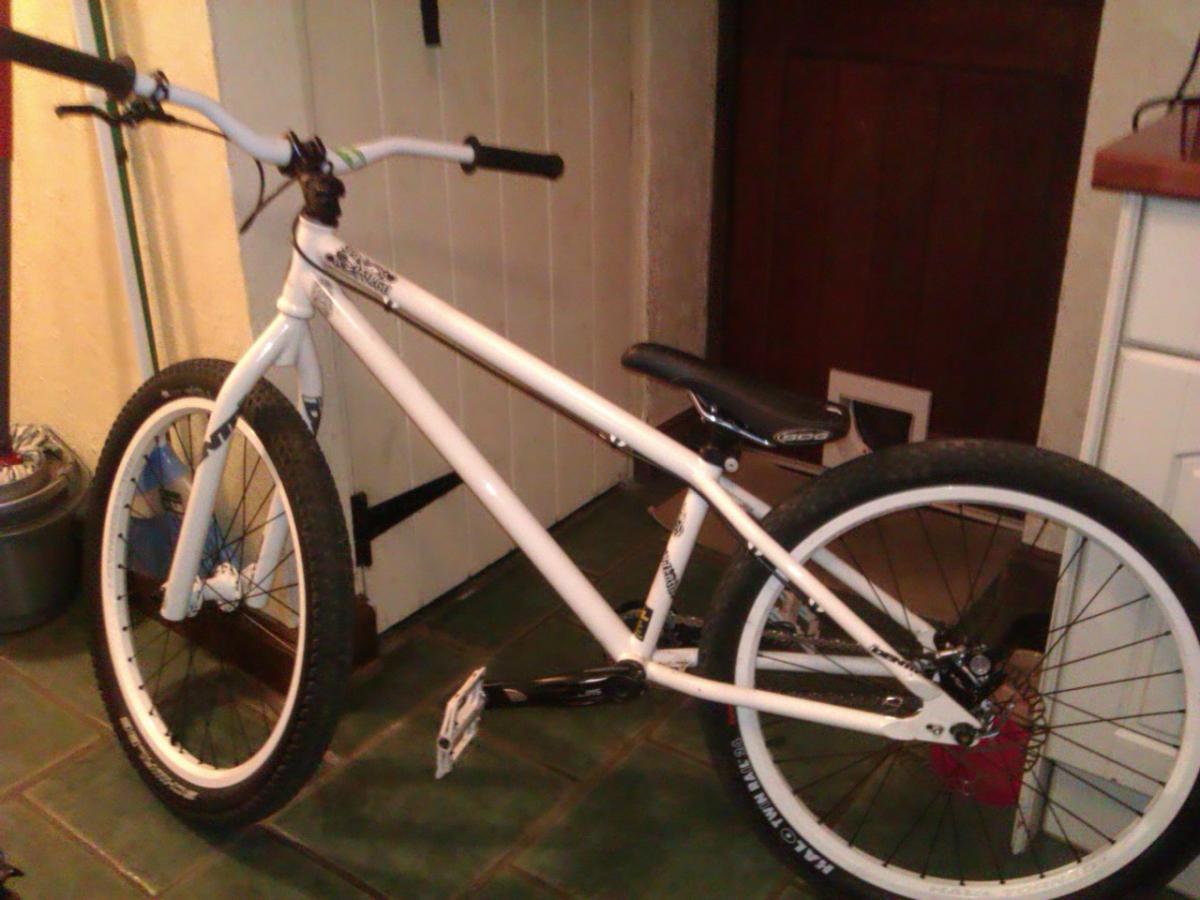

dezmtber Posted September 24, 2012 Report Share Posted September 24, 2012 (edited) SPEC: Identiti p60 steel frame Rebate rigids. For sale if anyone wants them £45 Halo djd bush drive hub on tornado rim halo twin rail tire Halo spin doctor on tornado rim schwabe table top tire. Gusset bars Hope fr stem 70mm by 25deg Deore hollowtech 2 cranks Hope trial zone on 180mm rotor Edited October 12, 2012 by dezmtber Quote Link to comment Share on other sites More sharing options...
isitafox Posted September 24, 2012 Report Share Posted September 24, 2012 What's the geo on that bad boy?? Looks very nice! Quote Link to comment Share on other sites More sharing options...
Rich J Posted September 25, 2012 Report Share Posted September 25, 2012 Definately a jump bike. 2 Quote Link to comment Share on other sites More sharing options...
chimpanzyyyy Posted September 25, 2012 Report Share Posted September 25, 2012 looks awesome front end seems a bit low? Quote Link to comment Share on other sites More sharing options...
LEON Posted September 25, 2012 Report Share Posted September 25, 2012 (edited) Forks are loooong (dirt jump) they compensate for the low front. But yeah it's a jump bike at heart. Edited September 25, 2012 by LEON Quote Link to comment Share on other sites More sharing options...
Filo Posted September 25, 2012 Report Share Posted September 25, 2012 (edited) The rebate fork have a 435 crown height. Normal trials forks are 390-415 so not a lot of difference Edited September 25, 2012 by Filo Quote Link to comment Share on other sites More sharing options...
LEON Posted September 26, 2012 Report Share Posted September 26, 2012 30mm on your forks is a massive difference, that'll change your head angle by a couple of degrees, that's roughly the same as taking the entire headset on/off the bike. Normal trials forks are NOT 390mm, Maybe 10-12 years ago, and no one uses fattys/Pashley anymore, modern forks are 405-415. Quote Link to comment Share on other sites More sharing options...
Filo Posted September 26, 2012 Report Share Posted September 26, 2012 Considering normal jump forks are 485 mm there's not a lot of difference using 435mm forks. Yes it changes your HA,lucky to be 1-2 degrees though. I do have and run fattys so my 390 is a valid. Quote Link to comment Share on other sites More sharing options...
LEON Posted September 26, 2012 Report Share Posted September 26, 2012 Some people still have Fattys, but they're obselete now and no modern frames are designed with old forks in mind, modern forks are much longer and have less rake. Quote Link to comment Share on other sites More sharing options...

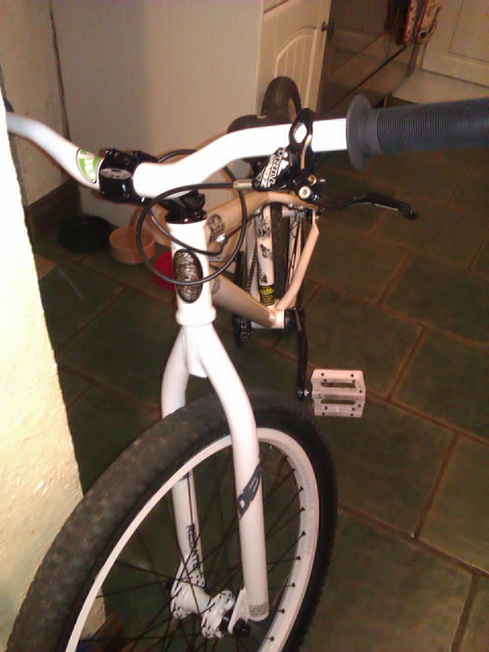

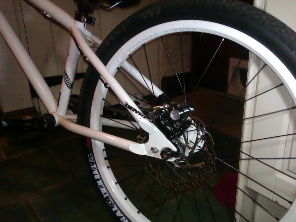

dezmtber Posted October 12, 2012 Author Report Share Posted October 12, 2012 right its been ages since i said i would measure the bike. i now have rockman spade forks fitted and its all measured up P60 Geo wheel base 990mm chain stay 390mm bb rise -10.5mm reach bb to top headtube 670mm steerer 115mm bb height from floor 299mm seat tube 290mm down tube 635mm toptube 550mm seat stay 400mm effective toptube 560mm its very simmilar to the inspired skye, i need to know the reach on the skye to know for sure.some pics of the new spec identiti Quote Link to comment Share on other sites More sharing options...
Revolver Posted October 12, 2012 Report Share Posted October 12, 2012 Bb drop sucks! Quote Link to comment Share on other sites More sharing options...
dezmtber Posted October 12, 2012 Author Report Share Posted October 12, 2012 its not too bad. but it is real stenge going from this to my rockman with +80 bb Quote Link to comment Share on other sites More sharing options...
SamKidney Posted October 12, 2012 Report Share Posted October 12, 2012 (edited) The Identiti Dr. Jekyl frames make suprisingly nice streety trials frames. Borrowed my mates the other night. Kitted out with Tech V2's on 180mm rotors and Pro2 hubs front and rear. Quite a stumpy Spank stem/bar combo, but as it had a light Rockshox air sprung fork, the front end comes up really nicely. Got in a few decent rolling gaps and static gaps. Even going up stuff wasnt toooo hard, although a slightly longer stem would help. Nothing massive mind. But for what it is, I wouldnt mind one. Something to hit the jumps on and have a good streety/trials mess around on the way there/home. Even had the luxury of gears for a change! Edited October 12, 2012 by Echo Lite 09 Quote Link to comment Share on other sites More sharing options...
LEON Posted October 12, 2012 Report Share Posted October 12, 2012 (edited) It'd be closer to a Skye with the dirt jump forks back on it, -10bb on a 24" is suicide. Edited October 12, 2012 by LEON 1 Quote Link to comment Share on other sites More sharing options...
Ali C Posted October 12, 2012 Report Share Posted October 12, 2012 right its been ages since i said i would measure the bike. i now have rockman spade forks fitted and its all measured up P60 Geo wheel base 990mm chain stay 390mm bb rise -10.5mm reach bb to top headtube 670mm steerer 115mm bb height from floor 299mm seat tube 290mm down tube 635mm toptube 550mm seat stay 400mm effective toptube 560mm its very simmilar to the inspired skye, i need to know the reach on the skye to know for sure. It's really not, 10mm longer chainstays = big difference, -10mm bb = big difference and I suspect the head angle is slacker too. Quote Link to comment Share on other sites More sharing options...
dezmtber Posted October 12, 2012 Author Report Share Posted October 12, 2012 So its a bit simmilar but the frame n fork cost. Less than £180 while the frames are cheap Quote Link to comment Share on other sites More sharing options...
Ali C Posted October 12, 2012 Report Share Posted October 12, 2012 the only thing similar is the wheelbase, even a couple of mil out on anything else will make it ride completely differently. Quote Link to comment Share on other sites More sharing options...
Muel Posted October 12, 2012 Report Share Posted October 12, 2012 You can tell just by looking at it that it won't ride anything like a skye. It's an interesting build, but it is a jump bike. It even has a BB drop lol. Quote Link to comment Share on other sites More sharing options...
N.Wood Posted October 13, 2012 Report Share Posted October 13, 2012 In that case the Azonic DS1 I rode 10 years ago had similar geo to the Skye, sweeet. Quote Link to comment Share on other sites More sharing options...
Jake. Posted October 13, 2012 Report Share Posted October 13, 2012 All these "similar skye" builds were funny at first but now they're getting quite annoying... Quote Link to comment Share on other sites More sharing options...
dezmtber Posted October 13, 2012 Author Report Share Posted October 13, 2012 i did check all the other geos on all the 24 bikes on tartys to see which was closest before asking. and i did say simmilar, i know its not the same. and still no one has said what the reach is on a skye. Quote Link to comment Share on other sites More sharing options...
