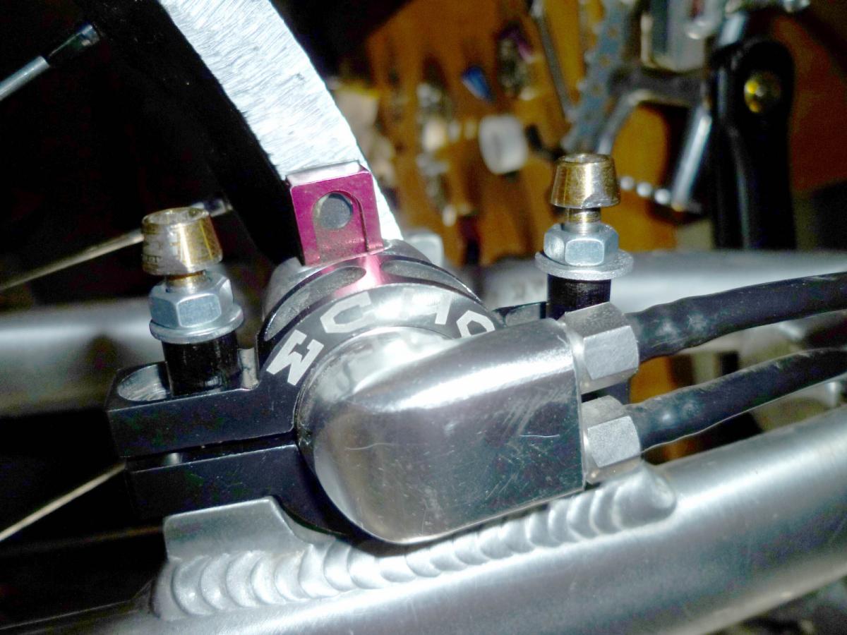

Maggy mounts are usually stripped when people tighten the bolts too hard ?

If you stripped thread in your frame - it's not a big problem.

I'd take a small unnoticeable weight gain, for the longevity of my frame any day. if you can notice 50-100grams of weight, which is a medium size bag of crisps, on your bike, I'll show my arse in tesco's window. go and weigh 4 helicoil inserts, bet it's not even that much

Anyway I've just stripped my echo the other day just from having a very tempermental clamp set up that the slaves move in unless being extremely tight , and echo don't really have the best threads I've come across

Because the underside of the magura mounts are square, if you do accidentally strip the threads you can run extra long bolts and run a nut on the flat side of the frame, genius design.

Isnt the answer easy to this?
Threads strip when "over tightened", generally because theyres no grease on there (in most cases)
The increased friction from dry fitting the bolt increases this risk, because as the bolt tightens, and starts to pull against the threads, the lack
of lubrication tries to turn the frames threads, being a softer metal, with the steel bolt. Voila, you have a stripped thread.
I know this. I almost stripped my 24"s threads (brand new). Applied some lithium grease to the frames threads, and tried again.
Result; I can now torque down my clamps further than before, with very little fiction induced resistance. No stripped threads,
tight clamps, reliable brake.
Applied it to all my bolts on my bike now. Everything's nice and tight, no creaking, nothing coming loose or shifting, lower chance of stripping the threads.
Win win.
Not a fan of the idea that companies should fit steel coils as standard.
Frames are not the cheapest things as it is. Adding another process would only drive up the price.
And if you pull out that coil, your forced to go to a larger thread. Having aluminium threads, means that if you strip them, you have another shot at running an M5 thread through helicoiling it.
