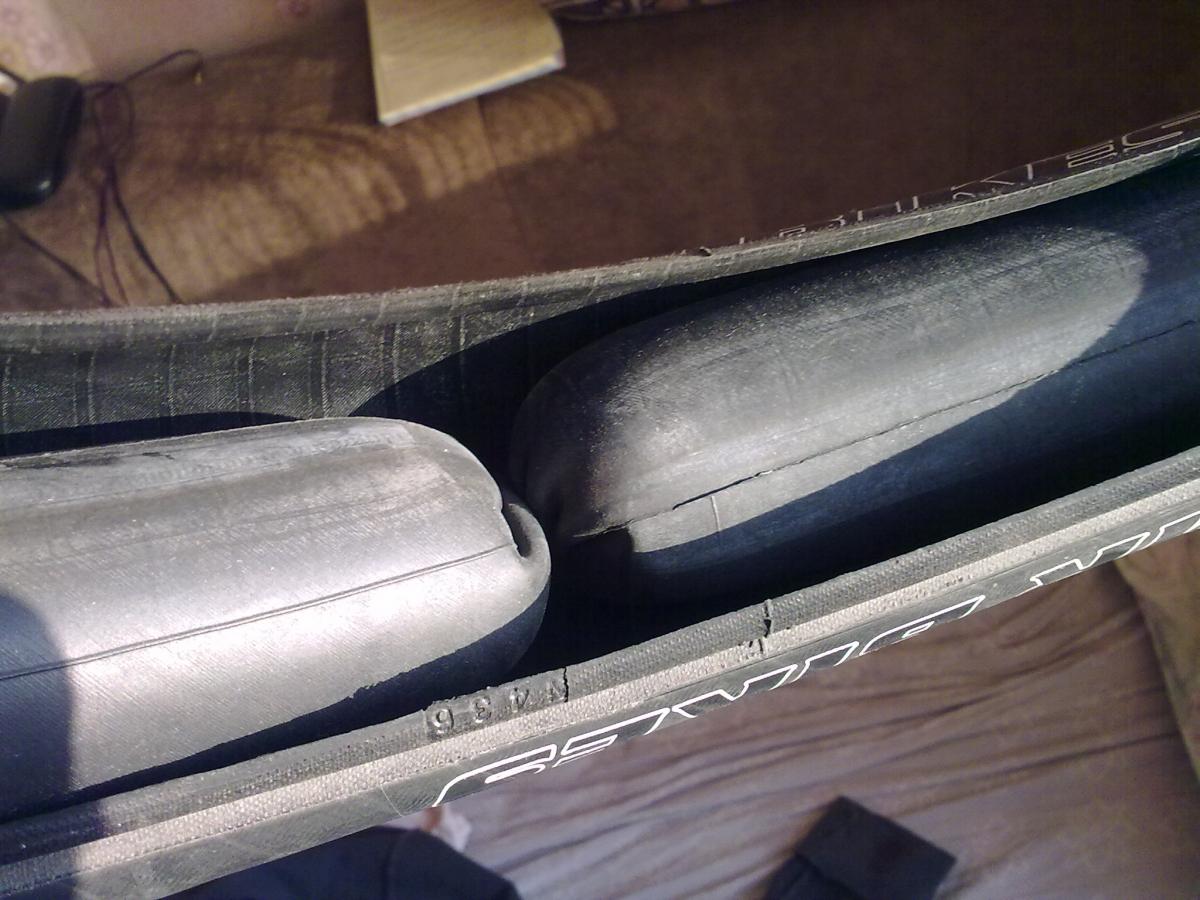

Edit: When putting a too-big tube in a wheel, I find stuffing it inside itself to work much better than folding.
Like this:
And put this bit opposite the valve to try and balance the heavy spot out a bit.
