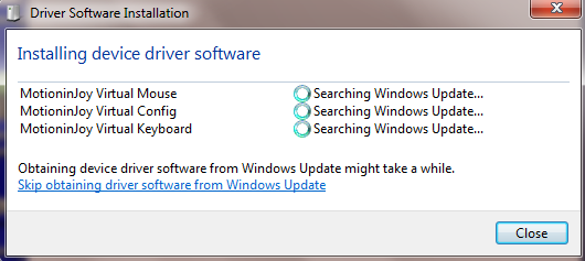

post-4715-0-19585400-1347413054_thumb.pn
When It's installing the drivers, there's a bunch of dodgy 3rd party stuff showing up, I think this is the problem. I uninstalled the drivers and software but the words 'motionjoy' still exist on my laptop.
How can I get rid of it?
