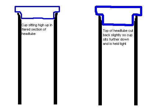

isitafox Posted August 31, 2012 Report Share Posted August 31, 2012 It'd help slightly as the headset cup would effectively be sat lower in the headtube where it is the correct diameter (right term?). As for the price I'd say roughly £10-£15 maybe. Quote Link to comment Share on other sites More sharing options...
isitafox Posted August 31, 2012 Report Share Posted August 31, 2012 I think this is correct anyway so here's the obligatory rough paint drawing to demonstrate! Quote Link to comment Share on other sites More sharing options...
Cap Posted August 31, 2012 Report Share Posted August 31, 2012 Facing the headtube would not remove that much material to make a difference I wouldn't of thought. Could always remove the cups, put stud and bearing fit on them and refit (might work) it will all depend on how bad the frame is. Hope this helps! Quote Link to comment Share on other sites More sharing options...
isitafox Posted August 31, 2012 Report Share Posted August 31, 2012 Ah well, was worth a guess! Quote Link to comment Share on other sites More sharing options...
