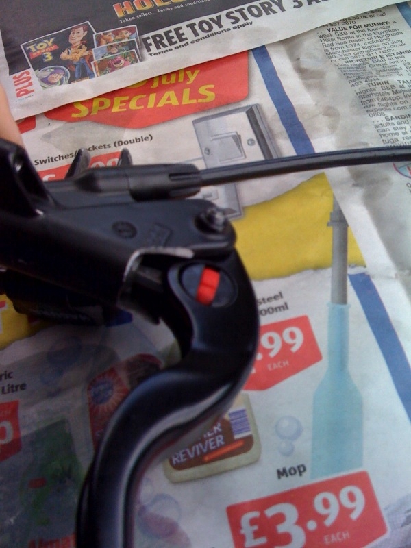

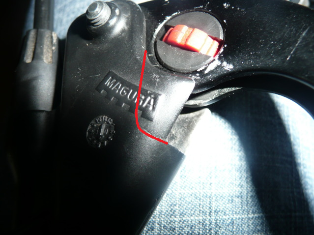

This quite a simple straightforward job. Here is an image of one of my old HS33 levers with the section you need to cut off marked in red. If you look closely you can just see where it has already cracked at the bottom under the red line. Luckily but cutting it as follows the lever body should be saved and will still be useable safely.
post-24247-051516600 1279356517_thumb.pn

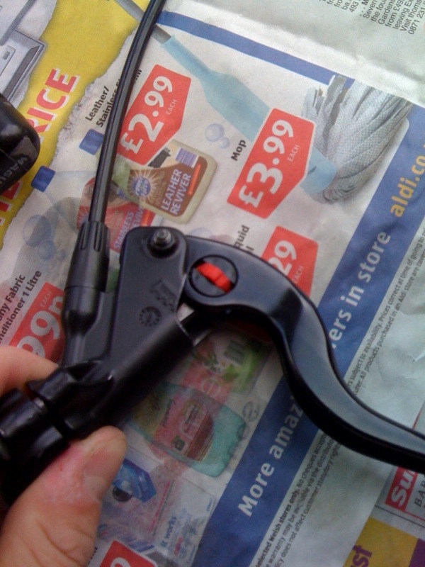

Once it is done your lever should look like this.
post-24247-019491700 1279376557_thumb.jp
post-24247-056698800 1279376548_thumb.jp
You can then simply clean the edge up with a small file, bit of wet and dry or the dremel.
