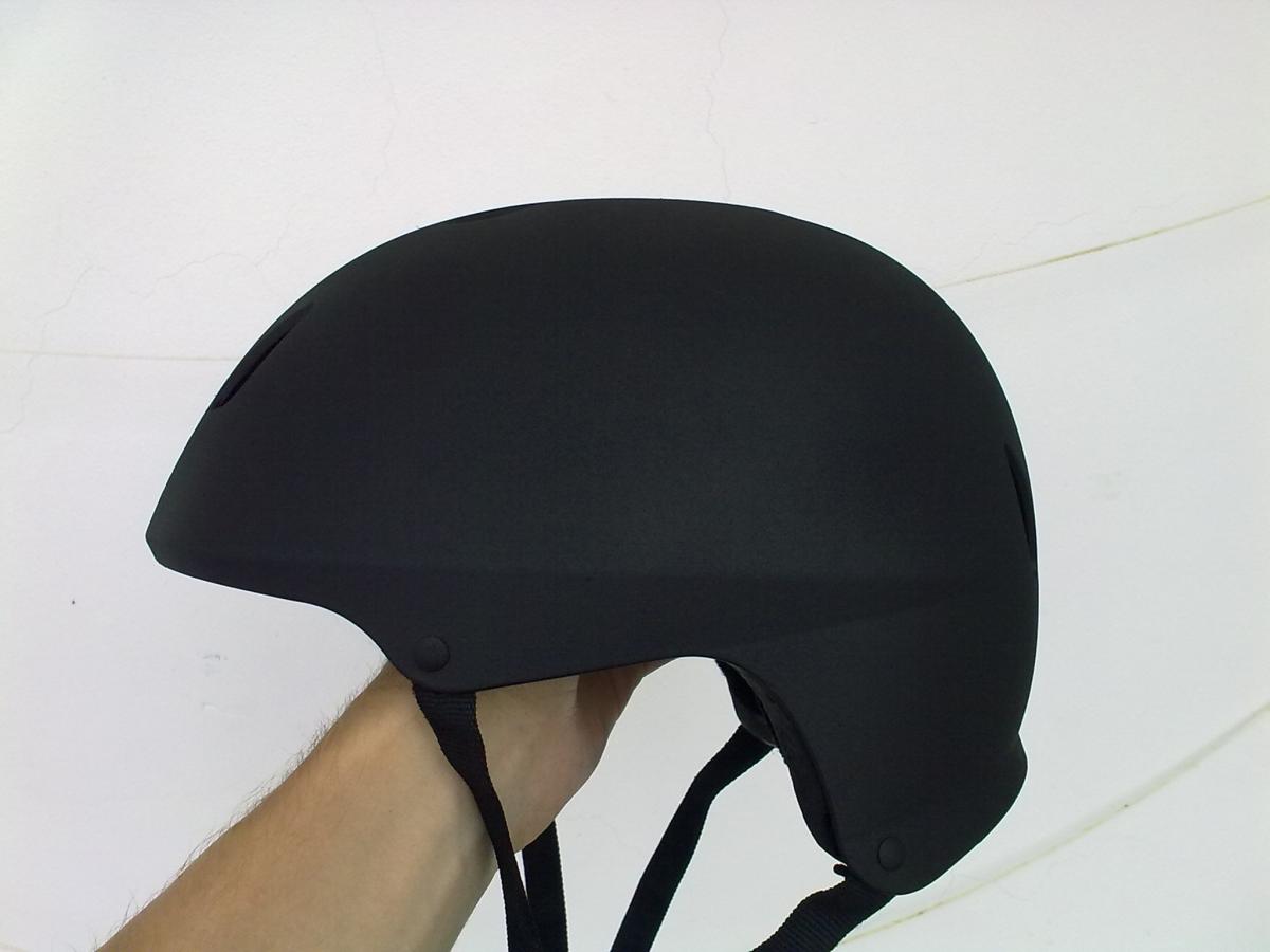

clerictgm Posted August 24, 2012 Report Share Posted August 24, 2012 After I paint my helmet I thinked about painting bars and frame, and I need some advice, because I never done that. Can someone describe in details all process? Frame are painted, bars are just polished aluminum. Quote Link to comment Share on other sites More sharing options...
