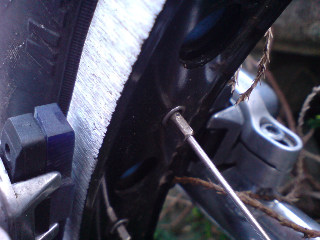

  • Go round the rim in a clockwise direction covering about 5-6" at a time, the angle is a personal preference though a steeper angle tends to give a deeper grind.
The result should look something like this.
post-24247-0-46278600-1345761997_thumb.j
Once completed refit the tyre/wheel and reset your brakes.
