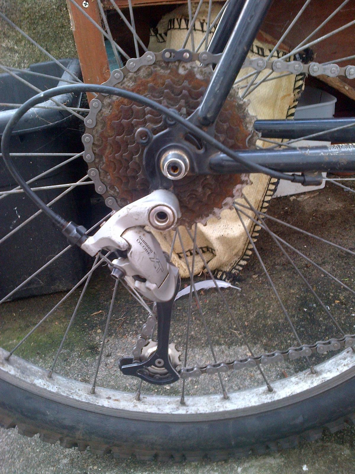

Martin Reynolds Posted August 21, 2012 Author Report Share Posted August 21, 2012 I'll try and get pictures up later, but they don't look worn, the teeth still have the correct square edges. Quote Link to comment Share on other sites More sharing options...
Martin Reynolds Posted August 21, 2012 Author Report Share Posted August 21, 2012 Picture of cassette Quote Link to comment Share on other sites More sharing options...
Luke Rainbird Posted August 22, 2012 Report Share Posted August 22, 2012 It's f**ked, replace it But seriously, some pretty worn teeth and looks like it's been left in a canal for an age - get a new one on there. Quote Link to comment Share on other sites More sharing options...
Martin Reynolds Posted August 23, 2012 Author Report Share Posted August 23, 2012 Thats like one day's rain in cornwall Hint taken, ordered a new one yesterday Quote Link to comment Share on other sites More sharing options...
ross87 Posted August 25, 2012 Report Share Posted August 25, 2012 Also in that picture you posted the top jockey wheel of the mech is too far away from the cassette which will add to the shifting problems. Try undoing the tension screw on the mech to move the jockey wheel closer to the mech. Hope this helps Quote Link to comment Share on other sites More sharing options...
Martin Reynolds Posted August 25, 2012 Author Report Share Posted August 25, 2012 Not one bit New rear cassette arrived and fitted, it was about 80% working. Still had issues with the rear mech, theres bugger all tension so i think the springs on its way out. Found an old mech and fitted it, just need to dial it in, but i got rained out today Quote Link to comment Share on other sites More sharing options...
bike_dummie Posted August 25, 2012 Report Share Posted August 25, 2012 Isn't that chain too long and needs to be shortened as the deralieur should be closer to a straight line then an L shape presuming it is on the largest chainring upfront. Quote Link to comment Share on other sites More sharing options...
Martin Reynolds Posted August 25, 2012 Author Report Share Posted August 25, 2012 Isn't that chain too long and needs to be shortened as the deralieur should be closer to a straight line then an L shape presuming it is on the largest chainring upfront. I've taken one link out since that picture,i dont think it was on the largest front chainring Quote Link to comment Share on other sites More sharing options...
Martin Reynolds Posted August 26, 2012 Author Report Share Posted August 26, 2012 With a new rear cassette, and taking two links out of the chain, it seam's spot on. Thanks for everyone's help, cheers guys 1 Quote Link to comment Share on other sites More sharing options...
