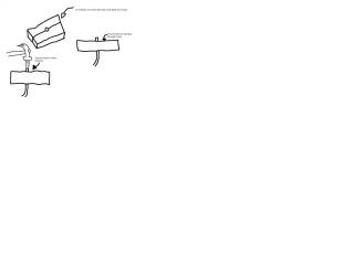

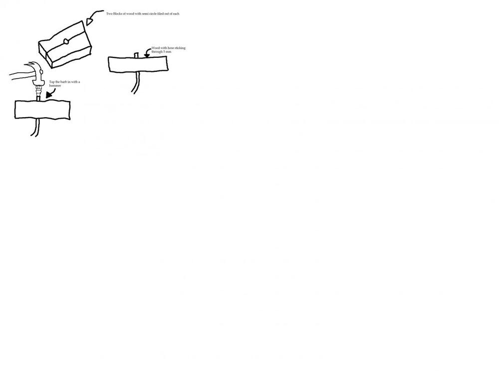

BradJohnson Posted August 17, 2012 Report Share Posted August 17, 2012 Two blocks of wood, use a rat tail file to file a slight semi circle out of each piece of wood, clamp the hose between the two pieces of wood so the hose sticks through 5mm then tap the barb in with a hammer. Quick sketch on paint below. 1 Quote Link to comment Share on other sites More sharing options...
