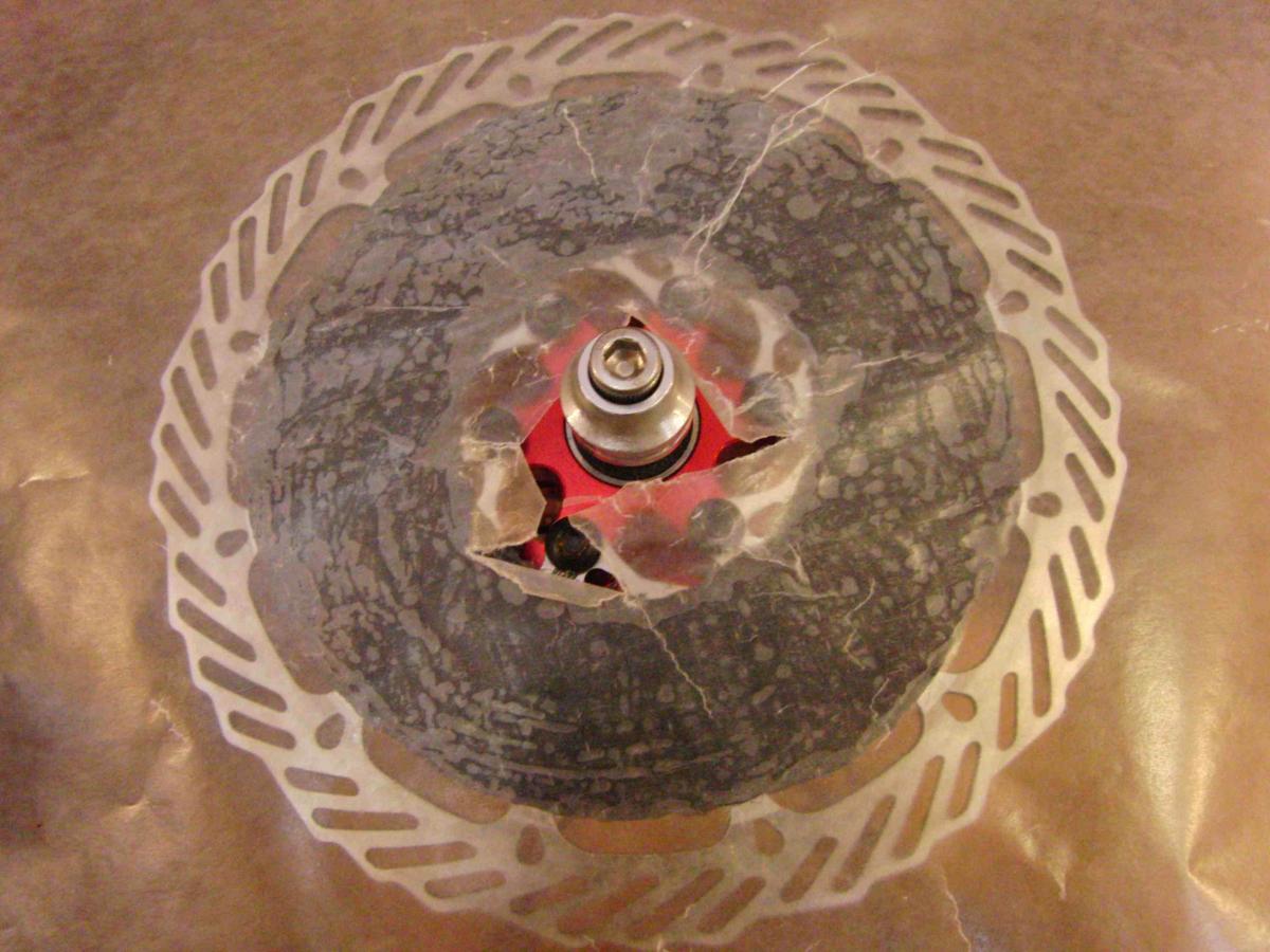

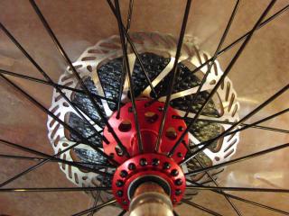

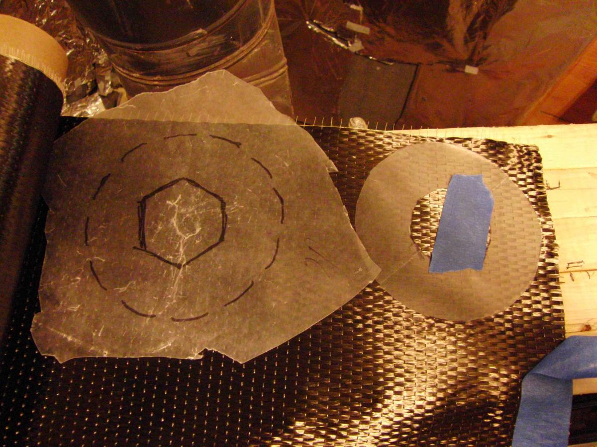

Pazu Posted August 26, 2012 Author Report Share Posted August 26, 2012 (edited) So here's a rotor guard proof of concept. It is a crude first try. I learned a lot about carbon fiber cloth, and came up with lots of "better approaches" toward fabricating these, while I was doing this. It is unidirectional carbon fiber cloth and West System G5 epoxy. My circles didn't translate well from the template to the carbon fiber, and I could do with less space between the outer circ. of the rotor guard and the rotor, but my brakes seem to be mounted too close to the hub so I can't get much closer. The pads come in too close to the inner edge of the working surface of the rotor, to close up that gap completely. The epoxy is still hardening. I feel comfortable that this rotor is less dangerous than a completely exposed rotor. The guard for the rear rotor will have a cleaner look than this first one. Can't wait to test it out! Edited August 26, 2012 by Pazu 1 Link to comment Share on other sites More sharing options...
