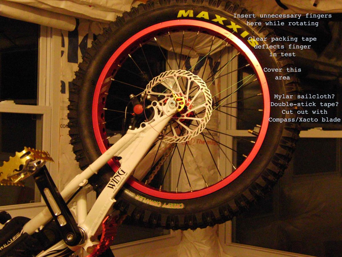

Pazu Posted August 15, 2012 Author Report Share Posted August 15, 2012 (edited) I wonder if this has been invented or suggested yet, I could not find it in a search. If done before, it bears repeating. Would be good for kids bikes. Here's a vid of my push test. Wouldn't be hard to tape a brake disc that was off of the hub, with a template of the circumferences involved. Clean it. Tape with overlaps across wax paper with packing tape, use the template to cut away the excess with Xacto knife. Peel away the wax paper then stick it on the outside facing of the disc. That's what I did, yes it's very crude because MY F'N FINGER IS IN A BANDAGE I decided that I would work on my bike with my riding gloves on now... No, they are not fingerless. Edited August 15, 2012 by Pazu Link to comment Share on other sites More sharing options...

Revolver Posted August 15, 2012 Report Share Posted August 15, 2012 This isn't that big an issue. What you do, and you'll kick yourself when you see how simple it is, is not put your fingers in a spinning disc brake. Easy as that. I might add that spokes are just as deadly, should we get rid of them? 3 Link to comment Share on other sites More sharing options...
Martin Reynolds Posted August 15, 2012 Report Share Posted August 15, 2012 What you do, and you'll kick yourself when you see how simple it is, is not put your fingers in a spinning disc brake. This! I refer to my earlier comment of natural selection. If you put your finger in a sharp spinning metal disc, you get what's coming to you. Its not bad design, it's you being a f**king moron! Link to comment Share on other sites More sharing options...

Pazu Posted August 15, 2012 Author Report Share Posted August 15, 2012 (edited) LoL Revolver and Martin thank you for pointing out the obvious though it is not myself that is my concern; I've already learned the lesson here. It is others. Such as my two sons. Such as the woman missing finger and bone, from the earlier example in this thread. The kids at the skate park. Jamming a finger in a hand spun spoked wheel would have no effect, it is not the same thing. A disc brake is the same design as a meat grinder blade and works as effectively. Why do I have an exposed meat grinder blade on my bicycle... Overstating the obvious, don't put your finger there, yep that works, and it's always fun to call someone a f**cking moron, but keep in mind that there's lots of curious fingers out there. The only fingers under your control, are your own. Taping off a disc, lessens risk for others. Not saying that it's any big deal. Just that a potential solution is out there. Edited August 15, 2012 by Pazu Link to comment Share on other sites More sharing options...
Dan_Trials Posted August 15, 2012 Report Share Posted August 15, 2012 Making things so that you can fumble along and stick your fingers any where and not get them chopped off is not really a good thing. It makes people less aware of what they are doing, so they don't have to see things or pay attention to what is going on. Link to comment Share on other sites More sharing options...
Pazu Posted August 15, 2012 Author Report Share Posted August 15, 2012 Making things so that you can fumble along and stick your fingers any where and not get them chopped off is not really a good thing. It makes people less aware of what they are doing, so they don't have to see things or pay attention to what is going on. You seem to be suggesting that mechanical safety measures lead to carelessness. I would have to agree to disagree on that one, I do not think that there is a measurable correlation. Do you have an example of this to cite? There are on the other hand myriad examples of safety measures that have led to reduction in accidental injury, in about every field of human endeavor. We are all differently abled in terms of ability to interpret new situations and anticipate danger. Children don't have the experience discipline or mental development of an adult and so by definition are much more vulnerable to dangers such as this. Adults are prone to distractive secondary behavior such as drinking, sparking one etc. I am not judging this behavior, merely pointing out that altered states are common. This also makes people less aware of what they are doing. A protective mylar sticker over the chopping area of a brake rotor cannot in and of itself promote distractive behavior. I know that I am a very risk-averse person and understand that this is not an issue for an experienced mechanic or rider. It is getting through the NEWB stage with fingers intact that motivated me to think further about it. Again, we are talking about fingers of people here. Anyhow, I've called SRAM/Avid regarding the idea. They could easily have a product such as this on the market in no time. They would just call their sticker supplier with some dimensions & it would be done. So I'm pissed off at having cut myself on the rotor, fair enough but it's not about me it's about future riders and wanting to promote safety in an thrilling sport that I enjoy. Something so simple, lightweight and not performance-affecting, could have prevented this bloody injury of mine. I felt it worth mentioning, is all. Link to comment Share on other sites More sharing options...

Pazu Posted August 15, 2012 Author Report Share Posted August 15, 2012 You're riding a bike with no seat and an exposed drivertrain up and off walls and rails, so bigging up the whole "It's a massive safety issue" thing is pretty moot. I've got friends who've caught fingers in discs before though - it's a bitch for sure. Well I didn't call it "massive," just one way of avoiding one specific issue that doesn't come up much. I suppose that I have gone on, a bit... It is not critical. Surely I'm not the only one thinking about new products for the sport? Perhaps I'm the only one thinking about dumb, unnecessary products... I just think that somebody's momma would buy one of these for her kids' bike in a heartbeat, at the mere mention of it. And that's more work for the lbs, maybe advertising if there's print on it, could bring in other sales, I don't know. What can I say, I am a Noob, that's my excuse! Link to comment Share on other sites More sharing options...
Topsy Posted August 15, 2012 Report Share Posted August 15, 2012 Well if you're aiming at kids, you could just as well develop some plastic guards that "snap" into the rotor. You could have it in all colours 1 Link to comment Share on other sites More sharing options...

Pazu Posted August 15, 2012 Author Report Share Posted August 15, 2012 (edited) Well if you're aiming at kids, you could just as well develop some plastic guards that "snap" into the rotor. You could have it in all colours Yeah that could work, rotors come in lots of different styles, would have to cast ones for every style I suppose... So I heard back from SRAM/Avid, talked to a product development guy there, he says he will bring the idea to the table and see what other people think. His first thought was that rotors get to 400 F, good point but I pointed out that I was targeting trials riding & kids. I mentioned that high heat mylars and adhesives are out there. So I didn't get the "we can work with you on this" response that I had hoped for, but hey the guy was very decent and thoughtful on the phone so who knows. He gave me his email address to send my pic & link. I've checked & it appears that mylar film can handle 200 C, 392 F so it might work even then. I know from other experimentation that plastic films are okay conductors of heat and so the majority of the film would stay comparatively cool, and might even contribute to dissipating heat off of the rotor which if true would add to the positive rationale for the potential product. Edited August 15, 2012 by Pazu 1 Link to comment Share on other sites More sharing options...
