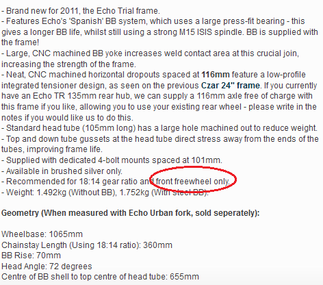

SunnyBoy Posted July 31, 2012 Report Share Posted July 31, 2012 (edited) I'm assuming its got horizontal dropouts? If it does, I don't think you can run a 135mm hope as they're designed for vertical, you'd have to go with one of the fixed 135mm rear hubs with snail cams. Might be wrong though. Although, saying that, I've just realised there's built in grub screws that can position the rear hub fine. . Might be OK to run a hope after all. Edited July 31, 2012 by SunnyBoy Quote Link to comment Share on other sites More sharing options...

Azarathal Posted July 31, 2012 Report Share Posted July 31, 2012 I'm running a King in the back of mine without issues, I think it used to/still advises against it on the Tarty website but thats only due to chainline issues which you can sort out using the correct sprocket on the cassette body. Quote Link to comment Share on other sites More sharing options...
aener Posted July 31, 2012 Report Share Posted July 31, 2012 I'm assuming its got horizontal dropouts? If it does, I don't think you can run a 135mm hope as they're designed for vertical, you'd have to go with one of the fixed 135mm rear hubs with snail cams. Might be wrong though. Although, saying that, I've just realised there's built in grub screws that can position the rear hub fine. . Might be OK to run a hope after all. For future reference, that's absolute rubbish Hahaha. You DEFINITELY can run a ProII in horizontal dropouts. If it's a question of cams - which in this case doesn't matter as you have the bolt tensioners - you just need to turn the bolts around and run them on the outside. Quote Link to comment Share on other sites More sharing options...
AdamR28 Posted July 31, 2012 Report Share Posted July 31, 2012 I think it used to/still advises against it on the Tarty website Hmm, nope and nope! Probably one of the better hubs to run really. Quote Link to comment Share on other sites More sharing options...

Mark W Posted July 31, 2012 Report Share Posted July 31, 2012 Nah, that's more to do with most front sprockets hitting the BB yoke rather than the Pro 2 not being suitable for use with it. You can get it to work, but it generally involves having to use random gear ratios and one specific type of sprocket. As a result, it's just recommended for FFW use. Quote Link to comment Share on other sites More sharing options...
SunnyBoy Posted July 31, 2012 Report Share Posted July 31, 2012 (edited) For future reference, that's absolute rubbish Hahaha. You DEFINITELY can run a ProII in horizontal dropouts. If it's a question of cams - which in this case doesn't matter as you have the bolt tensioners - you just need to turn the bolts around and run them on the outside. If you'd read properly, I'd corrected myself.... Edited July 31, 2012 by SunnyBoy Quote Link to comment Share on other sites More sharing options...
AdamR28 Posted July 31, 2012 Report Share Posted July 31, 2012 Yeah, that's to make the description 'tard-proof. 1 Quote Link to comment Share on other sites More sharing options...
