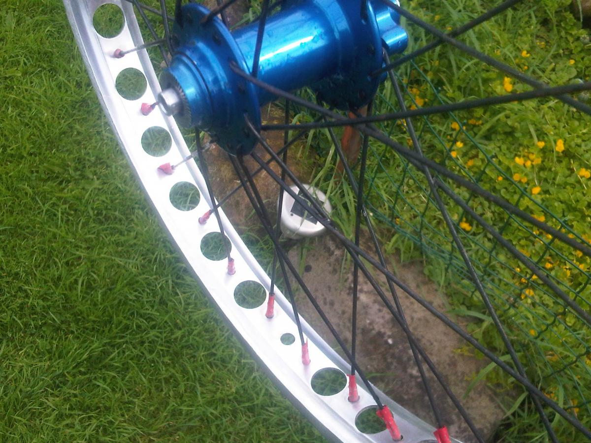

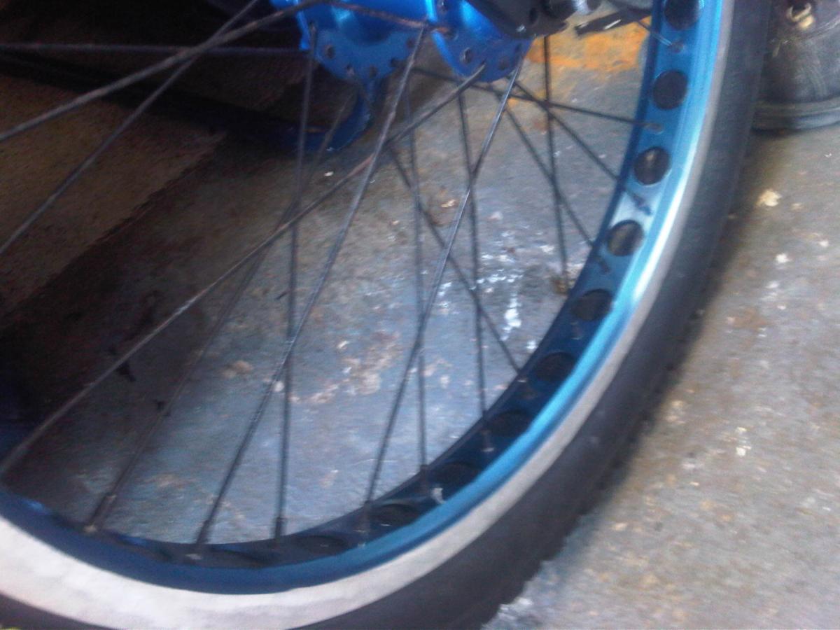

CalRobbo341 Posted July 29, 2012 Report Share Posted July 29, 2012 So I have had this thought in the back of my head for a while, rawing some parts. I want loads of new parts but money is tight, so I thought maybe just raw the front wheel, for now, as I don't like the blue and it would look a little nicer. So this is the stuff I would use (http://www.boots.com/en/Boots-Caustic-Soda-500g_923900/) but as the front wheel has a grind would that effect anything, and I wouldnt take it apart, so would a plastic bag do the trick, over the spokes? I think I would also go over the cranks and the forks as there rather battered. How many bottles do you think I would need? And then when I eventually get a job, I would do it up how I really want it! Thanks. EDIT - If anyone could like mock it up on photoshop, would appreciate it. Quote Link to comment Share on other sites More sharing options...

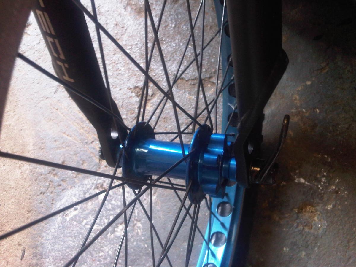

CalRobbo341 Posted July 31, 2012 Author Report Share Posted July 31, 2012 Okay, just ordered some now, d'you think I will be able do the front hub too? Like again without getting it on the spokes? Wrap the spokes with tape or something, idk? Quote Link to comment Share on other sites More sharing options...
Azarathal Posted July 31, 2012 Report Share Posted July 31, 2012 (edited) If the spokes are painted it should be fine Edited July 31, 2012 by Azarathal Quote Link to comment Share on other sites More sharing options...

CalRobbo341 Posted July 31, 2012 Author Report Share Posted July 31, 2012 If the spokes are painted it should be fine The rim is anodised, the spokes I don't know about and the hub is a Hope bulb? I think. I may do the spokes or if there is enough (ordered 1kg of it) i may just do it in a small bath and dip the whole of the wheel in, then scrub it till its silver. also may just do the rear Echo TR rim, again if there is enough! Thanks for everything! Quote Link to comment Share on other sites More sharing options...
Ali C Posted July 31, 2012 Report Share Posted July 31, 2012 Caustic soda doesn't touch steel so the spokes will be fine. I've done wheels before, all I did was mix a batch of caustic soda and use a toothbrush to brush it on the rim/hub, leave for a few moments and wipe off with a rag/clean water. don't worry about going over the same bit twice, it may make the alloy go a funny colour, but a bit of wire wool will bring it to a decent finish. 1 Quote Link to comment Share on other sites More sharing options...

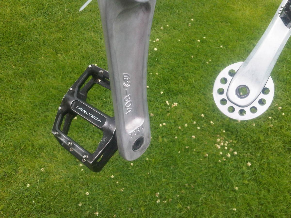

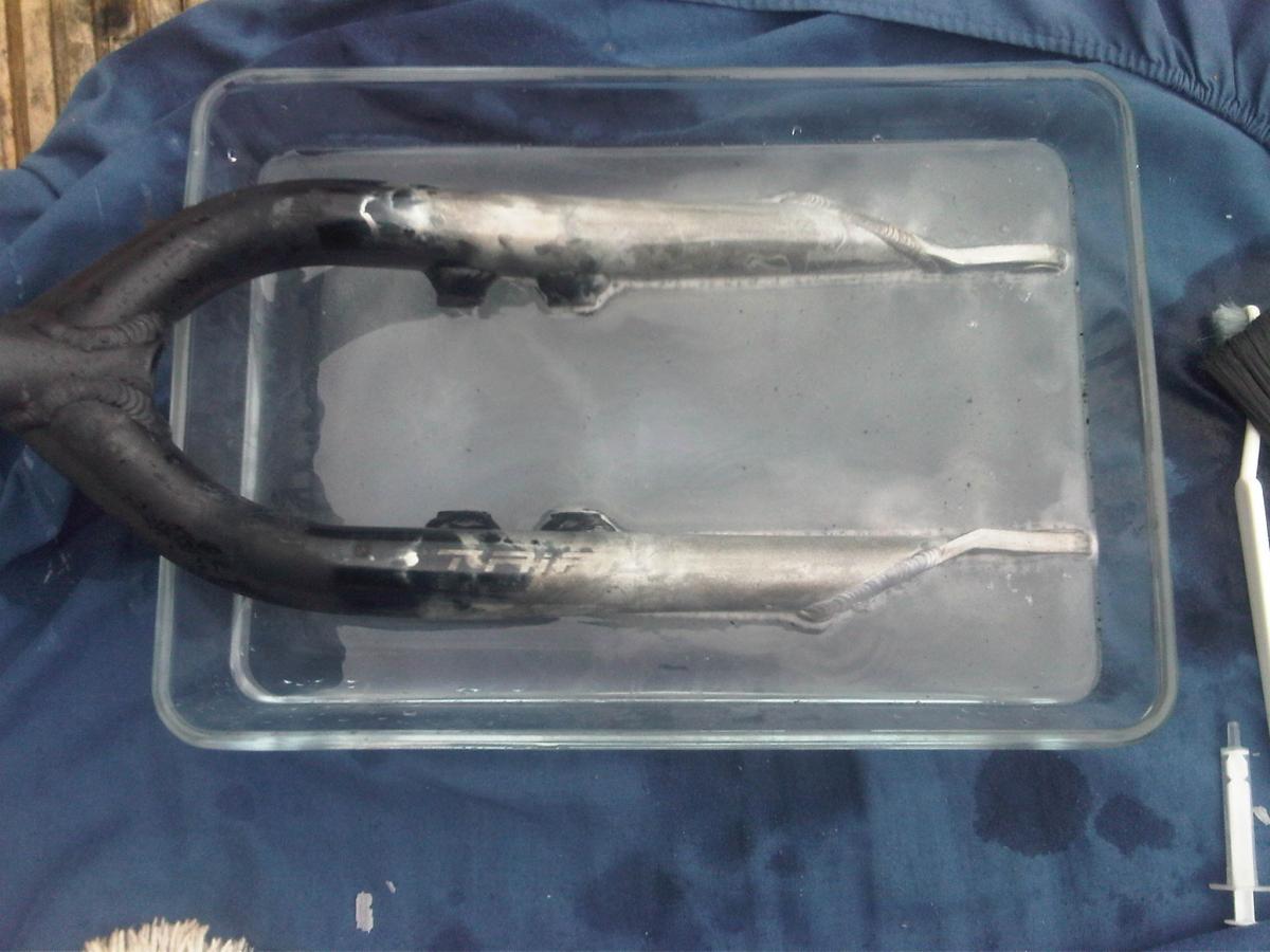

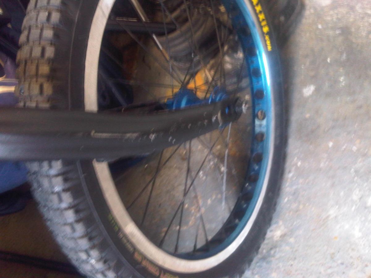

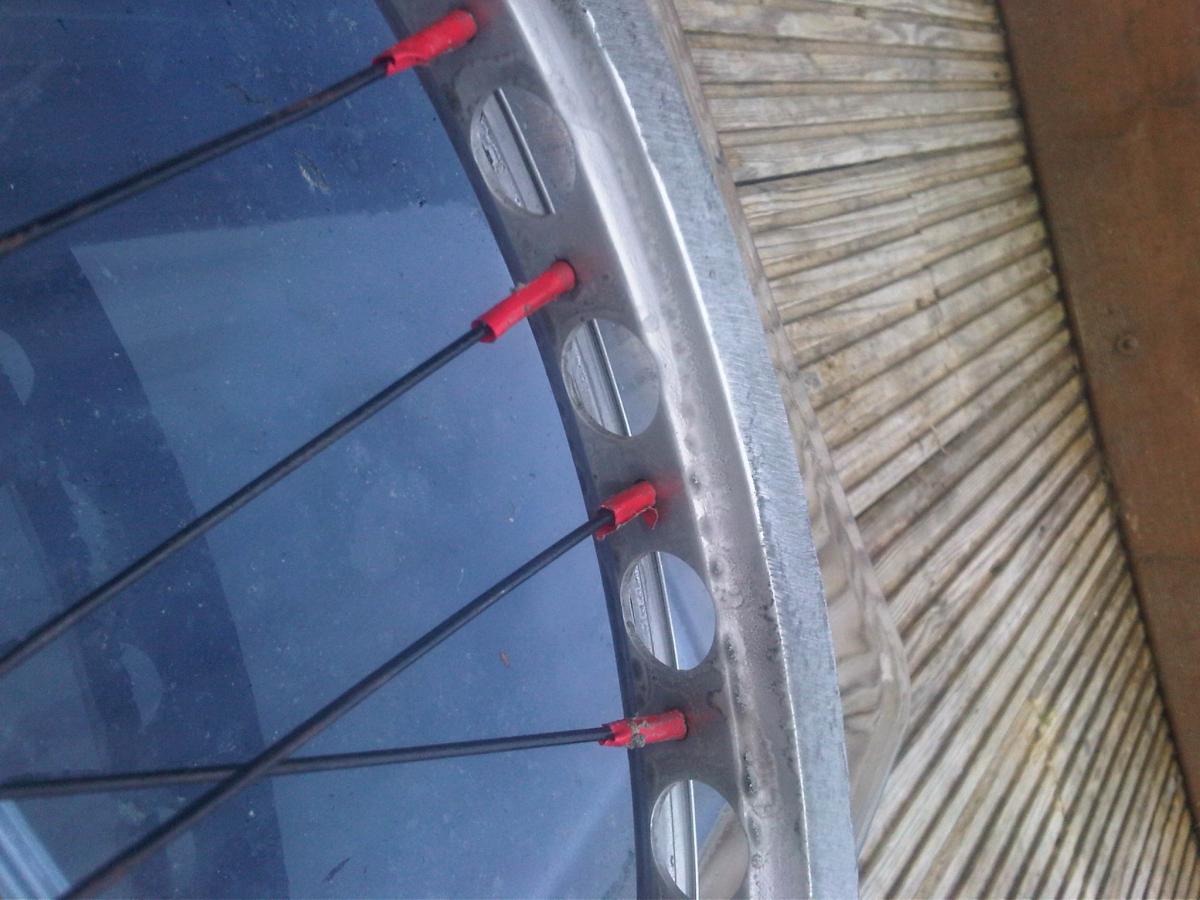

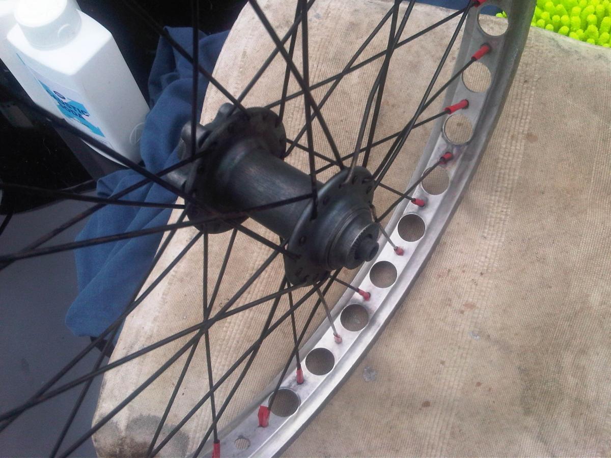

CalRobbo341 Posted August 3, 2012 Author Report Share Posted August 3, 2012 Should I change the batch that I am using now when I go to do the cranks? Done the front rim, just having a quick break, then back to it! Opinions on what else I should do? Forks, rear wheel, anything else? Ignored what you said about the spokes Ali, only because I had already done them, but they survived! Cheers. Quote Link to comment Share on other sites More sharing options...
TRIAL-bike-MATT Posted August 3, 2012 Report Share Posted August 3, 2012 Should I change the batch that I am using now when I go to do the cranks? Done the front rim, just having a quick break, then back to it! Opinions on what else I should do? Forks, rear wheel, anything else? Ignored what you said about the spokes Ali, only because I had already done them, but they survived! Cheers. Looks good, did you go round it with some fine wire wool and polish? I done my forks and all the orange bits on my echo yesturday, i just use the same batch for everything than wipe it off after. It works much quicker mixing the caustic soda in boiling water Quote Link to comment Share on other sites More sharing options...
CalRobbo341 Posted August 3, 2012 Author Report Share Posted August 3, 2012 Didnt do the driveside cranks to its maximum on the back, couldnt get to it that well... Hope hub proving to be rather tough! Changing batch after had some lunch, hopefully should do the trick! Serious opinions on wether to do the forks or rear wheel? Or both! Looks good, did you go round it with some fine wire wool and polish? I done my forks and all the orange bits on my echo yesturday, i just use the same batch for everything than wipe it off after. It works much quicker mixing the caustic soda in boiling water Posted at the same time as me broo! Doing cleaning up with wire wool, cloth and some polish when everything is done. Quote Link to comment Share on other sites More sharing options...

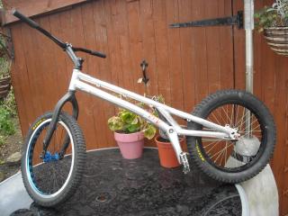

niconj Posted April 10, 2016 Report Share Posted April 10, 2016 (edited) Will try this on my Rockman. Bought some Hashtagg Cranks and they will have to match the frame color. Too bad I cannot raw the forks and handlebar. Would really like a complete silver bike. There are also no silver rims available anymore except the Trialtech and these don't really give a good brake performance in my pov. Rockman Gabbro V-Brake¹ by niconj, auf Flickr Edited April 10, 2016 by niconj Quote Link to comment Share on other sites More sharing options...
