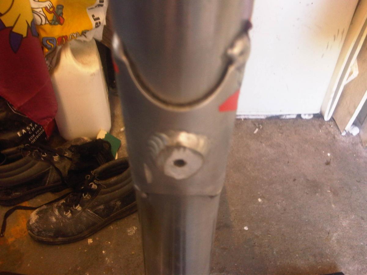

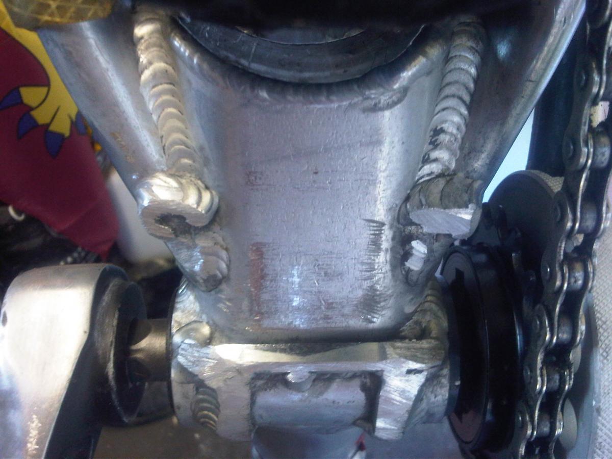

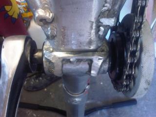

Boggles me how clean and nice yours looks! Got a grinding disc yday and attempted to clean it up a little, also used an old file and not sandpaper / wet & dry..
Pictures -
post-30770-0-49113800-1343119492_thumb.j
post-30770-0-64727400-1343119497_thumb.j
post-30770-0-25127200-1343119502_thumb.j
I wouldn't really bother with your frame Laurence, if you wanted to save weight from the frame the best way to do it is get a new frame that's not a because. The other trials 24" frames are all around 1400-1500g.
You'd knock off 100g at the most if you're lucky :( worth doing the headtube though, the seat tube and pedals seem a bit more risky in my opinion, but I've never done it. :P
