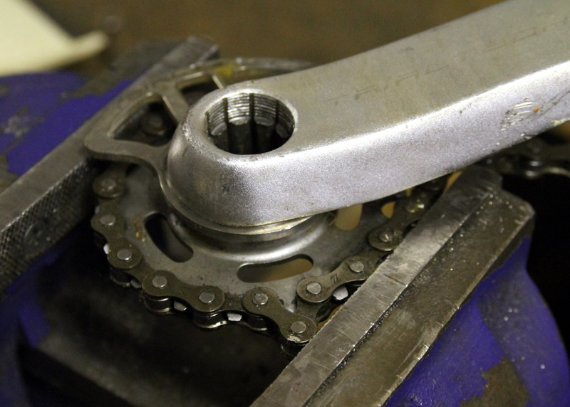

AdamR28 Posted July 23, 2012 Report Share Posted July 23, 2012 I've been tapping it with a screwdriver from the other side for a good 20 minutes with no joy. I had to bend the screwdriver to make sure the tip of it hits the race because it's such an awkward position to get in at. That should work, but get the sprocket off if you can, at the moment it'll be compressing the hub shell and bit and making the bearing tighter: http://www.tartybikes.co.uk/media/guides/maintenance_freewheel_and_sprocket_removal/m1.html Quote Link to comment Share on other sites More sharing options...

davidbarr Posted July 23, 2012 Author Report Share Posted July 23, 2012 I can't get the sprocket off. Got the vice as tight as I can but the chain is slipping. I'll look into getting someone to weld some tabs onto it as that sounds like a good idea. Thanks guys. Quote Link to comment Share on other sites More sharing options...
AdamR28 Posted July 23, 2012 Report Share Posted July 23, 2012 Try this: 1 Quote Link to comment Share on other sites More sharing options...
davidbarr Posted July 23, 2012 Author Report Share Posted July 23, 2012 Ended up splitting the bench my vice is attached to trying to take the sprocket off so gave up on that Eventually managed to bash the race out with a slightly larger screwdriver. Happy days! Thanks for all the help guys Quote Link to comment Share on other sites More sharing options...
Maxx Posted July 23, 2012 Report Share Posted July 23, 2012 Try this: I did this in the past and I crack the sprocket (between teeth) because the vice was too tight (but I had no choice, it slipped). The sprocket wasn't touching the vice, but the chain pushed on it, and it cracked. The video's method (only chain held in the vice) always works great for me. Quote Link to comment Share on other sites More sharing options...
