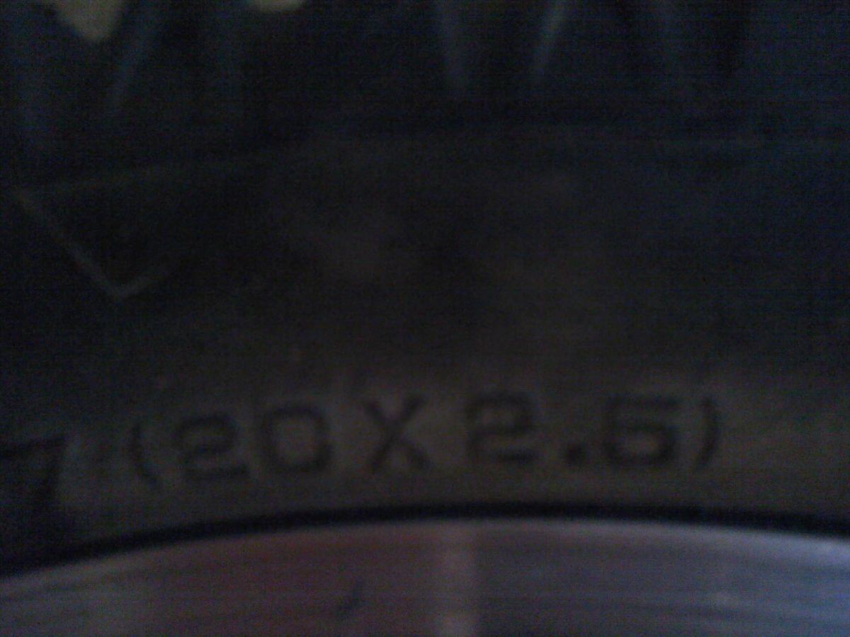

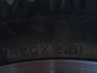

Cap Posted July 14, 2012 Report Share Posted July 14, 2012 i have a 20" on the back and i have a maxxis creapy crawler 2.5 and it works fine I'm going to bet you have a 19" on the back Please note: This tyre is marked as 20" x 2.50, but it is to fit a 19" rim! The marking on the tyre refers to the outer diameter of the tyre once inflated on a rim. 1 Quote Link to comment Share on other sites More sharing options...
danrobinson Posted July 14, 2012 Report Share Posted July 14, 2012 Pics or it didn't happen told youmy rim is the same size as the front Quote Link to comment Share on other sites More sharing options...
Cap Posted July 14, 2012 Report Share Posted July 14, 2012 told you my rim is the same size as the front Measure it Quote Link to comment Share on other sites More sharing options...
danrobinson Posted July 14, 2012 Report Share Posted July 14, 2012 (edited) i measured it then and it said 16inch so i think i did something wrong the wheel is the same as my front Edited July 14, 2012 by danrobinson Quote Link to comment Share on other sites More sharing options...
isitafox Posted July 14, 2012 Report Share Posted July 14, 2012 I can absolutely guarantee that the rear is smaller than the front. They may be the same make and model of hub and rim but the rear is absolutely positively a 19" rim. Not trying to take the piss or make you look bad or owt dude but you do not have a 20" rear wheel. 1 Quote Link to comment Share on other sites More sharing options...
danrobinson Posted July 14, 2012 Report Share Posted July 14, 2012 okay, i still think there the same size though Quote Link to comment Share on other sites More sharing options...
isitafox Posted July 14, 2012 Report Share Posted July 14, 2012 3 Quote Link to comment Share on other sites More sharing options...

isitafox Posted July 17, 2012 Report Share Posted July 17, 2012 (edited) The 20x2.0 is a 20" tyre as it's for the front but the 20x2.5 is actually to fit a 19" rim. Says in the description; Maxxis Creepy Crawler Trials Tyre The first offering in the trials arena from Maxxis, with specifications to meet the needs of the most demanding rider: the Creepy Crawler front specific trials tire offers a supple ride, with excellent traction that gives you the confidence to make the leap. The Creepy Crawler rear trials tire provides discerning riders with ultimate control for edging, smearing and all around trials dominance. The 25 TPI casing of the rear tire provides a slow dampening feel while protecting against pinch flats. The Maxxis Creepy Crawler is the best trials tire available on the market today. Block tread design Front and rear specific modified trials tire Features: Rear tire is built on 67-387 casing (19”)Front tire is built on 54-406 casing (20”)Block tread design Please note the 20 x 2.5 is designed to fit a 20inch Mod Trials Bike rear wheel. Although classified as 20inch the rim diameter is 19", therefore the tyre will not fit a regular 20inch rim. Edited July 17, 2012 by isitafox Quote Link to comment Share on other sites More sharing options...

onza pro series guy Posted July 17, 2012 Report Share Posted July 17, 2012 (edited) CONFUUUUUUUUUUUUUSED DOOOOOT COM >.< Generally 20" trials bikes have 19" rear rims, it's just the way it is for perfomance reasons. However so that people understand that they are buying the correct tyre for their 20" bike some tyres may be refered to or stamped as 20", to stop people thinking there is a differance between 19" and 20" bikes; there is not because obviously 19" bikes don't exsit. This is why 20" wheel-ed bikes are normally refered to as 'mods' which comes from modified in that the rear wheel is different in diameter to the front, which was a modification that used to have to be made to bikes before there were any specific bikes for trials. However all you need to know is that your rear wheel IS 19", although it might say 20", this is so that it is easier for people to purchase the correct tyre for their bike as, generally, 19" wheels are rather unheard of. I t's really not that hard to grasp. Edited July 17, 2012 by onza pro series guy Quote Link to comment Share on other sites More sharing options...
