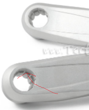

ogre Posted August 3, 2012 Report Share Posted August 3, 2012 don't remove the crank arms, just pop the bolts out, and take a photo of how it looks without the bolt in ideally your bb axle will come right up to the point where the arrow is pointing in the image below: i'd advise you try an get the cranks on the bb to this point before riding any more. Don't worry about all the safety gear, your being ridiculous, your only learning, your at ground level all the time, and your guna be falling no harder than if you loose your balance, the back pain you will experience is from the muscles in your back being used properly for the first time in a while, it's normal and it'll go, the only safety gar that makes allot of sense right now is a helmet and shin guards if you don't want gnarly scars... it's not like downhill where your pagering about at high speed, trials is a comparatively slow and safe sport... Quote Link to comment Share on other sites More sharing options...

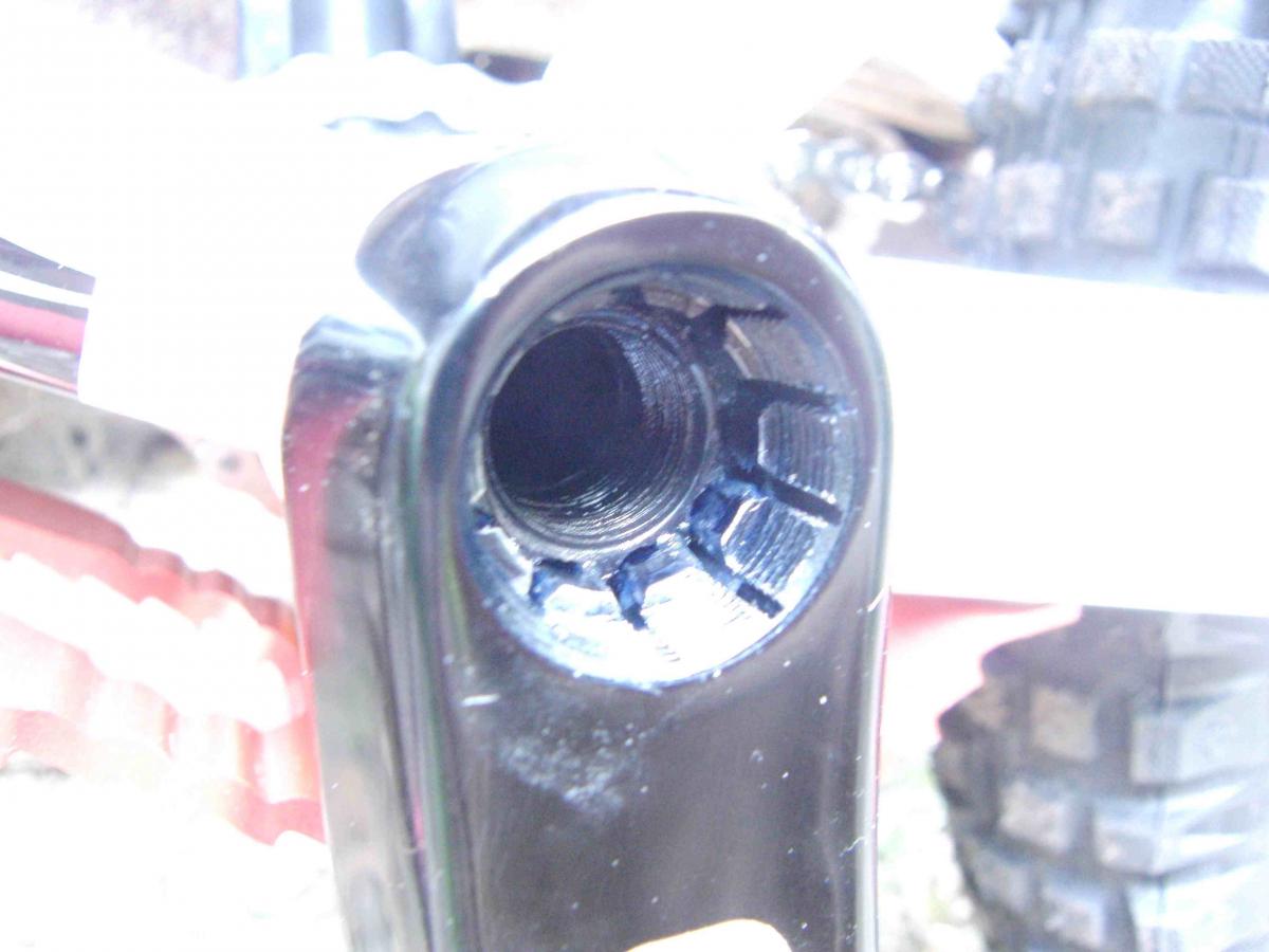

Pazu Posted August 3, 2012 Author Report Share Posted August 3, 2012 (edited) Hey Ogre here's a shot of one side. It appears to me, that this is nowhere near seated to the mark on your picture. Could be 1/4" off or more. Edited August 3, 2012 by Pazu Quote Link to comment Share on other sites More sharing options...
ogre Posted August 4, 2012 Report Share Posted August 4, 2012 (edited) i wish i could nip downstairs and check on my bike and remind myself how an isis set up looks when it's 'normal' but it's not here to check, unless the bit of material showing is somehow tapered inwards to act as a stoper that don't look right, the other thought would be, does that amount of taper thats left out, match the amount of BB left to be covered? in my experience isis cranks usually slot onto the bb like it's meant to be and just need nipping up, i wish someone else would give a second opinion on this thread though. on the flip side i've enjoyed dumping everythign i can think of in a thread... re the gear comment, i'm a 20 something so i guess i'm happy with scars and wounds, and i've never considered how others may perceive it, and i'm frugal as hell to boot, but i can see why you take your well being a bit more seriously. to be fair i don't see trials as all that dangerous, i'm the only rider in my circle of main riding friends who's had a proper injury, and i only know one other guy who's broken themselves properly in trials and he's riden even longer than i have, so bear in mind that injuries in trials are pretty rare and don't think about it to much! Edited August 4, 2012 by ogre Quote Link to comment Share on other sites More sharing options...
Pazu Posted August 4, 2012 Author Report Share Posted August 4, 2012 Well thanks for accommodating the weird language and for generally trying to help out, you are setting a good example and it has made a big difference in my figuring out my mod. I broke my leg in the street on a mountain bike when I was 20, I'll have to check for a "crash stories" thread on here, I've got a few. 3 mild spills today, just had a helmet, terrain was steep class 6 dirt road, partially washed out. I'm just riding the bike, F it, if it breaks then I'll stop. I think the BB is just wrong for the crank arms. I may pull them and take pics through the crank arm but I think it's just milled straight through. I might be able to mill the hole slightly larger to correct the issue but first I'll try these crank arms on the new BB that Topgears is sending, they might work fine on that BB. Anyhow my hop is higher than ever and balance is getting more focused, I feel pretty good for basically day 2. Quote Link to comment Share on other sites More sharing options...
