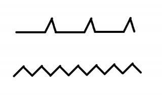

It's probably a result of how you ground your rim. Chances are the brake was amazing at first because the different method created a few spread out and/or really sharp points on the grind. Being sharp and/or spread out these points will dig into the pad really well, and give amazing bite. Trouble is, if they're sharp then the tip of them isn't supported as well as a blunt point would be, so will blunt easily, and if they're spread out too, then each point is taking more load, again, causing it to blunt easily.
Paint has provided me with a shonky simplified diagram to explain my point:
post-4312-0-65704000-1341910689_thumb.pn
The top one will bite amazingly, but wear very quickly, while the bottom one will be less impressive to start off with, but will hold it's sharpness much longer.
I'd suggest going back to your old method of grinding if that worked for you, or following tutorials if you're wanting to try and improve on it.
