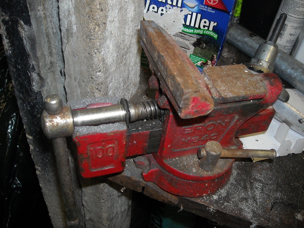

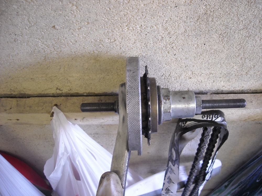

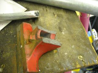

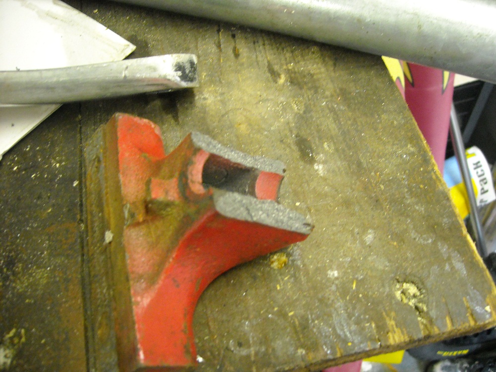

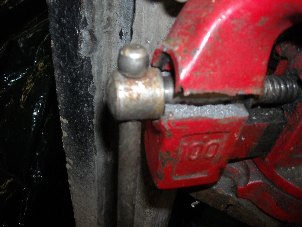

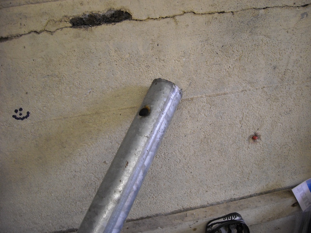

CalRobbo341 Posted July 4, 2012 Report Share Posted July 4, 2012 So I thought I would save myself a few bob and take my freewheel off instead of sending to Tarts with it on and then them changing it. Anyway, I got it all setup using an old rear hub axle, then the crank, then the freewheel tool, then a spacer and a bolt, got the vice and put it in (giggity) got a pole off of the trampoline and then kapow! SNAP! Poor vice, I put hardly any pressure on it and it went... So yeah anyway just thought I would share! Also when sending it to Tarty, should I send the freewheel I want on the cranks, bashring and the current cranks? I also have a gold ring of a spare driveside crank, should I send that along? Cheers Quote Link to comment Share on other sites More sharing options...
harmertrials Posted July 4, 2012 Report Share Posted July 4, 2012 That's the 4th vice I've heard of snapping in the past month or so (mine included). Just send the crank along with freewheel. You only need to wing your new one on hand tight. Quote Link to comment Share on other sites More sharing options...
RobinJI Posted July 4, 2012 Report Share Posted July 4, 2012 (edited) A friend did exactly the same thing to the vice at Halfords when we worked there, doing exactly the same job in the same way. It's a huge amount of force to put on the vice, and cheap/poor ones will destroy themselves from it. Edit, if you want to prevent doing it in the future you need to extend the flats on the freewheel tool somehow, so the leverage on the vice is decreased. My first thought would be to weld some thick plate to the tool, the same width as the flats on it, so it's clamped all the way down the vice's jaws, not just in the middle. Edited July 4, 2012 by RobinJI Quote Link to comment Share on other sites More sharing options...

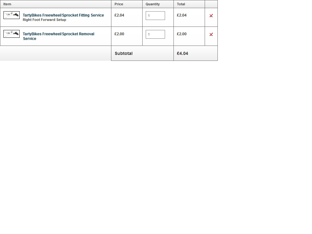

CalRobbo341 Posted July 4, 2012 Author Report Share Posted July 4, 2012 If you're sending one back for us to remove, don't worry about any fitting charge, just pop a note in and we'll do it Think we've only snapped one vice so far, but it was a £14 Tesco one or something As you do say in the video, a nice strong vice, And also, what about this Quote Link to comment Share on other sites More sharing options...
AdamR28 Posted July 4, 2012 Report Share Posted July 4, 2012 And also, what about this What about it? Sorry, I don't get it.... Quote Link to comment Share on other sites More sharing options...
CalRobbo341 Posted July 4, 2012 Author Report Share Posted July 4, 2012 What about it? Sorry, I don't get it.... don't worry about any fitting charge, just pop a note in and we'll do it So I don't have to pay for the fitting charge, also I still have to get the freewheel, waiting on a reply! Quote Link to comment Share on other sites More sharing options...
AdamR28 Posted July 4, 2012 Report Share Posted July 4, 2012 So I don't have to pay for the fitting charge That's what I said... Just put in the notes for us to fit the FW. Quote Link to comment Share on other sites More sharing options...
CalRobbo341 Posted July 4, 2012 Author Report Share Posted July 4, 2012 (edited) Eventually got freewheel off, just use a bigger vice. Yours was a much more heafty vice than mine too, aha! That's what I said... Just put in the notes for us to fit the FW. I am still confused, but I understand, alright cheers, as I say I still have to buy the freewheel first! as I say the freewheel has to be delivered! Edited July 4, 2012 by CalRobbo341 Quote Link to comment Share on other sites More sharing options...
