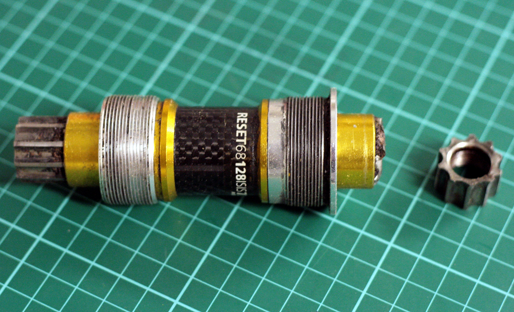

dave33 Posted July 5, 2012 Report Share Posted July 5, 2012 That's a fair point - didn't think of using my DTI. Thanks for the tip, I shall use that in future. Might help next time if you use one before trying to turn down the next axle The 6900 bearing I just checked has between 0.36mm and 0.40mm of radial float, so I don't see how that amount of run out in the hub shell would cause an issue? I am quite sure there isn't a single hub in our warehouse that is perfect in that respect. So now think about the distance between the bearing about 95mm away It's about 5/5mm just a bit over the tolerance you state? I don't know what gravity is like in Wales, but here in Preston it's 1G. I don't see how you were able to drop the bearings in. You may have been able to seat one of the bearings by hand, but you will notice that the hub came back with one bearing securely in place. We don't need to get all limits and fits here, but we both know by feel when a bearing has a satisfactory amount of resistance when being pressed home, and that one did. So most hubs you sell arnt fit for there purpose ? I wonder why some one came up with iso standards ? As you will know though, a few drops of Loctite 270 will sort this whole thing within 6 hours anyway. Personally, using a bit of common sense, I would have just done that months ago. I didnt by a hub to play with loctite. Maybe you should include that in the product discription ? but you cannot deny that it works fine. Urm no as you didn't replace the bearings! The original bearings broke because they were fitted wrong you said? So why not replace them ? Do all the hubs you have arrive with incorrectly fitted bearings ? Fitness for purpose - see section 14 of the Sale of Goods Act 1979, specifically subsection (2C)( a ) and those referred to within. This 'bull shit line about the manufactures (sic)' thing - I don't see why it's bad that, when we deem something to be outside of warranty, we'll liaise with the manufacturer to see if they'll help instead? If you choose not to take that help, that's your decision. So you admit you try to con people by telling them it's not up to you to replace the item ? Link to comment Share on other sites More sharing options...

Matt Vandart Posted July 5, 2012 Report Share Posted July 5, 2012 I'm not taking sides here at all but would like to make some points: First bearings if selected to the correct manufacturing specification for the intended purpose can in fact have no 'Service life' if maintained properly i.e lubrication, the alignment/environmental specs are met, then a bearing can last in effect, forever, or certainly a few human life times. This is obviously in the perfect hypothetical world, but they should be expected to last at least a year. The fact of the matter is that spherical bearings are not the best selection for this purpose, specific to trials, most bicycles would never have a problem as they are not being subjected to some serious radial loading, most importantly static radial loading. Just think of the radial loading on the front bearings in for instance a large gap to front, where the brake is locked tight on landing the front wheel. We must also take into consideration that the bearings are never fixed on both axial directions in bicycle hubs, the axial loading is therefore not properly controlled. As in the outer race is only fixed in one direction on each bearing. I havn't the time to write a lengthy explanation of why they are a shit choice (for the riders) for trials wheels so I will just be lazy and quote wiki which is rather lame but all i can be bothered with. [quote Failure modes If a bearing is not rotating, maximum load is determined by force that causes non-elastic deformation of balls. If the balls are flattened, the bearing does not rotate. Maximum load for not or very slowly rotating bearings is called "static" maximum load.[3] If that same bearing is rotating, that deformation tends to knead the ball into roughly a ball shape, so the bearing can still rotate, but if this continues for a long time, the ball fails due to metal fatigue. Maximum load for rotating bearing is called "dynamic" maximum load, and is roughly two or three times as high as static maxload.[3] If a bearing is rotating, but experiences heavy load that lasts shorter than one revolution, static maxload must be used in computations, since the bearing does not rotate during the maximum load.[3]] 1 Link to comment Share on other sites More sharing options...
monkeyseemonkeydo Posted July 5, 2012 Report Share Posted July 5, 2012 no-one has given a reasonable explanation as to why the bearings failed in the first place, merely 'why we are not to blame' For instance the allegedly machining issue, if that is within spec for these particular bearings and it isn't the reason they failed, then that is all well and good but does not answer why they did fail. Bearings are serviceable items though and will inevitably be 'off the shelf' units chosen for their price:performance by the manufacturer. When sold, any hub may have a dodgy bearing in it which will have a shorter life than designed but because they are replaceable that's life really. We all know trials is hard on components so a dead bearing every now and then should be considered an inevitable issue that you have to deal with. Most of us, especially those with a little mechanical knowledge/skill (you'd think), would just order a new bearing from eBay Tarty and replace it but it seems like certain individuals would rather shoot themselves in the foot by stripping the wheel down, sending the hub back then acting like a spoilt brat when he doesn't get the outcome he'd hoped, even after Adam's gone out of his way to 'make good'. You are right though that Dave comes across as mad as a box of frogs. There is a very real possibility that some products supplied to yourselves are in fact sub standard, manufacturers can and will sell shite that has not been designed/manufactured or tested PROPERLY to make money because at the end of the day, as we can see here, it is you and not the manufacturer that the shit will stick to. That's really the nature of a lot of the trials world though. There's a lot of stuff which is mass produced in Taiwan/China or wherever where you can guarantee the QC checks and tolerances aren't quite as good as somewhere like Hope (ignoring a certain fluid retention device!) but you accept that when you pay half the price of a Hope hub or whatever. Again, combine that potential lack of QC with the hammering trials riders give stuff and components will fail, some more than others. The thing people remember is not what broke or why, but in cases like warranties etc. it's how the problem is dealt with. Trials-UK: Shit service. Tarty Bikes: Excellent service where the staff will bend over backwards to try and make sure their customers are happy and the service they're providing is top notch. Having said that there will always be the odd arse who has to be right all the time and likes making problems for people. 2 Link to comment Share on other sites More sharing options...

dave33 Posted July 5, 2012 Report Share Posted July 5, 2012 narr, just saying it reminded of that situation. Adam does his best to help people out, unfortunately sometimes when you do nice things they get thrown back in your face. I don't know the full situation with the hub other than what I have read and I know Adam doesn't lie so I am happy to believe what he has wrote to be the truth in which case I find it hard to understand what you are unhappy about? I also can't believe you are still bitter about the bb, did you take up the steel axle option (I didn't even know you had been offered that)? The thing is, no matter if the bb was fitted incorrectly or not (though I'm still sure you said the bb spacers were fitted) if you're ilding super light parts on to a bike then you're going to have to accept they have a shorter lifespan. Things break, if they do then get something stronger. like i said already, either hes lied about tarty not being liable for any warranty claim made, he says its the manufacture, law states other wise ie tartybikes. only he can answer that.. im waiting ? no i didnt take the steel one, why should i? i paid for the ti one which broke within the 3 months, so i have the right to a replacement or a refund..-uk law... also youv said in the past that you think, again not going over this again.. after you found out i didnt not use any spacers adam never told reset that, but did tell them i did, with no proof. also yes of corse hes going to be helpful if it means he can avoid the loss of replacing the faulty goods.. So you're complaining that Adam did not deal with the technical side of the warranty claim directly, but referred it to the manufacturer, but you're also claiming that when he does what you want, and deals with it himself he's not an expert and he supposedly doesn't know what he's talking about with the technical side of it? Both sides of that can't be right, it doesn't work, either you're effectively saying that every retailer should employ a fully trained engineer for warranty assessment purposes, or you seem to have double standards. At no point have I seen Adam claim that the responsibility of replacing the part is not his, he has simply used the manufacturer as a more qualified judge of the parts suitability for warranty replacement. It is very normal, and common practice for a retailer to converse with, and take advice from the manufacturer of a product during a warranty issue, as long as they're not insisting that you to go directly to the manufacturer then they're doing nothing wrong, after all, the manufacturer will know a lot more about the product than the retailer ever will. i was told i would have to take the matter up with reset, which i did. Link to comment Share on other sites More sharing options...
