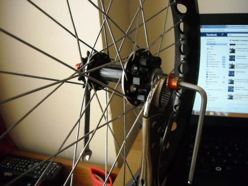

CalRobbo341 Posted June 5, 2012 Report Share Posted June 5, 2012 (edited) Just got a new frame in the post, has 110mm spaced dropouts so with the Echo TR hub, I have to use spacers. I had a quick go of fitting it earlier and the disc side bolt and washer has gotten stuck, I don't have a clue how.. How can I loosen it so I can make it work. I tried tightening the other one and then loosening the the stuck one, but that just seems to loosen the not stuck one. I am guessing the obvious answer is going to be put it in a vice? The one I have is in a certain position where I can't fit my wheel... Cheers! Edited June 5, 2012 by CalRobbo341 Quote Link to comment Share on other sites More sharing options...

isitafox Posted June 5, 2012 Report Share Posted June 5, 2012 More likely its got cross threaded or wasn't greased, all you can really do is clamp the axle with something like a vice or pair of mole grips and try to turn the bolt out. Quote Link to comment Share on other sites More sharing options...
CalRobbo341 Posted June 5, 2012 Author Report Share Posted June 5, 2012 I am guessing the obvious answer is going to be put it in a vice? The one I have is in a certain position where I can't fit my wheel... Just tried with some mole grips..nothing, gave it to my step-dad..nothing :/ Quote Link to comment Share on other sites More sharing options...
SamKidney Posted June 5, 2012 Report Share Posted June 5, 2012 (edited) tighten opposite bolt, undo stuck bolt a little, then the free one a little, then the stuck one and so on. A few of my hubs have done this. just make sure the threads are greased when everythings put back on. Is it in the frame or not? Edited June 5, 2012 by Echo Lite 09 Quote Link to comment Share on other sites More sharing options...
CalRobbo341 Posted June 5, 2012 Author Report Share Posted June 5, 2012 Tried that too, it just automatically undoe's the one that isn't stuck, if that makes sense? And no no it isn't. Quote Link to comment Share on other sites More sharing options...

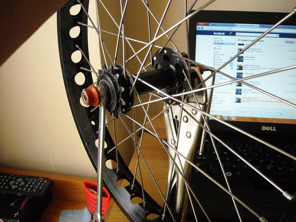

CalRobbo341 Posted June 6, 2012 Author Report Share Posted June 6, 2012 (edited) Had a go then, vice grips on the stuck side axel, 10mm cone spanner on the other, tighten the bolt up, give it some beans, voila! EDIT - Cheers guys! Edited June 6, 2012 by CalRobbo341 Quote Link to comment Share on other sites More sharing options...

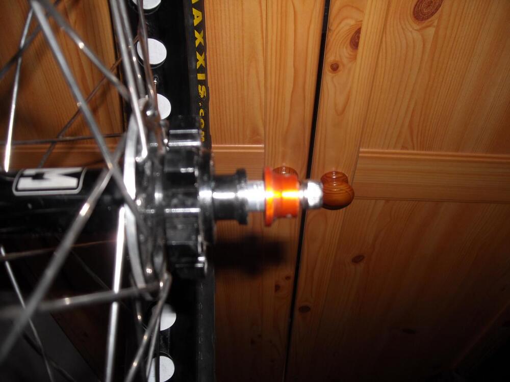

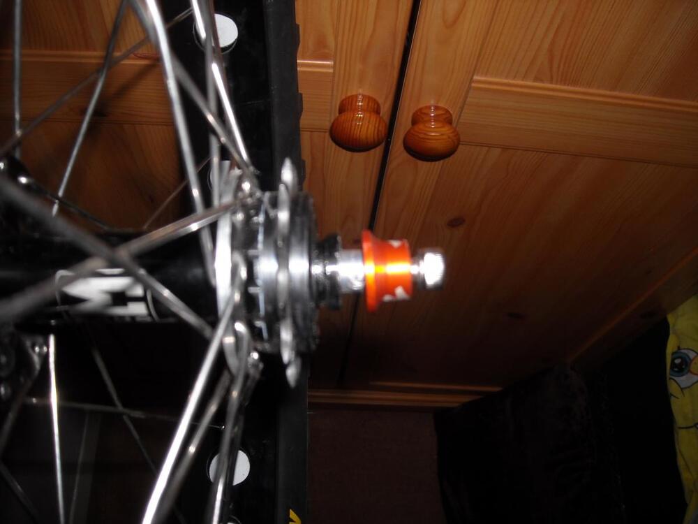

CalRobbo341 Posted June 6, 2012 Author Report Share Posted June 6, 2012 Also, could I run the hub with no spacers on the axel? Too many and it is stiff, rubs on the bearings which won't make the wheel turn. Too little and they just sit there, freely. And if I put 3mm worth on each side it just doesnt work out correct :/ And a few times when I do tighten the wheel into the frame, I have to do the process above ^^, cheers. Quote Link to comment Share on other sites More sharing options...
SamKidney Posted June 6, 2012 Report Share Posted June 6, 2012 Onza frame? You should only have to use the supplied washers. did the hub come with or without cams? Quote Link to comment Share on other sites More sharing options...
CalRobbo341 Posted June 6, 2012 Author Report Share Posted June 6, 2012 (edited) Without cams, these thick black washers? EDIT - Fitted the black washers, goes in the frame, perfectly! Should this fix the problem with tightening too? True life saver you are Sam! Edited June 6, 2012 by CalRobbo341 Quote Link to comment Share on other sites More sharing options...
SamKidney Posted June 6, 2012 Report Share Posted June 6, 2012 (edited) Yup, should only need the black washers. youll find that cutting off the raised outer lip on the washers means the hub will be a nicer fit in the frame. The washers are both 3mm wider to fit 2012 Echo frames without the need to use snail cams to space it out, which is why theyre no longer suplied with cams (echo use integrated tensioners). Shortening each washer by 3mm will mean your hub will be spaced at 110mm. If you ever change frames to 116, just add cams Thats what I did with my TR hub to make it fit my Ice 2 and ran flawlessly. Edited June 6, 2012 by Echo Lite 09 Quote Link to comment Share on other sites More sharing options...
