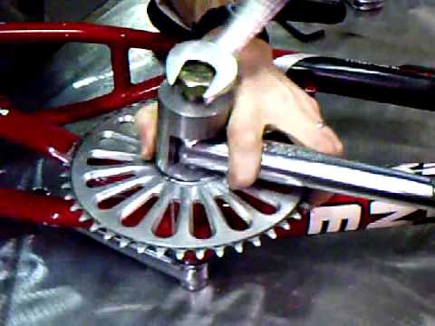

so ive decided to start riding again and bought a new frame and my profile cranks have been sitting around for a lot of years now anyway i bought the frame with them on so ive never actually taken them of before or put them on myself anyway the drive side is stuck but the other side came straight of do i need a crank pull to get it of or something or do i need to get the screw of holding it onto the sprocket or do they cone of together? also i have an idea that once i get the driveside arm of i can take out the axle and and assemble them to a euro bb or is the axle going to be stuck as well in need of a special tool? any help would be greatly appreciated thanks.
The sprocket and arm come off together, profiles are incredibly crude in that their "tool" is in essence a bolt you threadd into the bb axle, hold onto the crank arm, and twat top push the bottom bracket out of the axle ( as opposed to pulling the crank arm off the axle ).
There is an aftermarket puller that sits under the bulge in the crankarm and works like a traditional sq taper/isis puller . If youre handy in the workshop making one wouldn't be ridiculous :)
