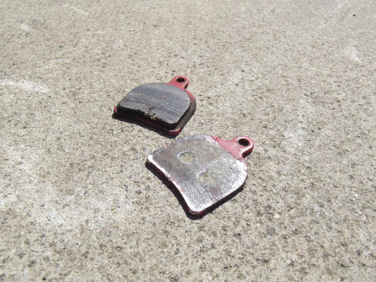

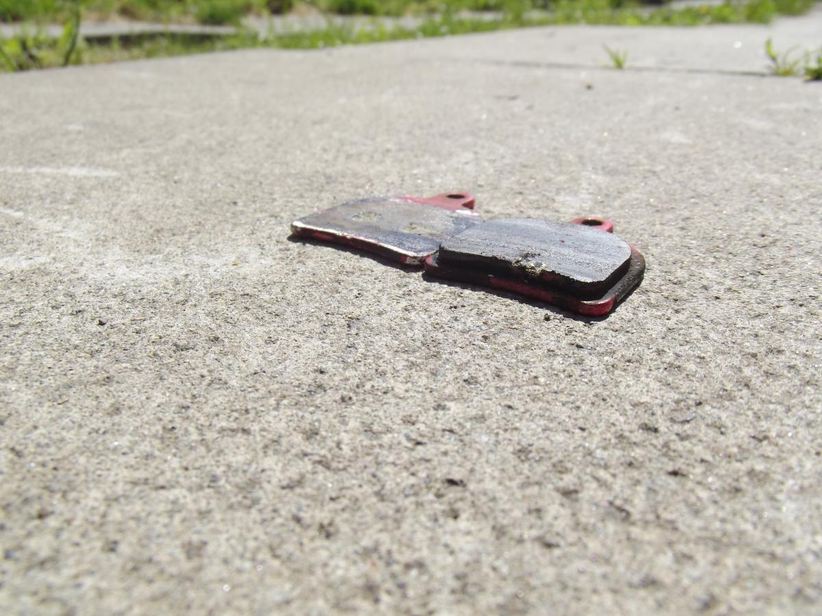

I haven't rode in like 2 weeks so my bike had been stuck in the garage.
I was out riding earlier today and my rear brake felt a little crappy, as in it wasn't holding like i used to.
One of my 'mates' thought it was a bright idea to pour Rockstar energy drink on it!
My brake started holding like hell then All of a sudden my brake locked up slightly then the lever pulled all the way to the bars and the brake didn't work at all, it felt like the brake had popped/leaked all the fluid out, so i checked it over and couldn't feel or see any fluid anywhere.
What could have happened.
Thanks for any advice.
Problem Solved.
post-28186-0-44653900-1338031325_thumb.jpost-28186-0-45414700-1338031349_thumb.jpost-28186-0-42341900-1338031366_thumb.j
Edited by bradjohnson
Has the TPA stripped it's thread ( unlikely but possible )
Undo the TPA all the way out ( not so the dust seal goes past the chamfered lip ) when you now squeeze the lever, do the pads move instantaneously or is there a dead bit of lever travel before the pads start moving?

I run the hope pro pads on the front, at the moment im using a borrowed Magura on the rear, im thinking of just selling the disc and buying a Magura.
Don't get me wrong i like the Echo Tr to be honest, its not leaking and I've put some more pads in it so its in working order, i just find the Maggie easier to maintain.
