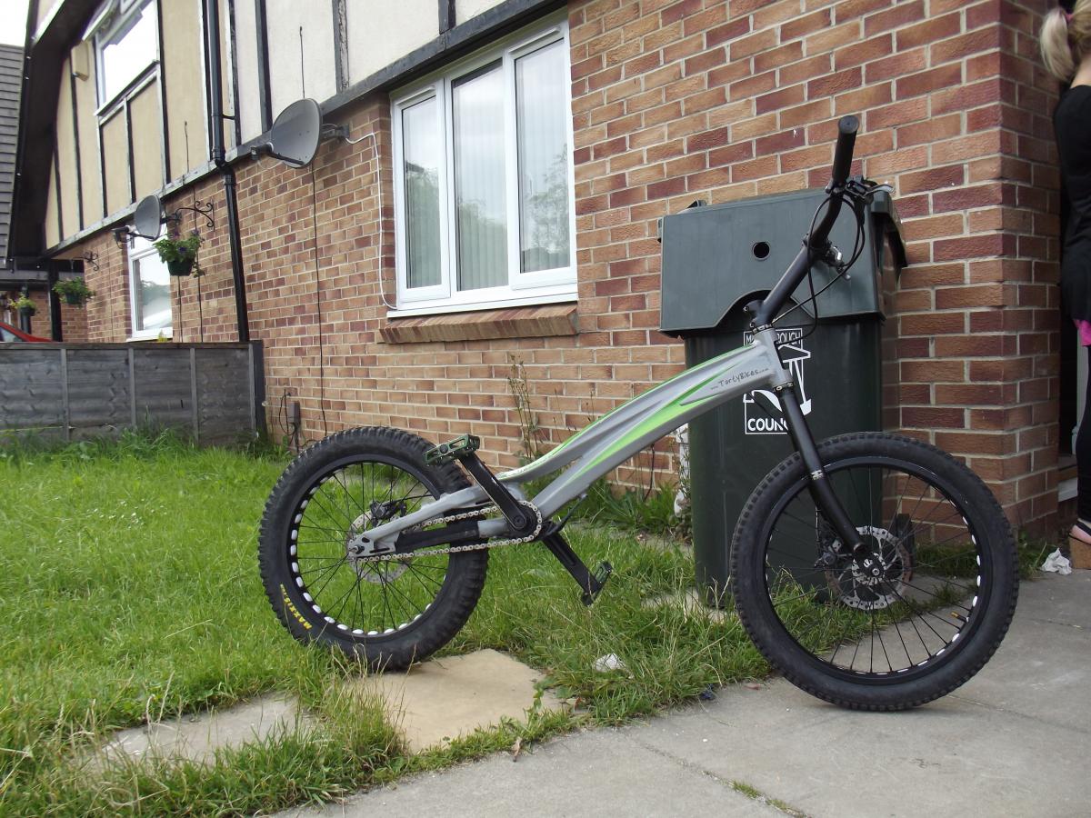

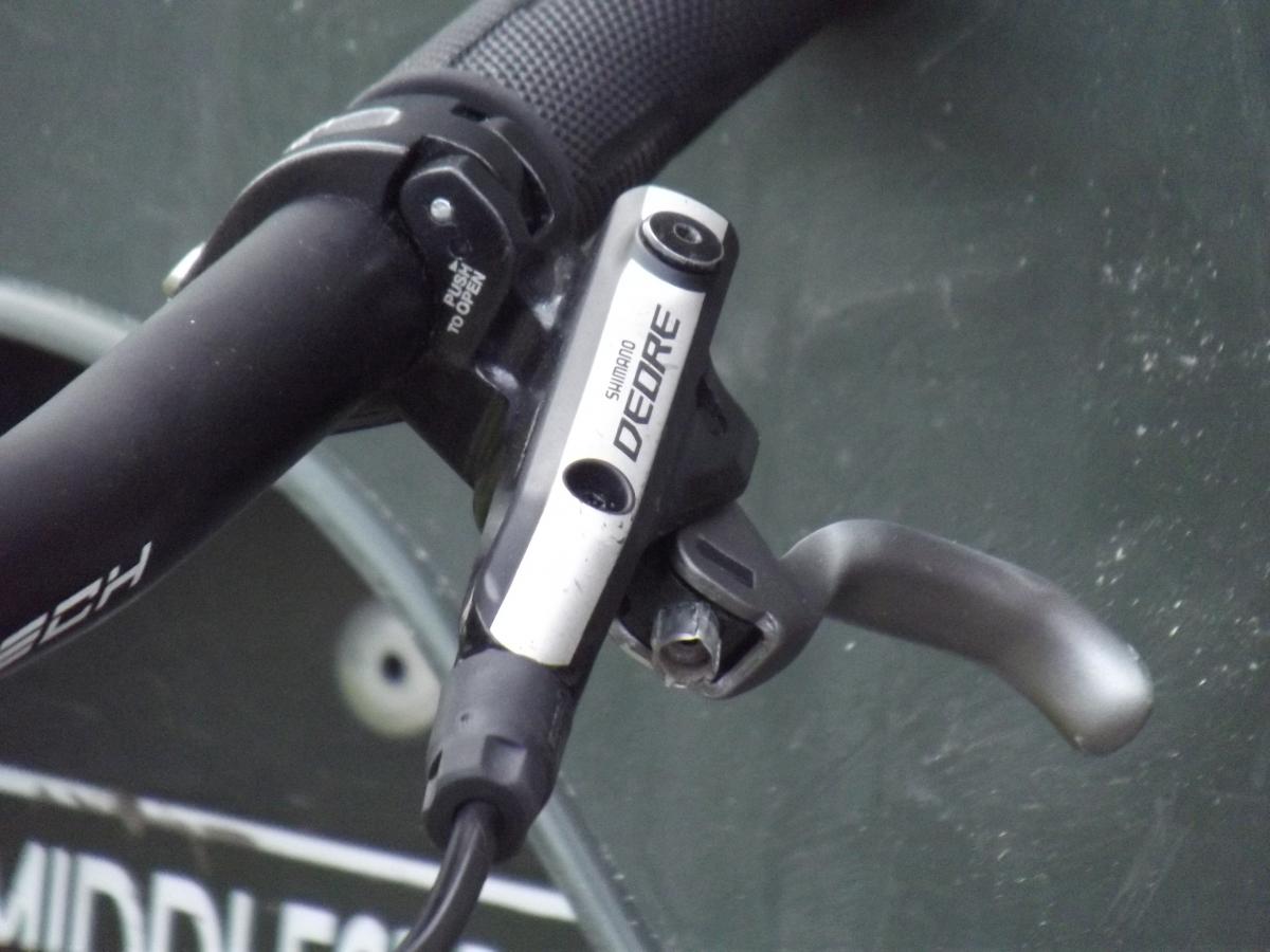

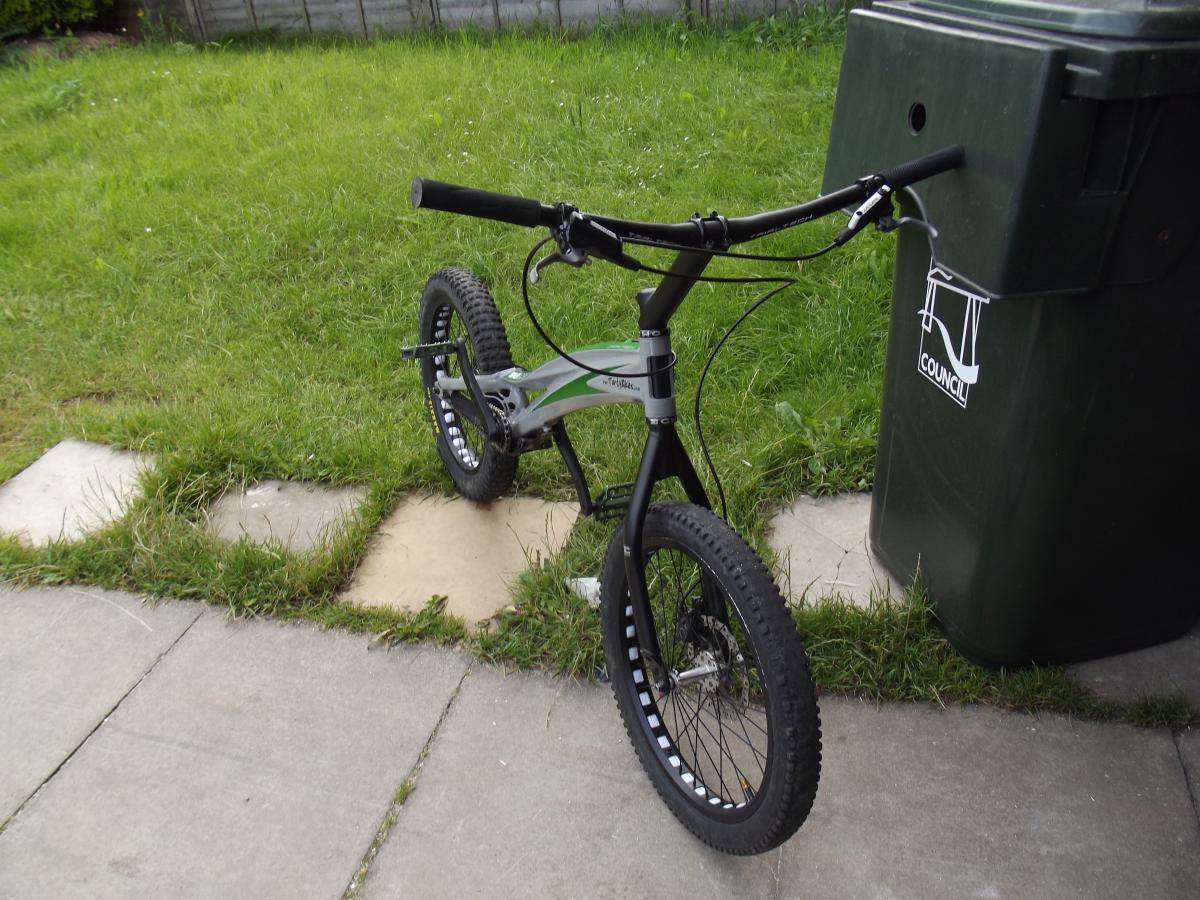

BradJohnson Posted May 25, 2012 Report Share Posted May 25, 2012 (edited) Here's my Limey 320 Currently weighs in at 9.2 Kg Spec: Frame & Forks... - Frame: Onza Limey 320 - Forks: Echo SL's Steering... - Stem: Onza High rise - Bars: trialtech sport risers - Headset: Echo SL - Grips: trialtech Wheels... - Front Wheel: TrialTech Rim Laced To A Because Disc Hub - Rear Wheel: Try-All hOle Rim Laced To An Echo Disc Hub - Tyres: creepy crawler 19" eagle claw 20" DriveTrain... - Bottom Bracket: Onza - Freewheel: Echo Sl 108 - Pedals: Onza Green - Echo Screw on Sprocket -trial tech cranks -TrialTech Kool Chain Brakes... - Duel shimano deore! -Gusset Front Rotor -V!Z Rear Rotor Edited July 19, 2012 by bradjohnson Quote Link to comment Share on other sites More sharing options...

Jake. Posted May 29, 2012 Report Share Posted May 29, 2012 Out of curiosity, why is there a chainstay protector on the forks? Quote Link to comment Share on other sites More sharing options...
TheLeroyHUK Posted May 29, 2012 Report Share Posted May 29, 2012 Protect them for failed side hops? Good idea to be honest Quote Link to comment Share on other sites More sharing options...
Jake. Posted May 29, 2012 Report Share Posted May 29, 2012 But if he's sidehopping that way, the chainstay protector he uses won't be of any use? Quote Link to comment Share on other sites More sharing options...
dann2707 Posted May 29, 2012 Report Share Posted May 29, 2012 What? How does that work JMCD lol Quote Link to comment Share on other sites More sharing options...
Jake. Posted May 29, 2012 Report Share Posted May 29, 2012 (edited) Well, he's got a chainstay protector on the left fork blade not on the right... When I do a sidehop and fail, it's the chainstay protector I bash, and the cranks, the forks get scratched. If the chainstay protector is on the side of the bike when he does a sidehop the chainstay will get scratches/dents but the fork won't be as badly damaged. Oh f**k, just remembered people use the chainstay protector to protect it from the chain rattle. I always thought of it as being there to protect from sidehops... Nevermind, hahaa. Sorry nice bike anyway. Might be getting a Limey myself soon. Edited May 29, 2012 by JMCD Quote Link to comment Share on other sites More sharing options...

BradJohnson Posted May 29, 2012 Author Report Share Posted May 29, 2012 Out of curiosity, why is there a chainstay protector on the forks? Protect them for failed side hops. This. Quote Link to comment Share on other sites More sharing options...
SamKidney Posted May 31, 2012 Report Share Posted May 31, 2012 How did you manage to run that hub in the limey frame with a disc? I tried with my Bros limey and the disc hits the frame, even with a spacer in there too. 1 Quote Link to comment Share on other sites More sharing options...
BradJohnson Posted May 31, 2012 Author Report Share Posted May 31, 2012 How did you manage to run that hub in the limey frame with a disc? I tried with my Bros limey and the disc hits the frame, even with a spacer in there too. Cut down the spacer and run the wheel slightly off center, add an extra spacer on the caliper it's self so it lines up with the disc, problem solved and no disc rub. Quote Link to comment Share on other sites More sharing options...

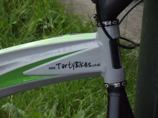

BradJohnson Posted June 12, 2012 Author Report Share Posted June 12, 2012 update Quote Link to comment Share on other sites More sharing options...
harmertrials Posted June 12, 2012 Report Share Posted June 12, 2012 maggie mounts and no maggie? Quote Link to comment Share on other sites More sharing options...
BradJohnson Posted June 12, 2012 Author Report Share Posted June 12, 2012 Put the discs on just for the picture, as i've sold them. So after the picture the maggie went on. New disc brakes are on there way though. Quote Link to comment Share on other sites More sharing options...

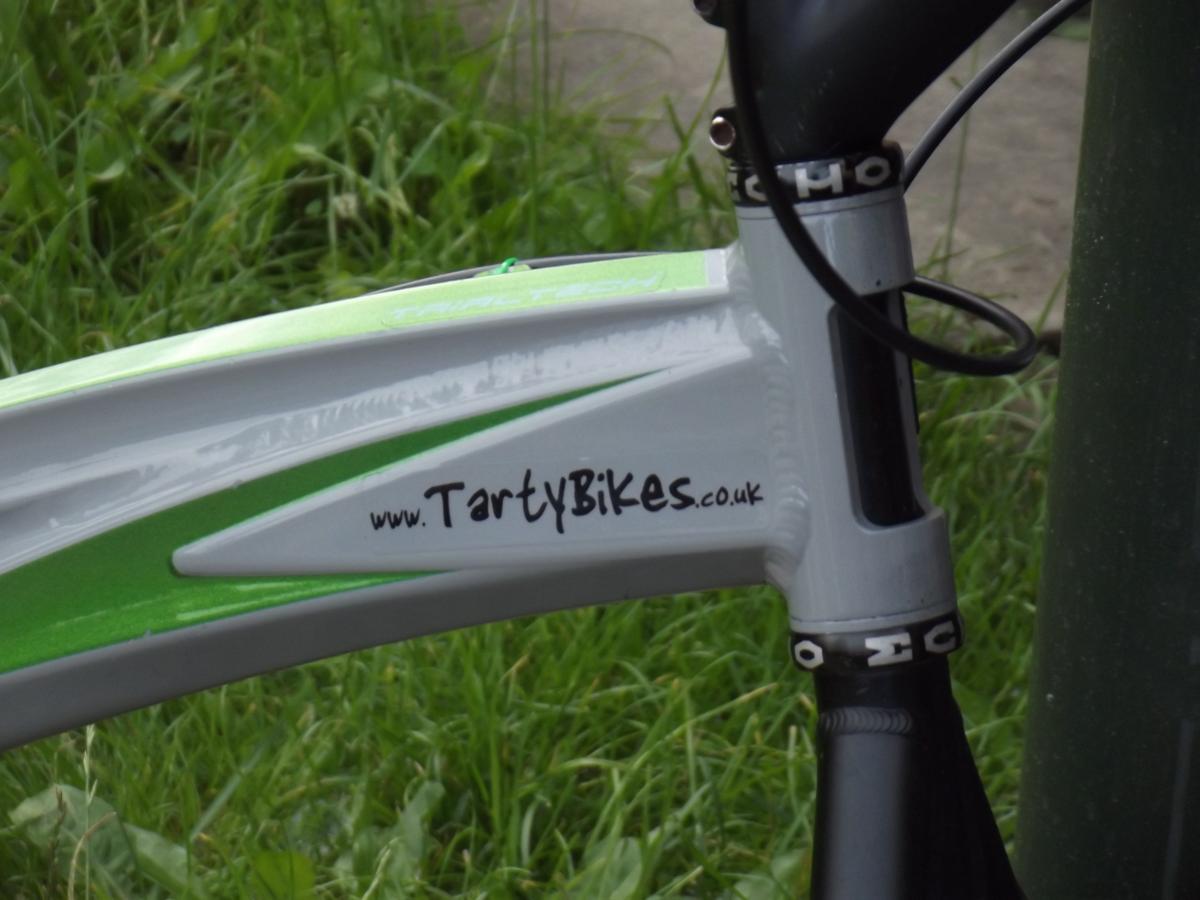

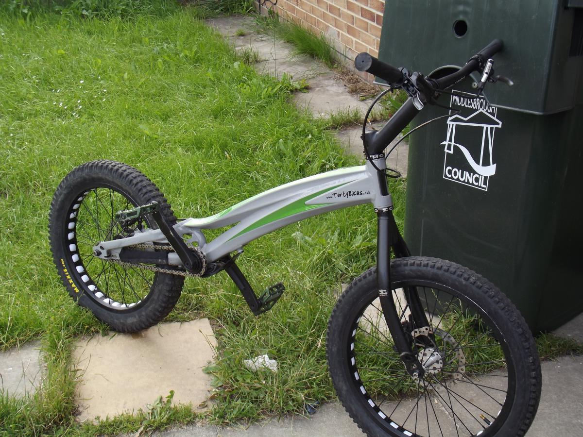

BradJohnson Posted June 18, 2012 Author Report Share Posted June 18, 2012 Update Quote Link to comment Share on other sites More sharing options...
Lewis Gething Posted June 18, 2012 Report Share Posted June 18, 2012 Nice bike and cool paint job. Still prefer the old gold Limeys but hey. How come it is 9.5kg? That seems heavy considering the build. Quote Link to comment Share on other sites More sharing options...
dann2707 Posted June 18, 2012 Report Share Posted June 18, 2012 Paint's added 1kg on 2 Quote Link to comment Share on other sites More sharing options...
harmertrials Posted June 18, 2012 Report Share Posted June 18, 2012 A kilo of paint Oo!! Strip the f**ker! Quote Link to comment Share on other sites More sharing options...

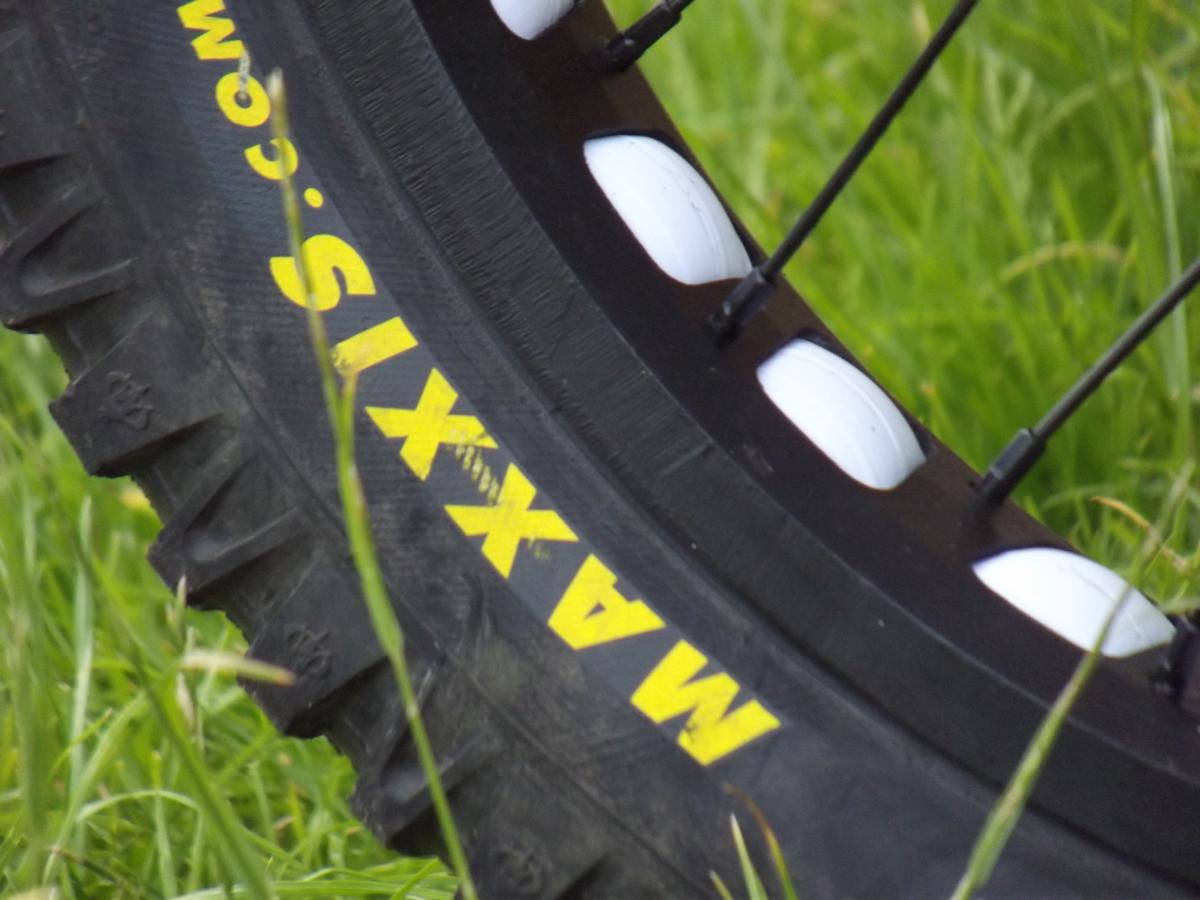

BradJohnson Posted June 23, 2012 Author Report Share Posted June 23, 2012 Sprayed the wheels! Quote Link to comment Share on other sites More sharing options...
liam_bremner Posted June 24, 2012 Report Share Posted June 24, 2012 Love that frame! 1 Quote Link to comment Share on other sites More sharing options...
BradJohnson Posted June 24, 2012 Author Report Share Posted June 24, 2012 Love that frame! Buy it. Quote Link to comment Share on other sites More sharing options...
