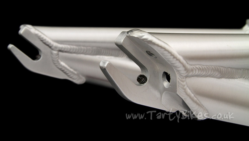

forteh Posted May 25, 2012 Report Share Posted May 25, 2012 Also bear in mind that 2mm difference in the cs length can make the difference between needing a tensioner or not. At 385mm cs I need a double wheel tensioner at 18:15, at 183mm cs you don't need a tensioner at all. I agree that a screw adjuster is the best solution; to date, dengs 2011 onwards integrated tensioners seem the best design IMHO. Quote Link to comment Share on other sites More sharing options...
AdamR28 Posted May 25, 2012 Report Share Posted May 25, 2012 I would guess that snail cams only move the axle by 0.75-1mm per notch. Continual adjustment by bolts is always better in my opinion. Actually the least coarse ones are about 0.3mm. The previous Echo TR ones were ~0.1mm. Something with a thread is definitely best. Quote Link to comment Share on other sites More sharing options...
zoster Posted May 25, 2012 Author Report Share Posted May 25, 2012 I agree that a screw adjuster is the best solution; to date, dengs 2011 onwards integrated tensioners seem the best design IMHO. this one? http://www.tartybikes.co.uk/images/custom/frames/large_trial20114.jpg Quote Link to comment Share on other sites More sharing options...
