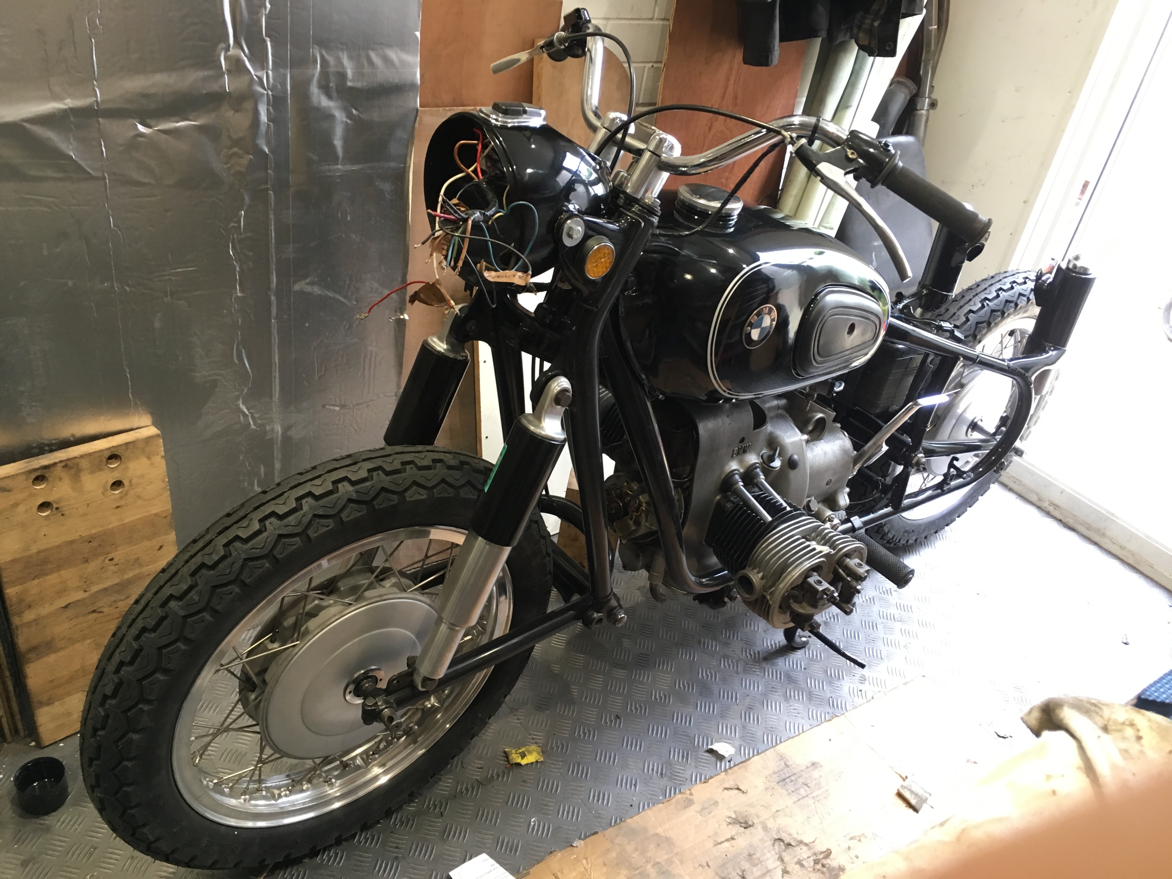

Herbertlemon102 Posted September 20, 2017 Report Share Posted September 20, 2017 (edited) Been helping my dad rebuild his '69 BMW R60/2. I've just been doing some of the heavy manual labour, everything on it is his work. When he bought it it was rusty and dented, he's refurbished and redone every single part of this bike. Wheel rebuilds, had one of the cylinders re-machined to original spec due to extensive damage, hes constantly ordering OEM parts over from Germany, it really is a work of art and I can't wait to see it running again. It's also one of the first shaft drive I believe? Edited September 20, 2017 by Herbertlemon102 3 Quote Link to comment Share on other sites More sharing options...
