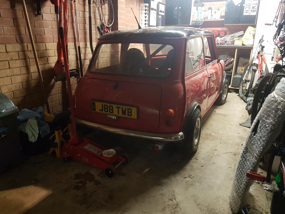

Tom Booth Posted September 28, 2018 Author Report Share Posted September 28, 2018 Haha nice. It crossed my mind to rebuild mine with a b16 this time round, but I just want to get it going for now with no real hard work so just a slight rebuild will do me. Cleared the garage last night as it was buried after 2 years of housework and generally living. Still need to sort my cupboards out down the bottom and get stuff in there but for now it's workable. 3 Quote Link to comment Share on other sites More sharing options...

Tom Booth Posted May 27, 2019 Author Report Share Posted May 27, 2019 On 9/28/2018 at 8:11 AM, Tom Booth said: Haha nice. It crossed my mind to rebuild mine with a b16 this time round, but I just want to get it going for now with no real hard work so just a slight rebuild will do me. Cleared the garage last night as it was buried after 2 years of housework and generally living. Still need to sort my cupboards out down the bottom and get stuff in there but for now it's workable. So... garage sorted at last and the mini has a huge stash of parts ready to go. Really got the bug now. Really want a colour change and while it's in the state it's in its prime for it, I have the colour too but dunno if I can be arsed 1 Quote Link to comment Share on other sites More sharing options...
