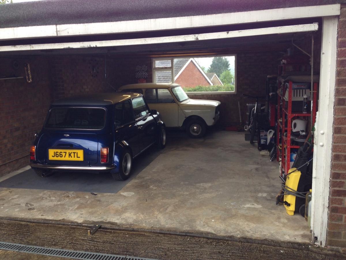

Danny Posted May 30, 2013 Report Share Posted May 30, 2013 The main thing is get a solid shell. Then just bolt on whatever you like. My clubman came home at the weekend (it's been in various other peoples garages for the past few years) Ive just got to crack on with it now. Quote Link to comment Share on other sites More sharing options...
