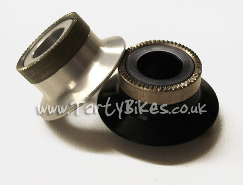

cai Posted May 19, 2012 Author Report Share Posted May 19, 2012 If it only does it when you tighten stuff up, then it's basically going to be either a bearing (which sounds like they're all fine?) or spacer/washer problem. I'd imagine it'd be the latter leading to the former Cheers for the reply Mark. I'll take the hub apart again tonight in hope of narrowing this down. Just to clarify, it'll potentially be a fault with either the 12mm spacer or 1mm spacer: Or it'll be a fault with the drive side end cap: Otherwise It'll be a bearing letting me down, correct? Quote Link to comment Share on other sites More sharing options...
Mark W Posted May 19, 2012 Report Share Posted May 19, 2012 I'd assume so, yeah. Quote Link to comment Share on other sites More sharing options...

cai Posted May 20, 2012 Author Report Share Posted May 20, 2012 The 2mm spacer measured in at 2mm so no problems there. I couldn't get the 12mm spacer out (without causing damage to it) to measure it, but it doesn't look worn. This leads me to believe its the drive side end cap at fault, again it doesn't look worn, but the 'lip' on the inner face that presses up against the free hub body looks to be very small. Perhaps the whole face of the end cap is touching the free hub body bearing when everything is tightened up fully, not just the lip of the end cap, causing the stiffness? I'm going to try a small spacer in there if I can source one of the correct size and see if that helps, if it does then I'll buy a new end cap. If it doesn't then I'll be left scratching my head at which bearing is at fault Quote Link to comment Share on other sites More sharing options...
