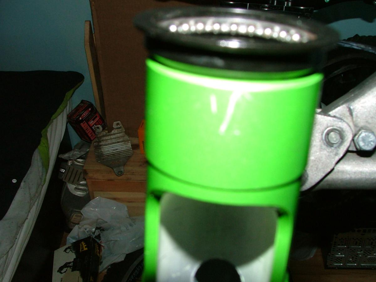

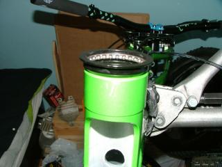

post-30858-0-45956500-1337369163_thumb.j
post-30858-0-20017500-1337369260_thumb.j
In that first image it looks like the headset cup is in your frame?
Yeah on the pic it looked like that but it's not! The part of a headset that should be "inside the frame" (look at the highlighted area on the pic, just a random pic from google btw) the outer diameter of that part of the headset has the same diameter as the outer diameter as my frame, I hope this makes sence, So I suppose I need a smaller Headset but which size?
If you'd be able to get a clearer photo of the cup in/on the frame that'd be handy, I can't really make out any detail in that one. From that pic it looks like it's part of the way in, unless that's an incredibly shallow cup? Are you definitely using a standard 1 1/8" headset, NOT an internal headset?

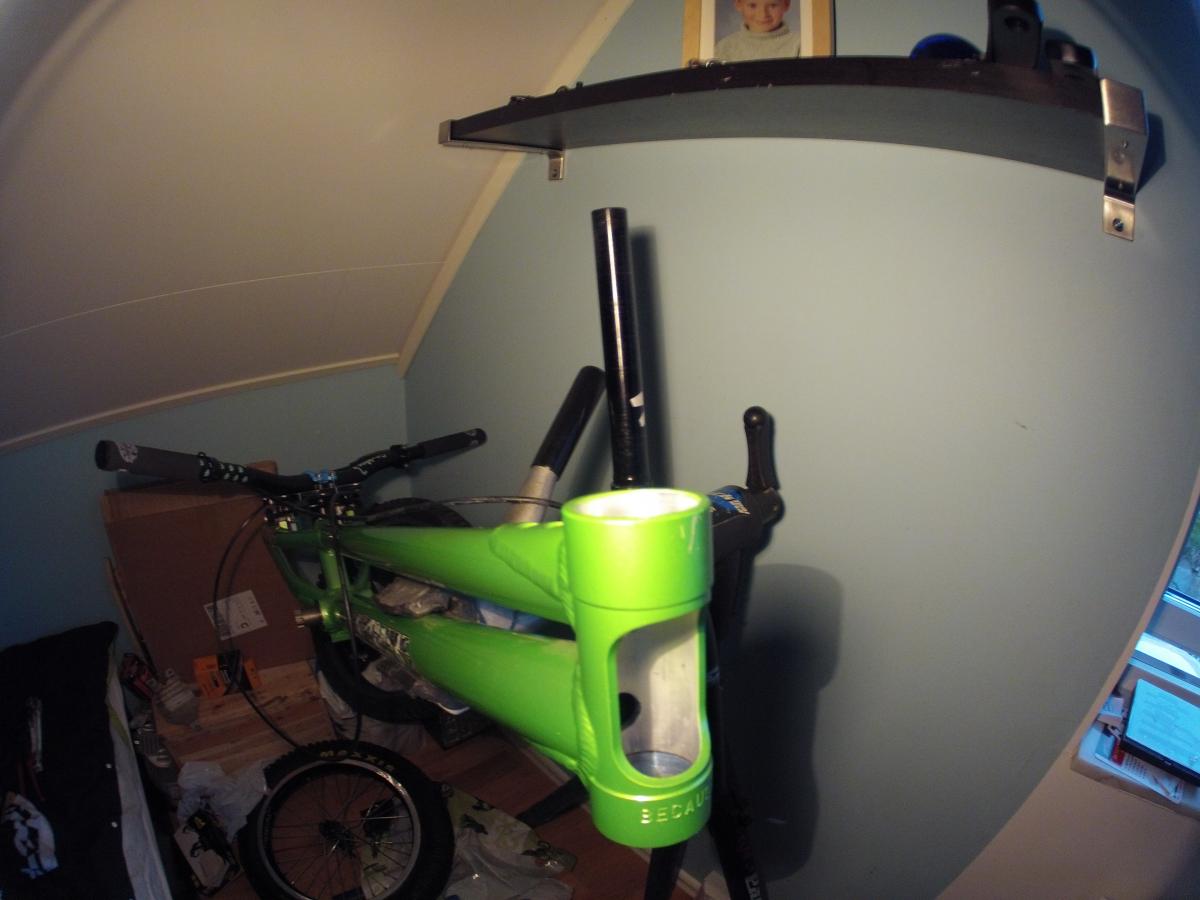

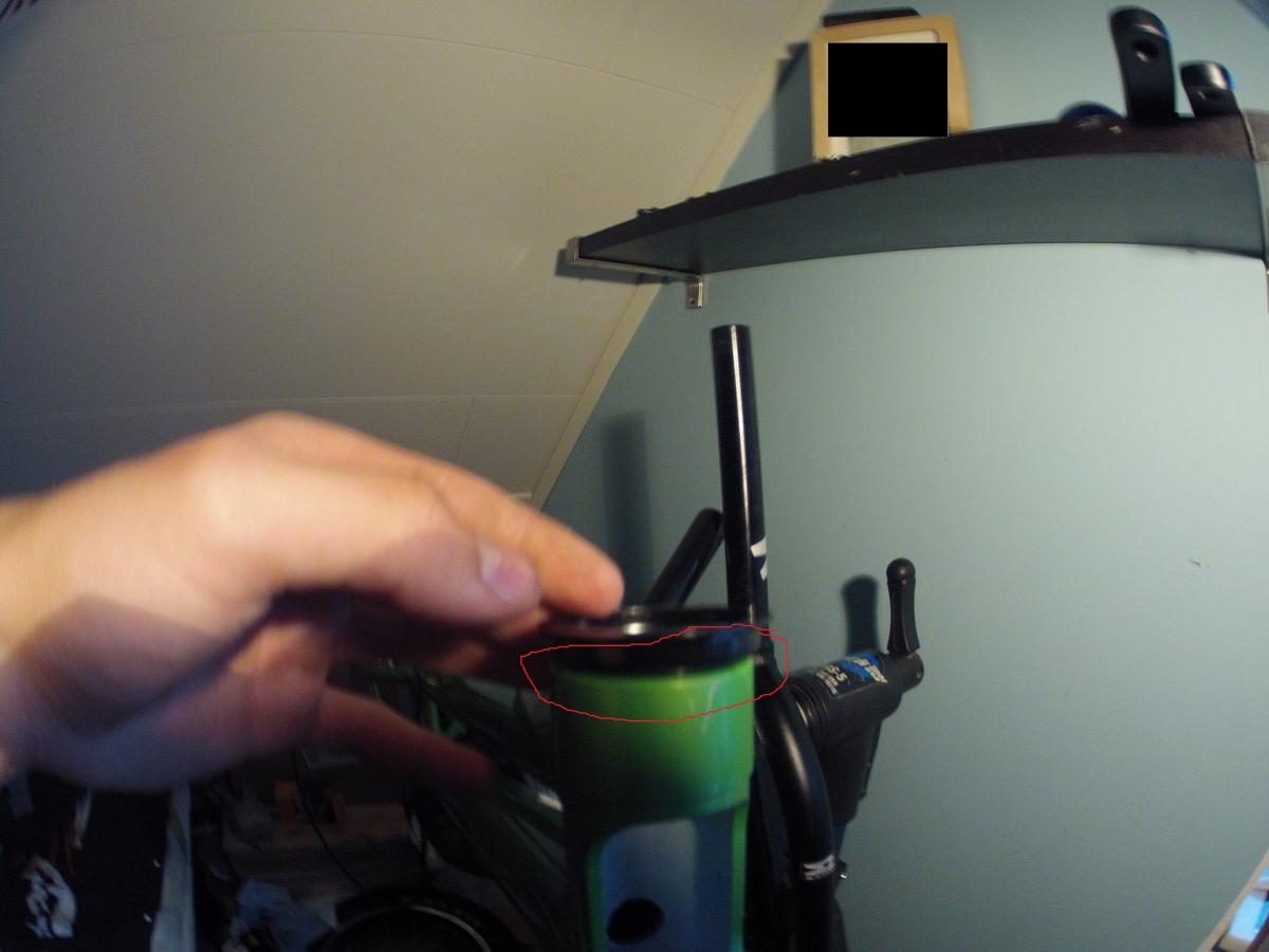

look at the photos i attched, but it is a 1 1/8" headset. I've tried to different FSA headset both labeled 1-1/8... I suppose that they are 'normal' not internal headsets...
post-30858-0-55961300-1337370839_thumb.j
post-30858-0-80522700-1337370854_thumb.j
Deffo wrong headset!
Really? F**k I feel ashamed... I've tried 2 different ones, and they doesn't fit. Thanks for your help guys!
EDIT: When I asked my dad about it now he said that they where racer bike headsets... So the fault wasn't really mine, his worker told me that this one would fit so I chose them for my bike. And nono of them fit, and now I know why.. hahaha :giggle:
