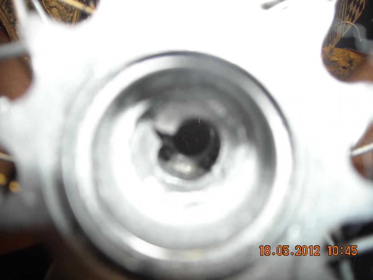

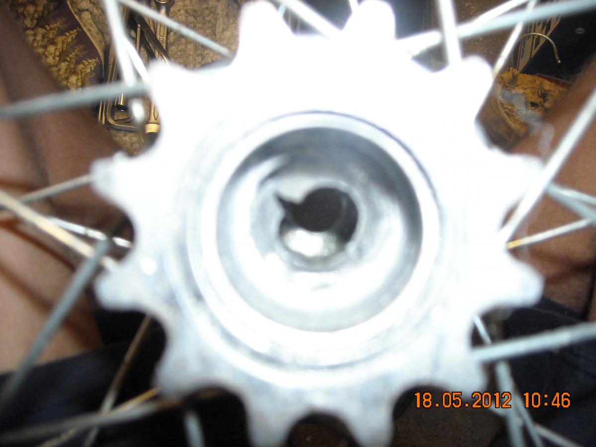

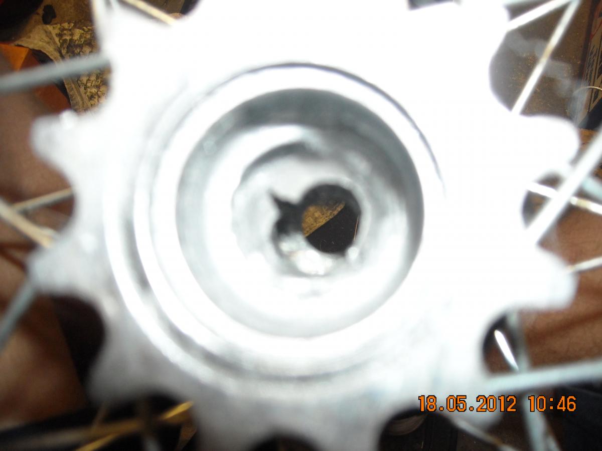

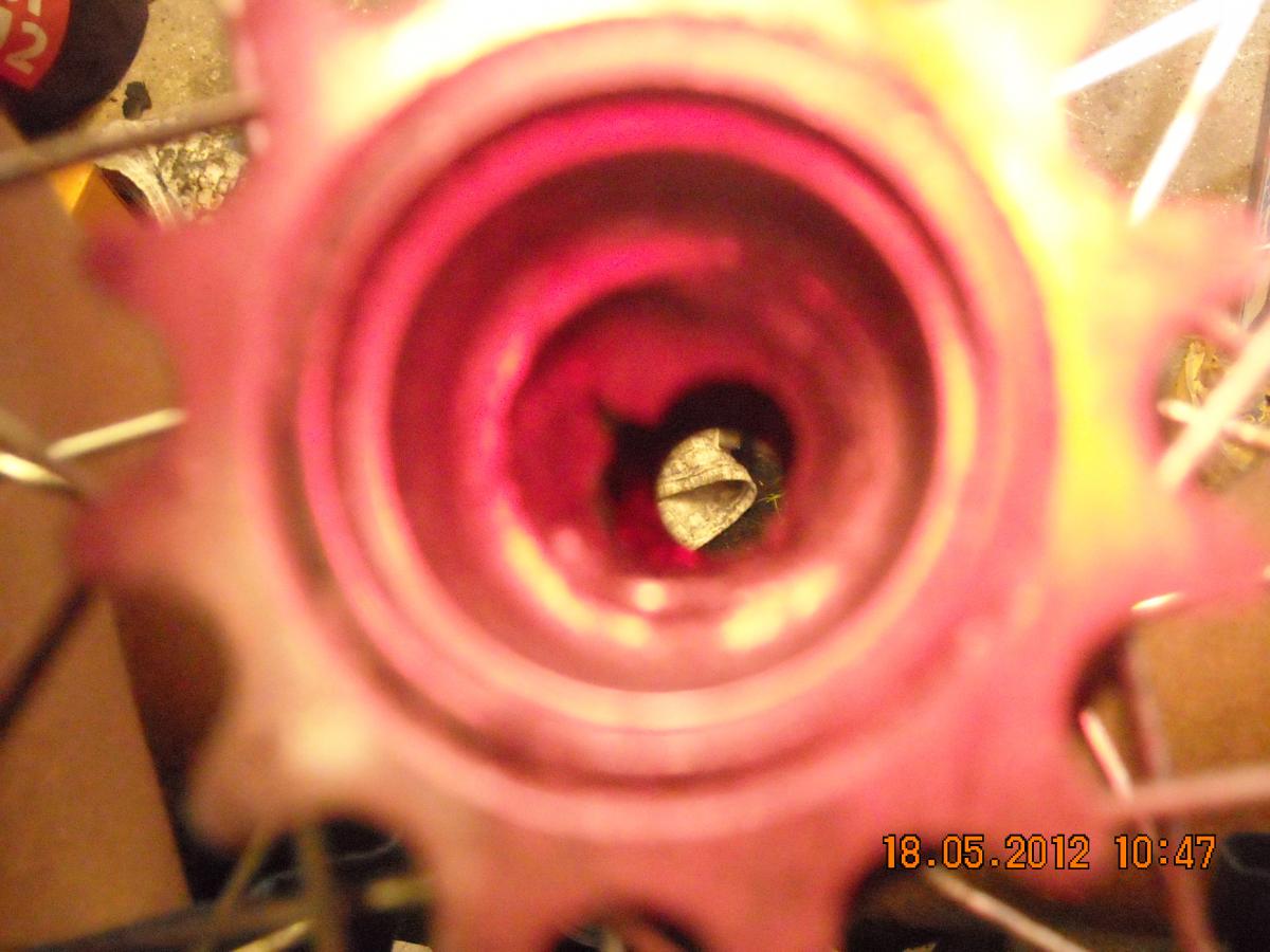

CalRobbo341 Posted May 18, 2012 Report Share Posted May 18, 2012 So I have had this rear wheel for about 3 years now buckled to sh*t, I have had to adjust the bearings alot in the past month as they are knackerd, just have to tighten it up so they stay in and grease it all just so I can roll around! Yesterday I decided to take the whole thing apart and I only found 3 ball bearings in the cog side of the hub and after taking it all apart I find the rest of them, I'm guessing there is 18 ball bearing in total? And I just want to know, does this look kind of well, broken? I'm guessing thats where all of the bearings were hidden? So is it time to just give up on that rear wheel, before it somehow explodes? Some pictures, sorry for quality, hard to get a good picture... Quote Link to comment Share on other sites More sharing options...
monkeyseemonkeydo Posted May 18, 2012 Report Share Posted May 18, 2012 The word you're looking for is 'f**ked' . For whatever the reason the bearings have found their way out so that the axle hasn't been supported centrally in the hub. That distorted, elongated hole should be circular but the axle has been able to move around and eat into the hub. SO yeah, basically it's dead as a very dead thing. Quote Link to comment Share on other sites More sharing options...

dann2707 Posted May 18, 2012 Report Share Posted May 18, 2012 Looks mangled to cheese! btw you have a macro button on your digital cam for things like this, be able to see it better lol !! Go to a sealed bearing hub and never look back. 1 Quote Link to comment Share on other sites More sharing options...

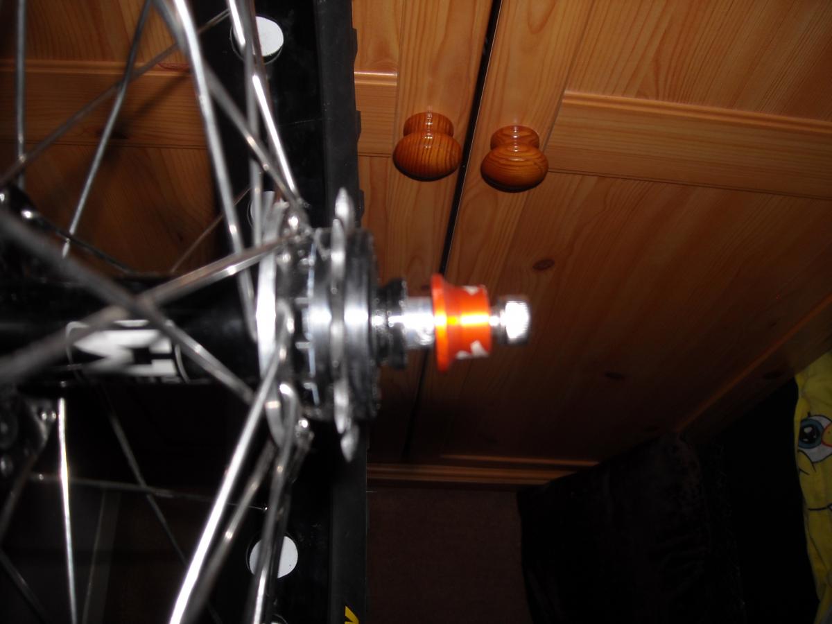

Mark W Posted May 18, 2012 Report Share Posted May 18, 2012 If it's a pre-built TR wheel then theoretically it'd be the 116mm spaced one including snail cams? If it is, you can just take the snail cams off and it'll be 110mm spaced. You may need to run the cams on the outside of your frame if the axle overhangs the outside edge of your dropouts, but that's not the end of the world. Quote Link to comment Share on other sites More sharing options...
CalRobbo341 Posted May 18, 2012 Author Report Share Posted May 18, 2012 Nope...it has no cams, it doesnt slide all the way up to where I need it (onza's own chain tensioning stuff) And I don't want to file anything down or damage anything just in case. Quote Link to comment Share on other sites More sharing options...
Mark W Posted May 18, 2012 Report Share Posted May 18, 2012 All you really need are some M10 washers though, which you can pick up from hardware shops/places like B&Q. Just measure the width of the ones on your hub now, -3mm and get hunting Quote Link to comment Share on other sites More sharing options...
CalRobbo341 Posted May 18, 2012 Author Report Share Posted May 18, 2012 I have some, well millions and there arent any washers on my hub atm though? Quote Link to comment Share on other sites More sharing options...
Mark W Posted May 18, 2012 Report Share Posted May 18, 2012 ...there should be, haha. Quote Link to comment Share on other sites More sharing options...

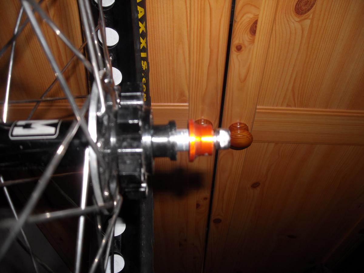

CalRobbo341 Posted May 18, 2012 Author Report Share Posted May 18, 2012 Here you' go! Quote Link to comment Share on other sites More sharing options...
Mark W Posted May 18, 2012 Report Share Posted May 18, 2012 Yeah, I meant the black spacers on your axle Just measure them and take off 3mm to work out what length you need. Quote Link to comment Share on other sites More sharing options...
CalRobbo341 Posted May 18, 2012 Author Report Share Posted May 18, 2012 Bit blonde when it comes to things like this, I can take the one on the disc side but not the cogged side, you then want me to file them down by 3 mm? Quote Link to comment Share on other sites More sharing options...
Mark W Posted May 18, 2012 Report Share Posted May 18, 2012 You don't have to file them down, you can just go and buy some more suitably sized ones from somewhere like B&Q or any other sort of hardware shop. Quote Link to comment Share on other sites More sharing options...

CalRobbo341 Posted May 18, 2012 Author Report Share Posted May 18, 2012 Yeah fitted my washers and it fits fine, but it wont slide back to where I want / need it, I don't know if I should put a bit of force onto it? Quote Link to comment Share on other sites More sharing options...
Mark W Posted May 18, 2012 Report Share Posted May 18, 2012 By "slide back" do you mean further/deeper into the frame so it's nearer your BB? I'm guessing you've wound off the integrated tensioners in your frame too... Quote Link to comment Share on other sites More sharing options...
