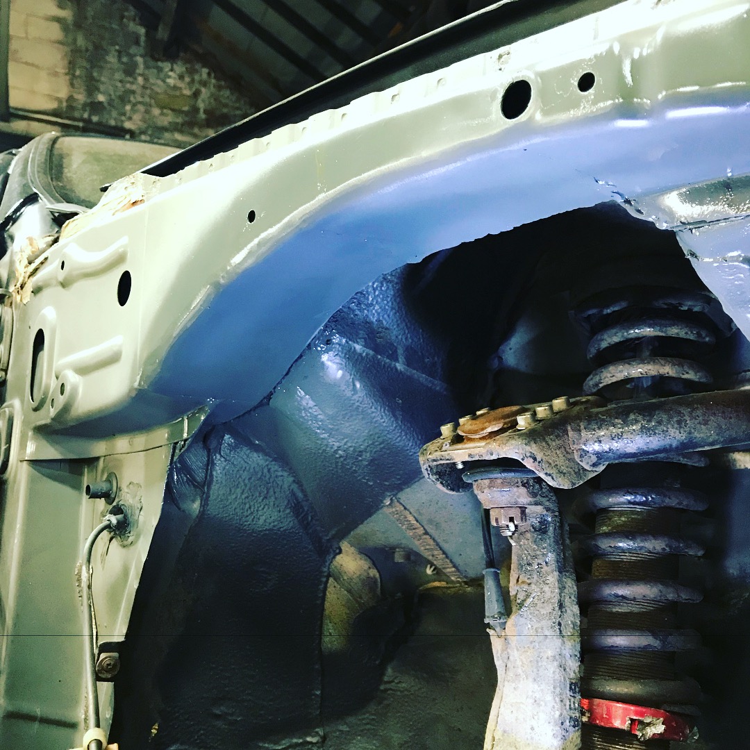

SamKidney Posted February 16, 2018 Report Share Posted February 16, 2018 Found some rust, did some cutting, did some welding, happy with result. 1 Quote Link to comment Share on other sites More sharing options...

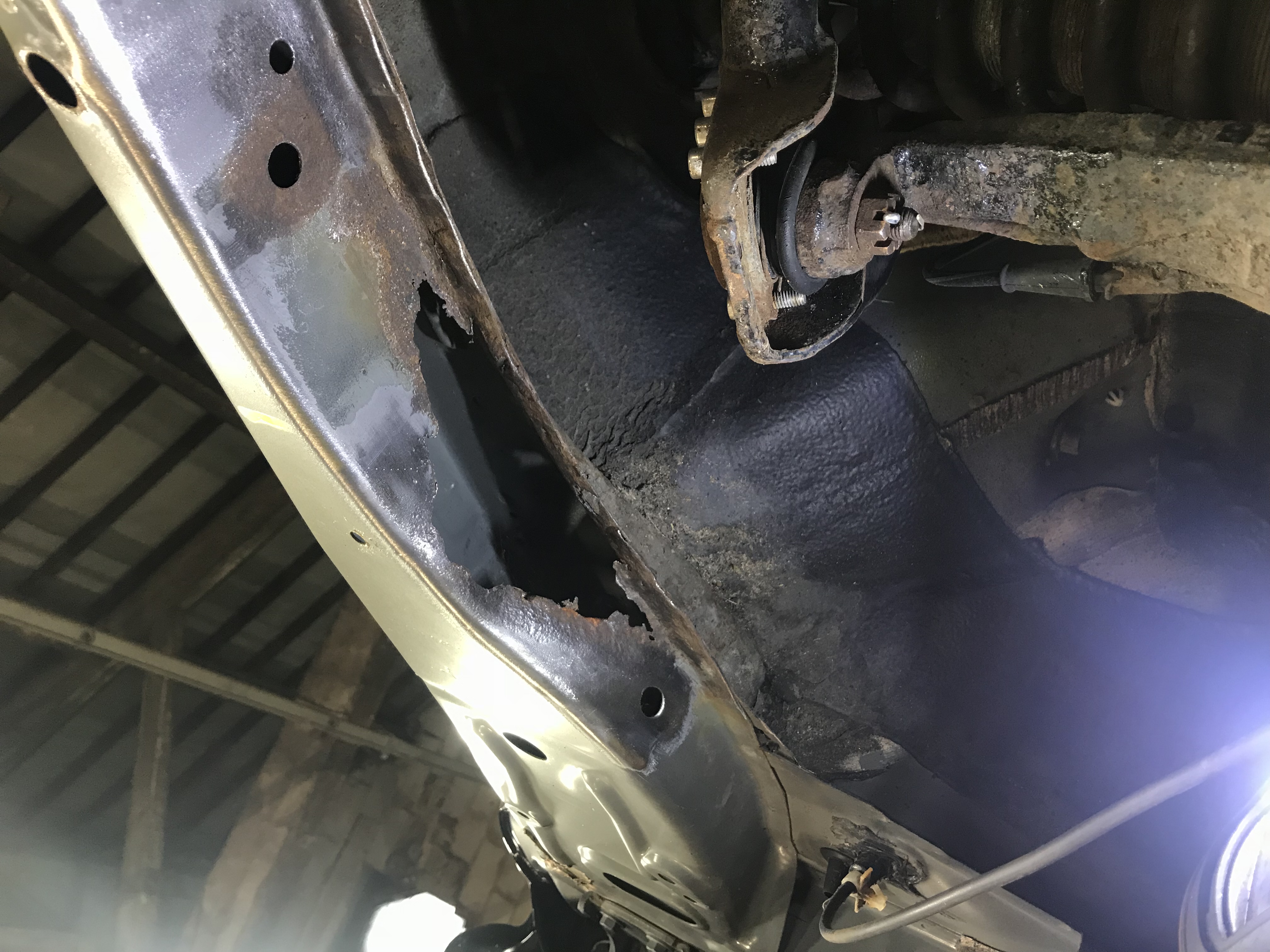

Alex Dark Posted February 17, 2018 Report Share Posted February 17, 2018 Had a fun distraction in the form of every bolt for my disc shields / abs sensors in the front hub snapping. Cue some inventive fixturing, a couple of carbide endmills and an m8 tap and I had all the threads recovered. Started the job of cutting the old rails out to see what I was working with. Used the drivers side that hadn't been previously repaired. Turns out the rail had blown out so far it was unreal. You can see on the side where its rotted right the way through. Picked up some box section £11 for both sides, over length by 100mm! Chopped one to size and did a trial fit. Unfortunately when speccing the box section I measured it at 90mm on the width ( I'd measured a section that was blown out clearly ) so cut 85mm up from the bottom. When I remeasured the internal width and added the wall thickness I realized it was actually only 80mm square! Leaving me with a small gap at the top to fill What a bellend. I decided to take out the maximum amount of material easily possible, and went from the very edge of the subframe mounting plate ( So I could weld into this thicker circa 6mm material ) right along to the gusset that reinforces the slam bar at the front ( cut off the spot welded tabs and welded directly onto this ) Rail length was around 570mm each side. Drilled all the holes on both pieces of box on a mill at work using the old rails as a guide; remembering of course that the passengers is the mirror image of the drivers +/- a few mounting holes. I needed to shape the box into more of a Vee shape, so chopped the top and used a car jack to widen the top width ( |__| to \__/ ) Rot inside the passenger side. Chopped the passenger and found an even more delightful sight, with some lovely previous repairs. Proper abortion of a repair, plates and angle iron here there and everywhere with the ARB bracket welded on every face possible Out with the old and in with the new. Originally planned on replicating all the holes, bolting nuts to the inside and welding these into position. Got convinced to give rivnuts a try and can say I'm converted ! They look super clean. After welding the OEM brackets back, and drilling the ARB brackets to accept the larger rivnuts it all looks proper. Got busy with the melty stick: Smoothed all the welds off ready for paint with a 40grit flap wheel. 4 Quote Link to comment Share on other sites More sharing options...
